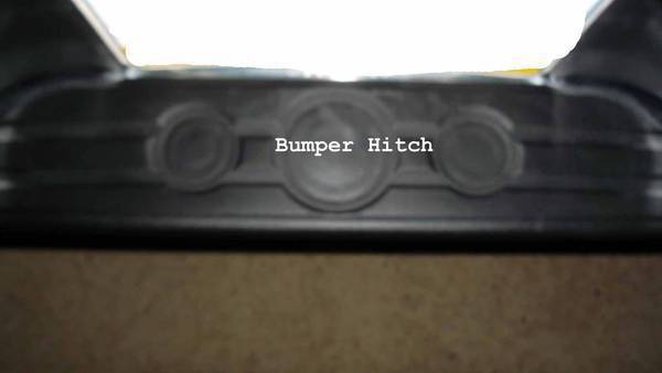

    It looks like my bumper is the same material as the frame and attached to the frame.
    Does this make the bumper hitch as strong as a frame hitch?
    In other words, can I just buy a hitch ball and screw it into the bumper or should I install a frame hitch?
    Thanks

    Frame hitch, bumper hitch= pull something to heavy and your bumper will bend

    Bumper is rated for 3500lbs but would never approach that weight with it. If you have the towing package frame hitch is good for 6500lbs. Sounds like you don't have the tow package so 3500lbs is your stock limit anyways but a frame hitch is cheap and very easy to install. Get the frame hitch.

    Bumpers are only for towing very light loads in my opinion. IE: 14' aluminum boat with a electric trolling motor.

    You can do it but a few cautions:
    --Do not try to back the trailer unless you are very adept--it is likely that when the trailer gets sideways you will be marring the hell out of your bumper.
    --Start out s-l-o-w-l-y and stop the same way. (I realize that the second one is not always in your control)
    --Keep your speed down and your trailer well balanced. If you look you will see that the bumper mounting tabs are MUCH less substantial than the frame or a commercial receiver (frame-mounted hitch). This means side to side sway is an even bigger problem with the bumper than it is with the hitch.
    --Lock your trailer hitch to the ball using a bolt or an actual lock through the hole. Even if you have a decent place to hook your safety chains ( a problem with bumper balls) you will likely jerk your bumper off (and not in a good way) if that sucker comes loose.

    I tow a small 1000 pound trailer once a year off the bumper. 450 miles round trip. Trailer has electric brakes and I have a brake controller. I have had no problems. I am actually surprised by how stout the bumper looked.
    With the wide plate portion of the bumper, you can be at about 75 degrees before you hit the bumper.
    Hardest part of bumper towing is finding suitable place to attach safety chains. I ended up getting some hooks from McMcaster Carr and attaching to the holes either side of the ball hole.
