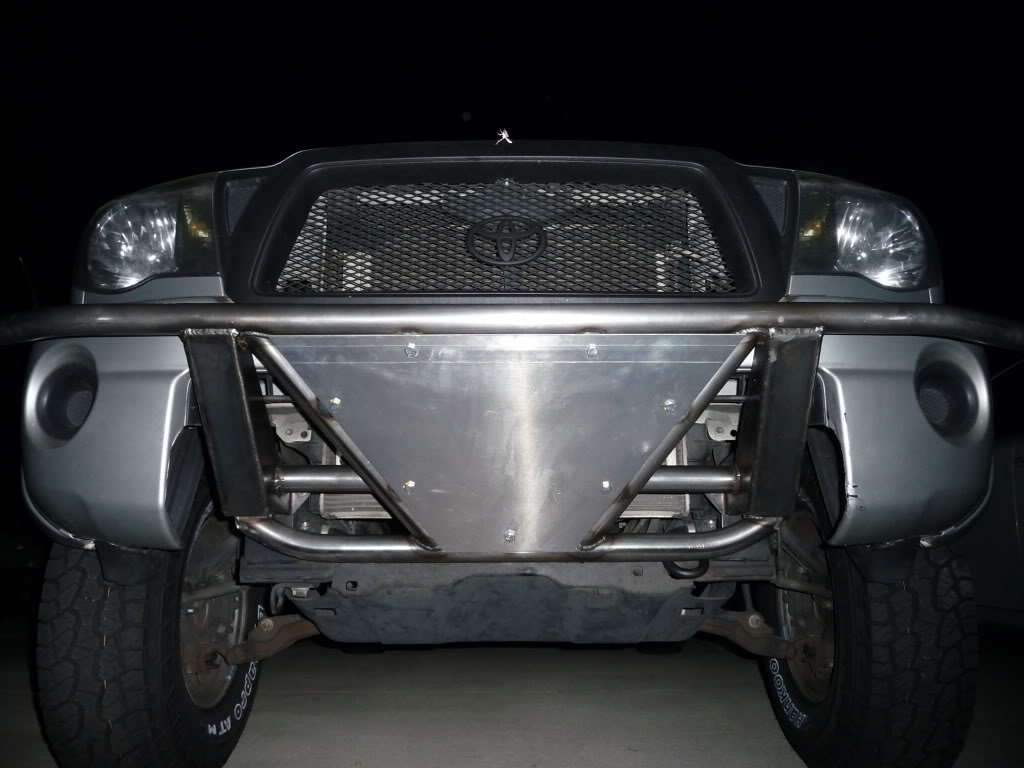

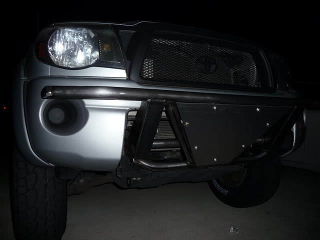

    WOOT action shots.

    damn...thats looking tough bud...Nice job!

    andre does amazing work and i've experienced his products first hand. I dont know if he is planning on producing this bumper for sale later on but if he does, i wouldnt hesitate to jump on it

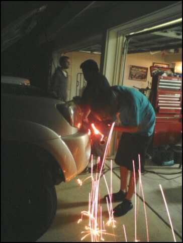

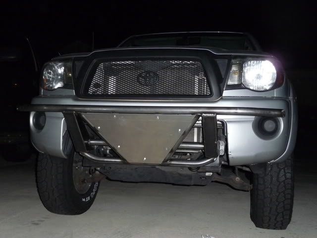

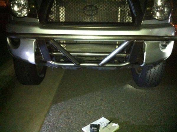

    Thanks guys, This one I got to credit my buddy Ryan in it, he is the welder on this project. I did the CNC and design.

    Is this tube bumper meant to be general protection for the stock bumper , or are you adding lights ?

    Lights will be added.

    Thanks ! Looks great :thumbsup:

    :eek: Would not want to brake check that.

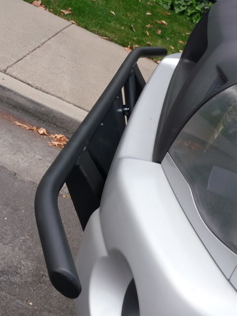

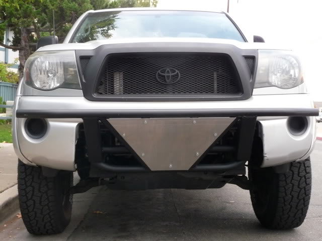

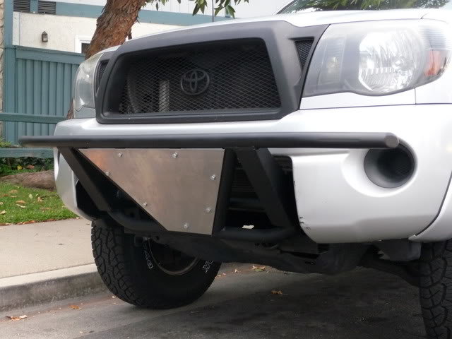

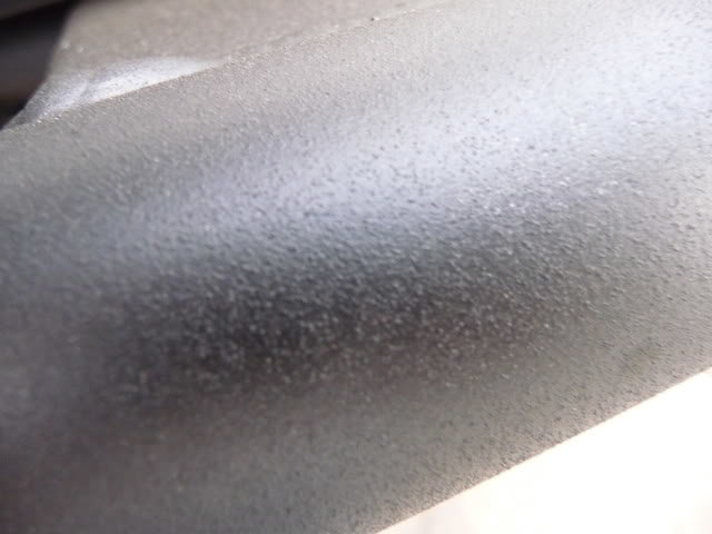

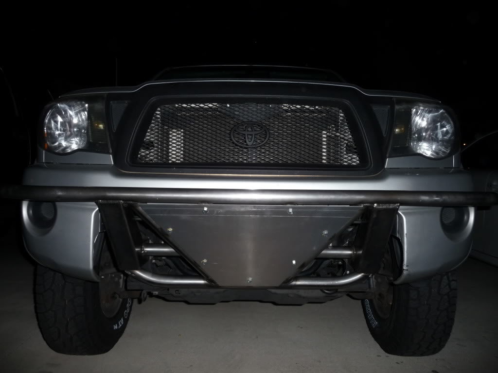

    Painted with some day shots.
    I prepped and primered(raw metal primer) then hit it with 2 light coats of rustoleom bedliner and 1 light coat of semi gloss black.
    Not quite done yet. Still need mounts for lights, All-pro skids, and new suspension because of the major sag in the front. But all in all, I'm very happy with the outcome.
