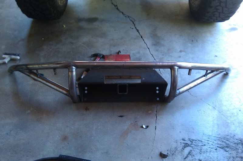

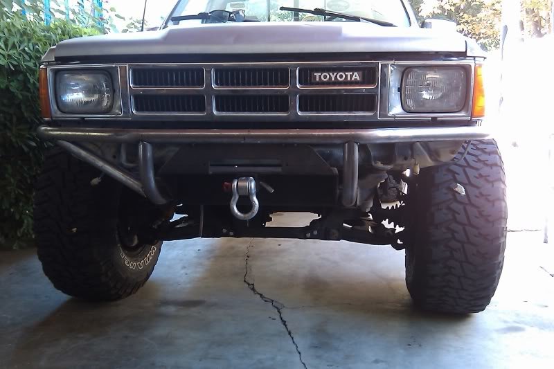

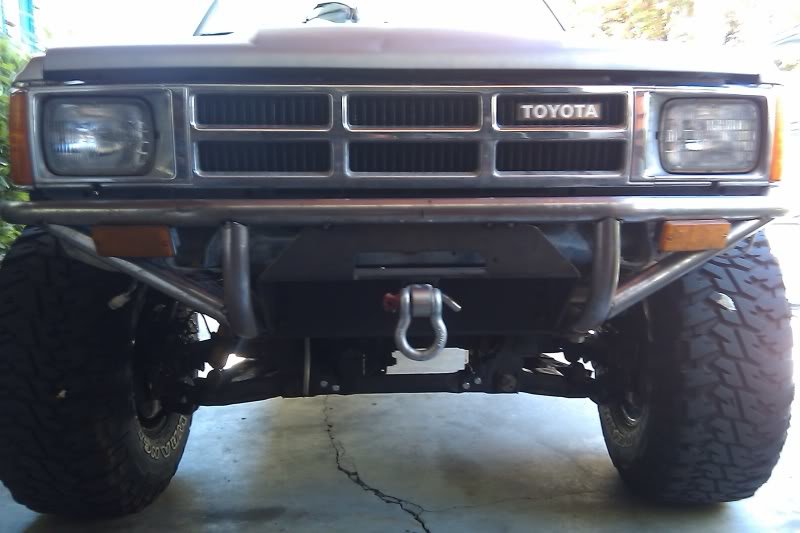

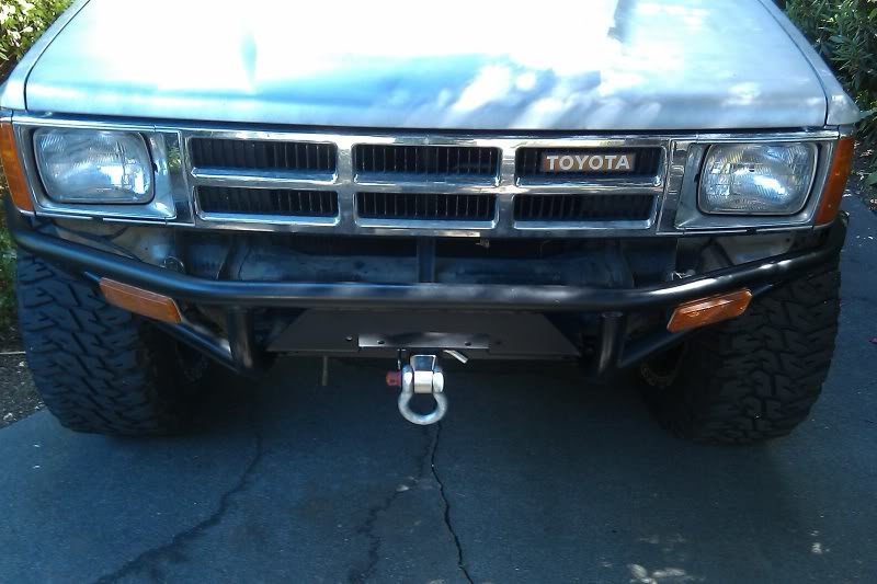

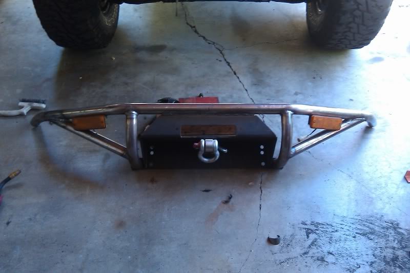

    I have had my winch plate sitting on my truck for a couple months now and finally got around to building the rest of the bumper.

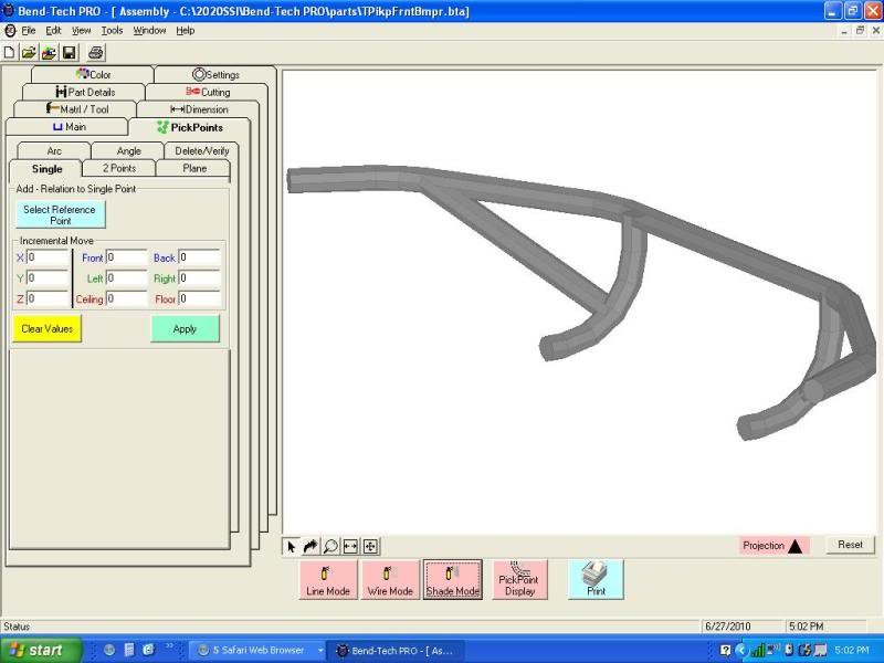

    Designed it in BendTech Pro, the best money I have ever spent:

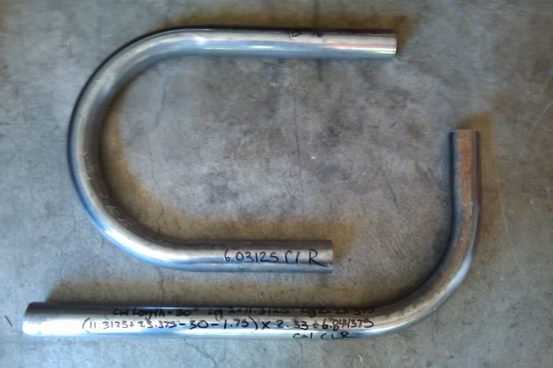

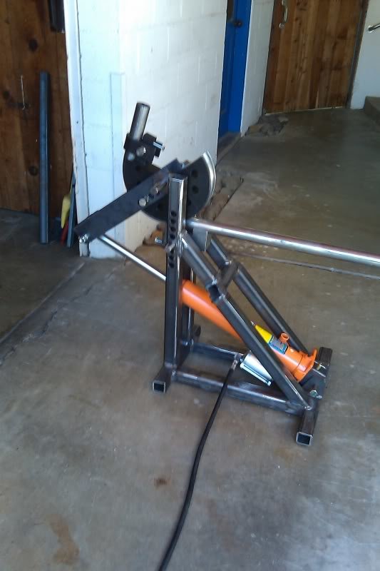

    Finally finished building the bender and bending the pieces to calibrate the software for the die:
    The calibration pieces:
    Main bar and center supports tacked up:

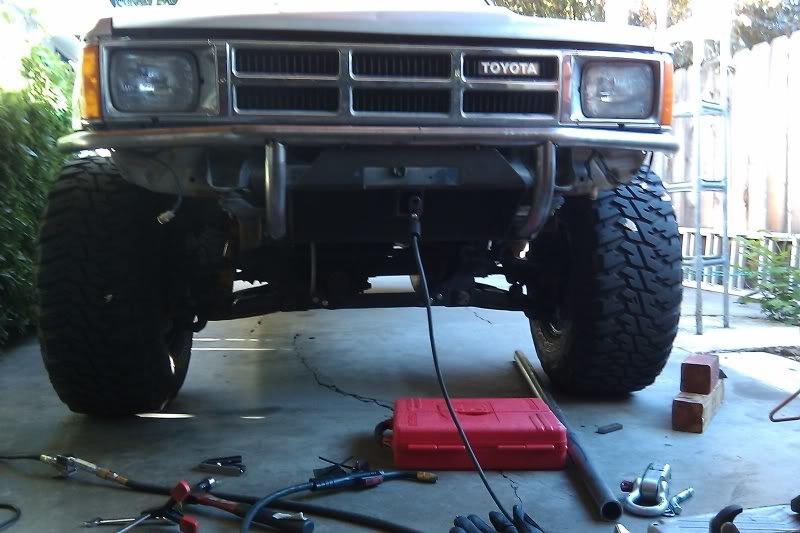

    One side support in place:

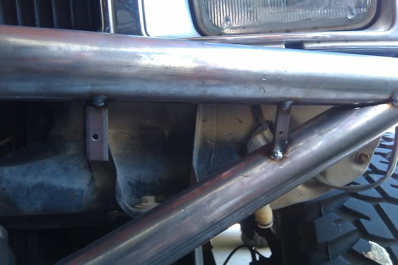

    Left side support in place as well as some tabs for the stock turn indicators:

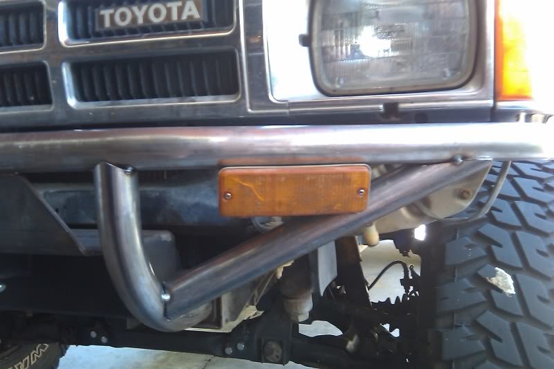

    Turn indicator in place:
    All tacked up and ready for finish welding:

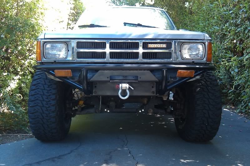

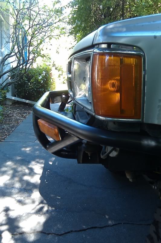

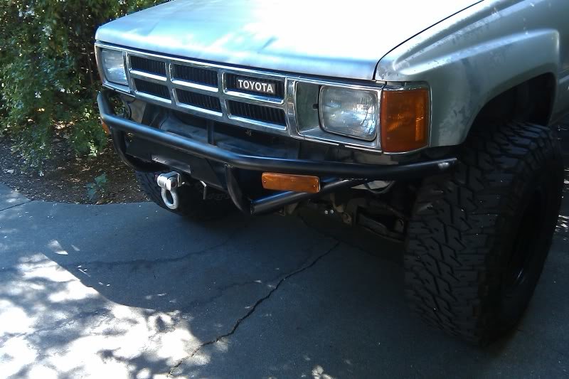

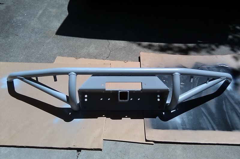

    Primer:
    Painted and installed:

    wait a sec is that a computer controlled bender?

    That would be nice, but no, its a manual air over hydraulic bender
