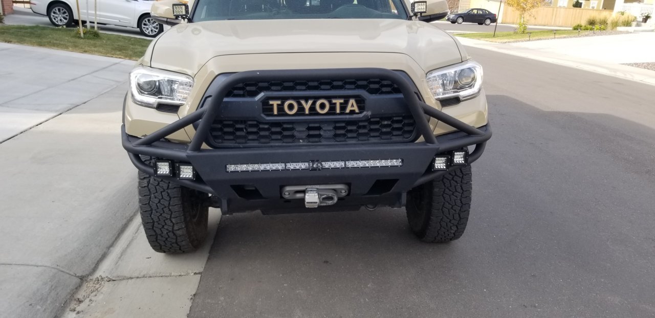

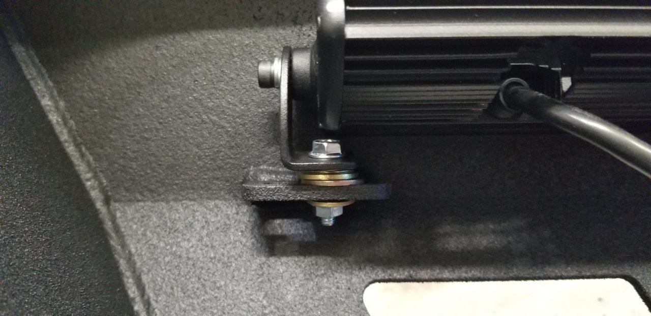

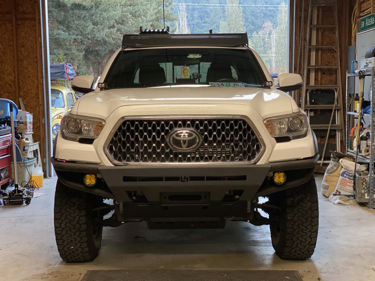

    For anyone interested in the light bar, it's not a Baja Designs because I think they are a huge waste of money. Here's what I got:
    https://www.amazon.com/Nilight-31inch-14500LM-Driving-Warranty/dp/B019XT82MQ
    Yeah it's cheap, but I've used this brand before and never had issues. I do add some RTV sealant to keep water out for good. To get it to fit this bumper I just had to reverse the small brackets and add some washers to push it up.

    Oh man what a pain. I had to alter a few things but it's on. Still need to wire the light bar.
    I'll post some more info tonight.

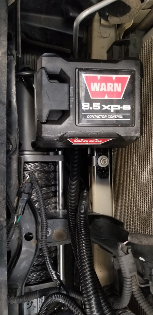

    Okay, so if anyone else tries to put a Warn 9500xps in, it's not going to fit with the control module mounted on the top like normal. It doesn't hit the center brace, but it does hit the front metal support piece that the bumper clips to. Even cutting the sides of the brace won't work.
    However, the bracket will match up nicely to I think what is part of the radiator core support. But for that to work you have to bend the Warn bracket where the control module attaches so it's oriented correctly. Here's a pic:
    I just sprayed a little paint where I drilled holes so it won't rust. I used some 12mm bolts I had left over from something else and they worked well. I just drilled a 5/16 hole and worked the bit around to enlarge it just a little.
    You can also see I re-used my fog light wiring harness and I just wired the pod lights into that so I can control those with my fog light switch. There's plenty of room with the pack mounted there, plenty away from the condenser and anything else. It does block some airflow a little bit but it should be fine.
    Other than this, the installation instructions from C4Fab were spot on, everything went smoothly.
    I have a few spots of touch up to do on the bumper, and I still need to wire the light bar.

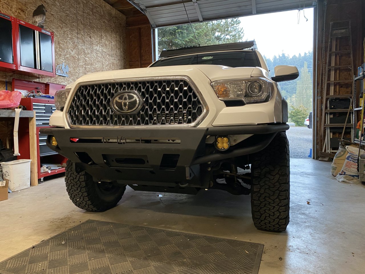

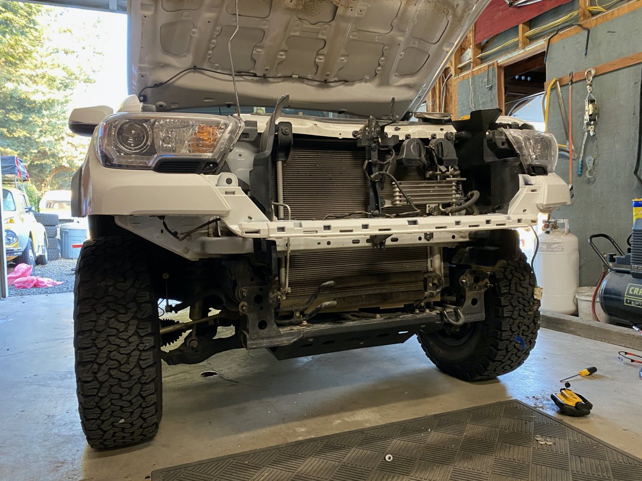

    Done! (for now) took 6-7 hours at a casual pace with a buddy, probably 5 of those just getting the front end torn down and cut. end product was definitely worth it! C4 youtube video was spot on
    Put some weather stripping on the cuts to polish off the look
