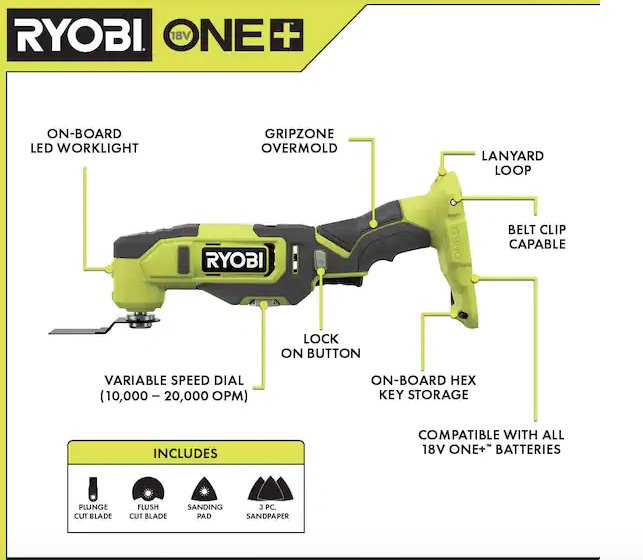

    Used an oscillating tool with the rounded blase. Super easy to control and very clean cut.
