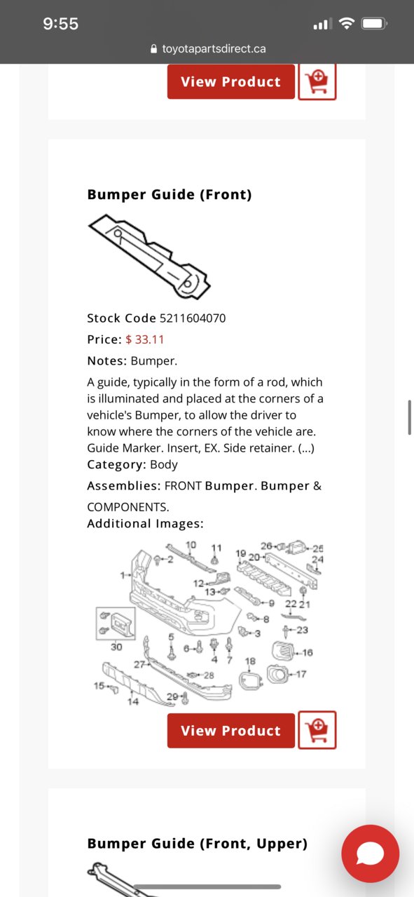

    The one that holds your bumper on the the fender is 1 long one. Not quite thin so it might get some force to get it back in. Only costs 35$ for a new one

    Found the part name for when I replaced mine

    Thank you guys, found a set of the guider clips on Amazon for $20, will report back this weekend after I attempt to fix it.
