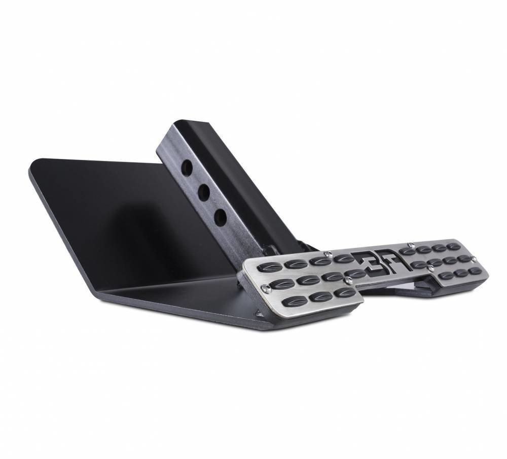

    I can tell you this hitch skid saved my rear bumper in Moab . up and down trails hitch skid.jpgthis video does not show how steep the hole is but you can hear the skid dragging 2 times .https://youtu.be/joFDTzQlQ4k
    No damage to the rear bumper still.
    Tacomod, BurlyJim, Intrepid and 4 others like this.

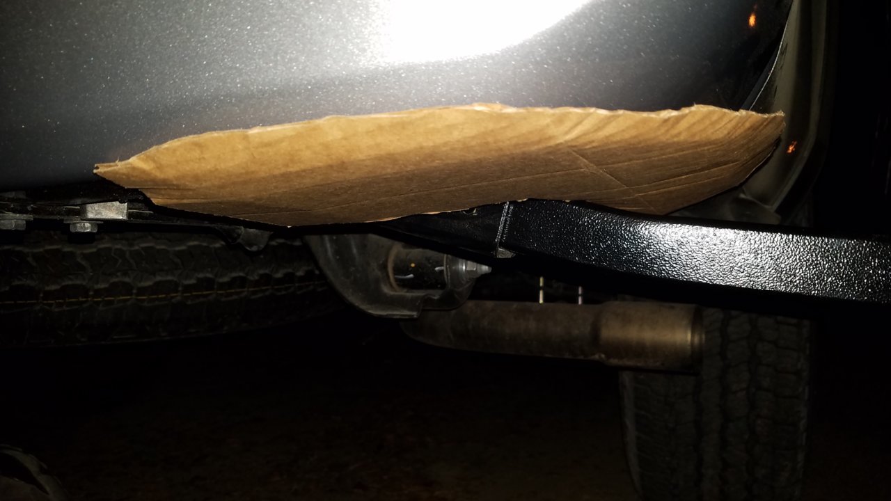

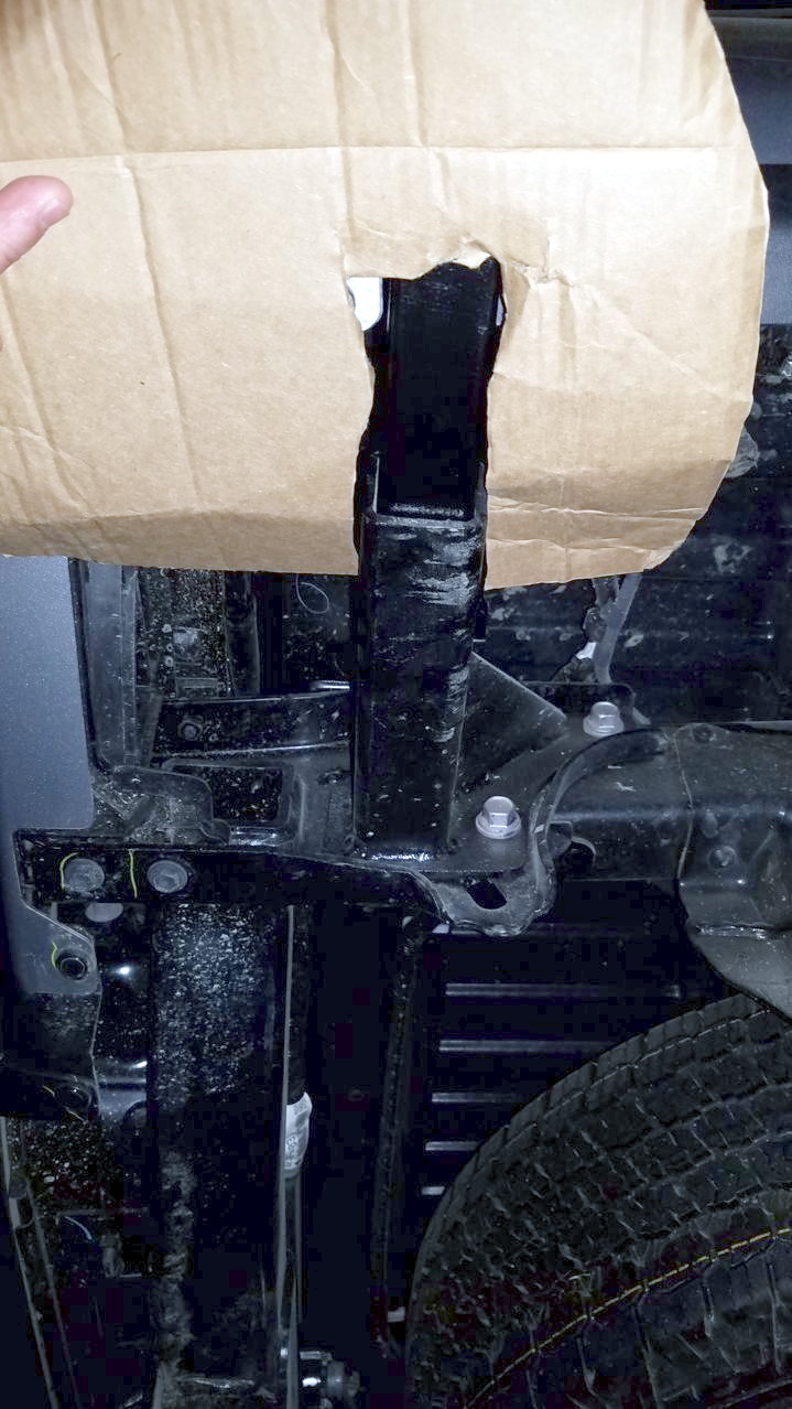

    Went out to get some actual experience this weekend. Pics below. I really like your mini max link. Looks really clean.
    Im starting to think that there's a reason for plate vs tubing and it's for sliding vs catching on rocks. When I get a chance, I'll look at my foam model and add in some plate. Should help with stiffness too.
    I'm still running into the design issue with how to connect the two sides without impeding functionality of the hitch. I don't think it'll look as clean with 2 pieces vs 1 piece.
    Also, I need to get sliders and skid plates sooner rather than later... Exhaust reroute scheduled Friday!
    https://ibb.co/2sB8mdm
    https://ibb.co/0FQW7PR
    https://ibb.co/9HbxJf4
    https://ibb.co/gZ3djqj
