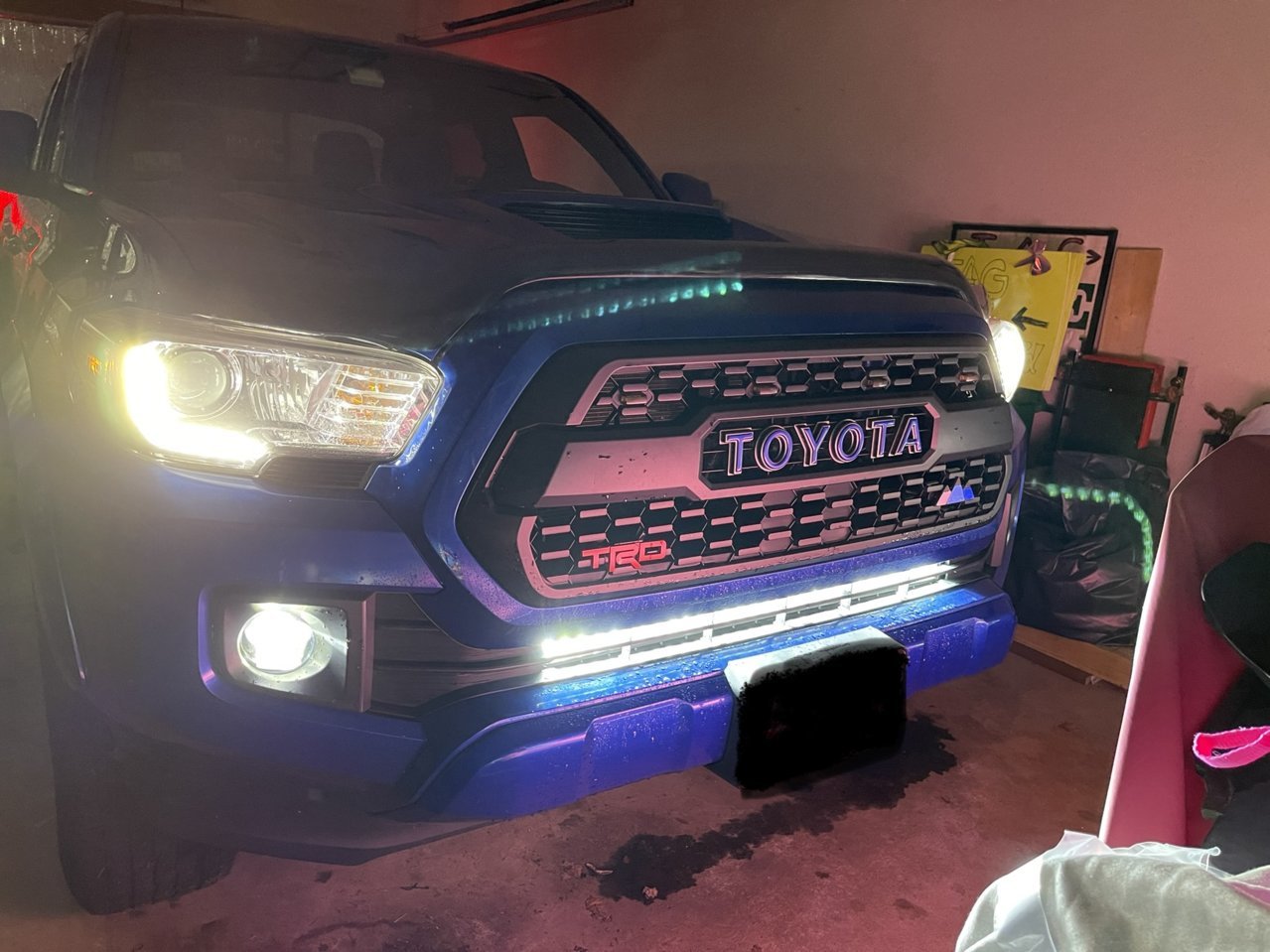

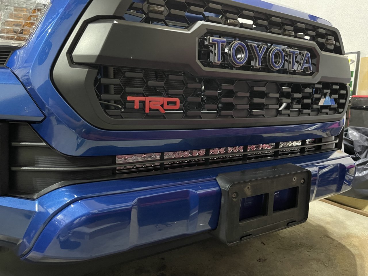

    You'll have to trim up the wind deflector before you reinstall it. I didn't reinstall mine and I've had no issues in the past year. That switch will work too. You can find them for cheaper at CaliRaisedLED

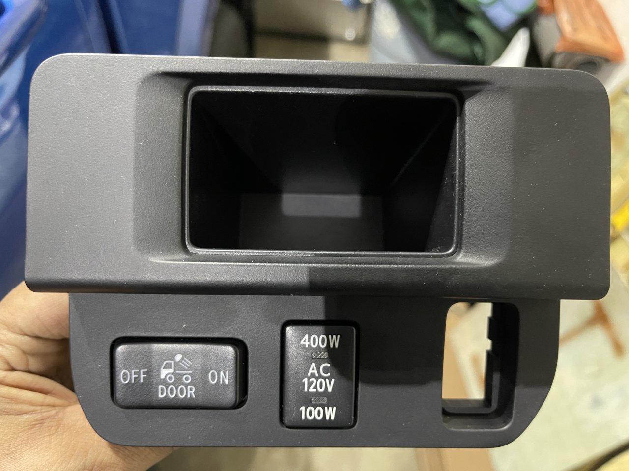

    I trimmed mine and reinstalled.
    Yes the switch will fit in that empty spot
    just like below
    and when you need more, you can make room

    I have the same setup on mine most likely. Bought the whole kit from caliraised. I wired my switch through an add-a circuit on the high beams so they can go off automatically when I go back to low beam. Holy hell is the spot beam bar I got bright! I was going to mess with trying to get the deflectors back in there today. I doubt there will be any issues without them here in New England but building custom cars I have seen MANY that overheat due to improper fan shrouds and airflow in general. Toyota put those there for a reason.

    I cut/trimmed deflectors in-half and reinstalled them. Not sure it would have made any difference. I installed the Caliraised and used their switch and relay. I live out of town and light is so bright, can only use on backroads. Neat gadget.

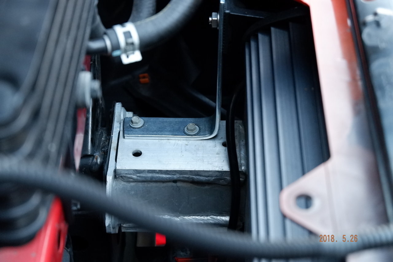

    You can bend it a little like i did, but maybe your mount is different?
    by the way the CH4X4 switch kind of suckes, I've had to take mine apart a few times over the years to keep it working. (2016)
    Go to the effort to put the vent in somehow, as it can run hot when its 90 out.
    PS i made my bracket from a angle bracket for under $10

    Yes mine is different it attaches to The support bar which has two nuts on them. I purchased mines from Amazon. I can put a link if need to be.

    I would like to thank everybody for the feedback and information provided. I was able to purchase the switch and it came in yesterday and it fit in to the slot perfectly I was able to wire it up and get it working thank you to everyone. I greatly appreciate it. Hope everyone has a great blessed day.
