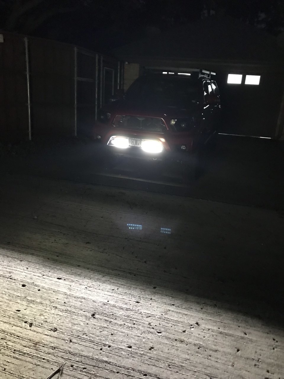

    I bought a pair of stealth brackets from Rago Fabrications to mount a 30” bar and then purchased 2 EA 10” Baja Designs S8 bars. Went to Home Crappot and purchased a 24” long piece of aluminum 4” wide. Cut the aluminum to gap the two bars to one another and used the light bar brackets to mount to the aluminum. The other ends of the bars I mounted to the stealth brackets.
    I have to run front plates in a Texas and didnt want to buy a 30” bar since a third of it would not be used.
