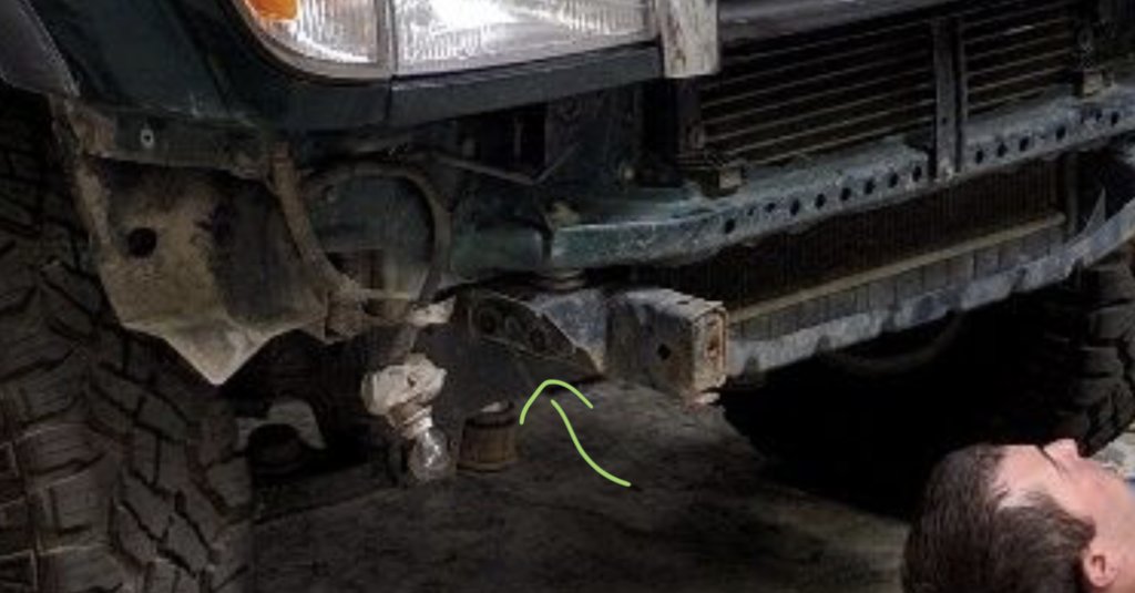

    Here's a photo of my '00, which has the longer frame horns. You can see that the driver side has been cut off, but the passenger hasn't (yet). So, that driver side (as shown) is the same length as '95-97/'01-04.

    Are you sure? I was under the "personal experience" impression that the horns on the front (that are being cut off my truck above) were different.

    Ahh, yes! I was under the impression (but maybe it's just Relentless that does it) that aftermarket bumpers all used the holes on the side of the frame as well as the frame horns (after removing the crumple blocks) for bumper mounting.
