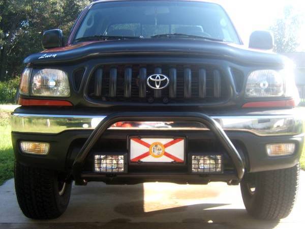

    Got the front bumper shot. Front end is pretty much blacked out.
    Before:
    After:
    Working from front to back. Got the door emblems blacked (thanks for the adhesion promoter tip, works excellent). Next in line is the SR5 emblems, then replace my white TRD decals with black ones, then the rear bumper.

    May 21, 2008
    #6783
    264
    Santa Clara CA
    98 2.4 5 speed
    K&N Air filter
    You you point me in the direction of how you painted the front bumper black.
    As it was chrome before...
    I think I want to do that as well... Yes I want to be a copy cat.

    Works for me bro.
    It was suggested here to me to use paint adhesion promoter on the chrome stuff. i didn't know about it until after i did the grill, but did before i did the bumpers. the grill is starting to flake already, the bumpers are good as the day i shot them. definitely use that stuff, it's cheap and works.

    how did you paint over that chrome? If I missed that thread can someone point me in that direction?
  19. Nov 11, 2008 at 11:24 AM
    #19
    HerNameIsLucy
    HerNameIsLucy [OP] I miss Lucy. :-(
    Jul 31, 2008
    #8256
    3,041
    John
    Equador. Don't know why.
    RIP Lucy.
    She's gone but not forgotten.
    I took some denatured alcohol and wiped it down. Then sanded it with a DA and 220 paper. A coat of adhesion promoter, another sanding, another coat of adhesion promoter, then shot it black using bumper match paint.
    I then used the alcohol on the plastic under the bumper and the filler place above the bumper, gave them one coat of adhesion promoter, and used the same paint on them.
    So far not a single spot is trying to flake off.
    It was a toss-up between the bumper match paint and the bedliner coating others have used. In the end, cost of the paint won.
