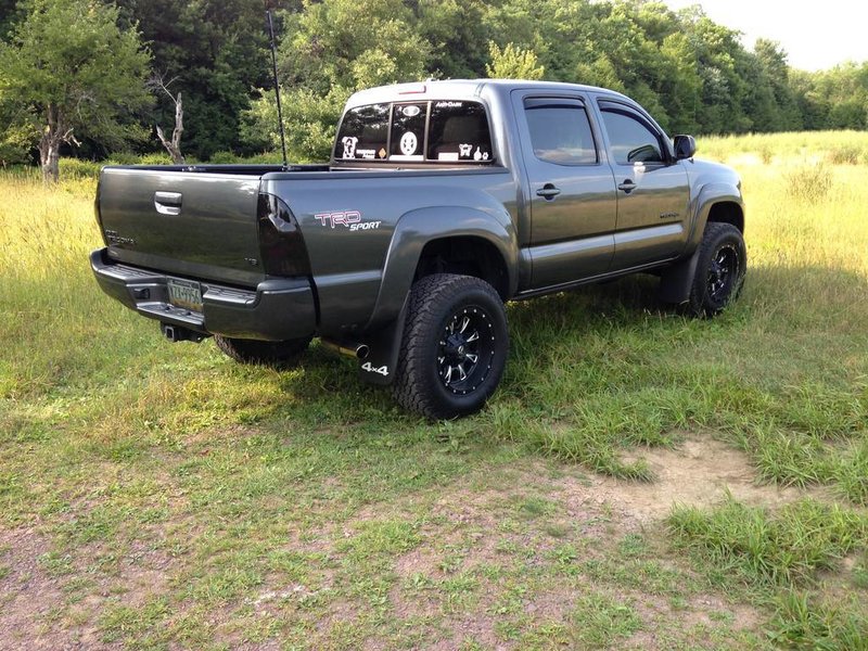

    hi all ordered a pelfriybuilt bumper, my question is i have a old man emu lift with dakers, i have the 885 coils up front, would i need to order 886 coils or 887 coils not sure truck has a little rake to it. any advice would be helpful.
