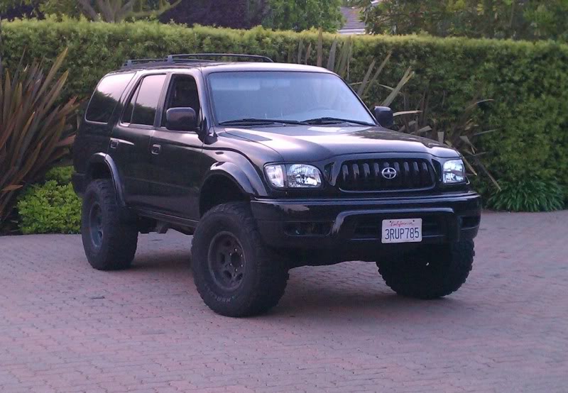

    yes, it will fit, but you will need to swap out the brackets (Put your tacoma brackets onto the 4runner bumper) and you will need to drill a few holes as the holes don't align perfectly in the bumper
    "fat lip" 4runner bumpers (99-02) are safe to put on 2001-2004 tacomas. Looks great actually
    it's horrible looking when you put a fat lip on 95-00
    [​IMG] [​IMG]
    Though, 96-98 4runner bumper will fit much better on 95-00 and look great too
