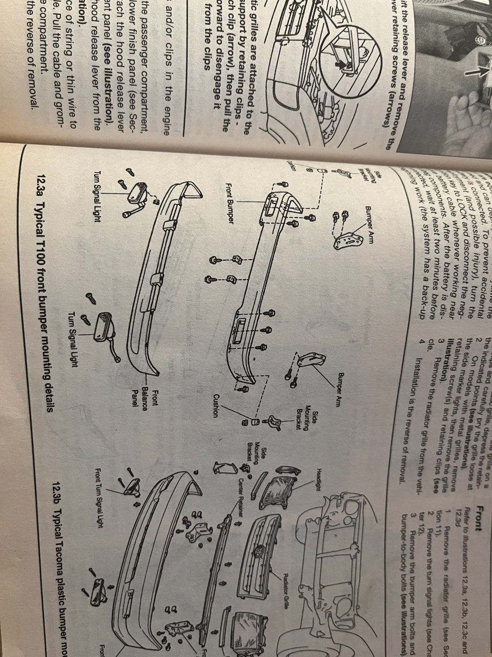

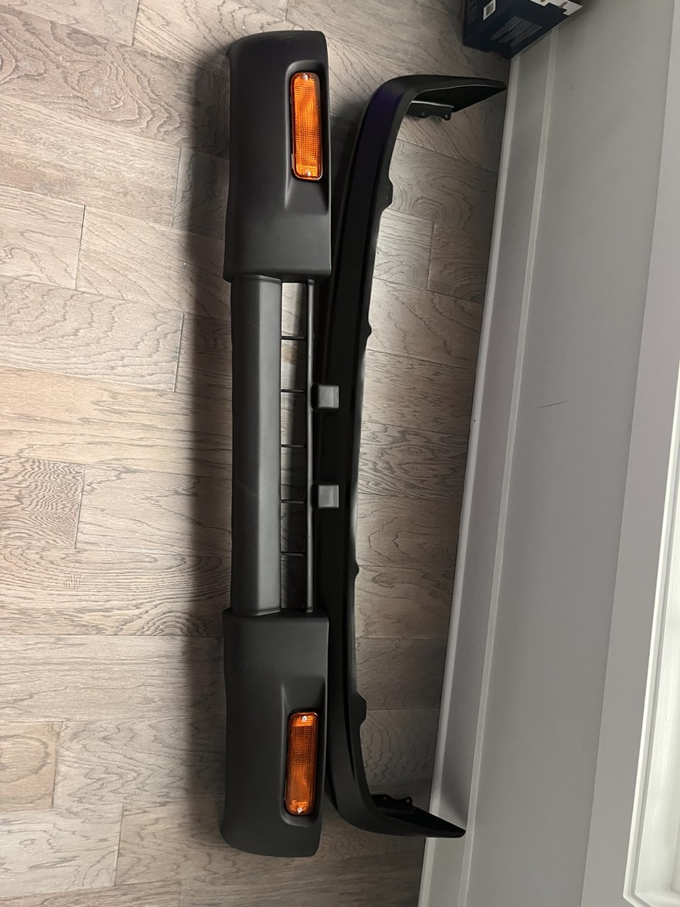

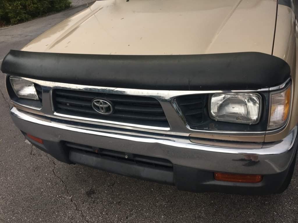

    Hey guys so I've been doing some research and just purchased a 97 tacoma. Everything on it has been pretty easy but for some reason I can't seem to find any guide to get the bumper off this guy. I am replacing the dented one with a black one I had ordered. If anyone has any videos or guides please shoot them my way

    Yeah I got one of the tear down manuals off Amazon I think I found the correct bumper legend.
