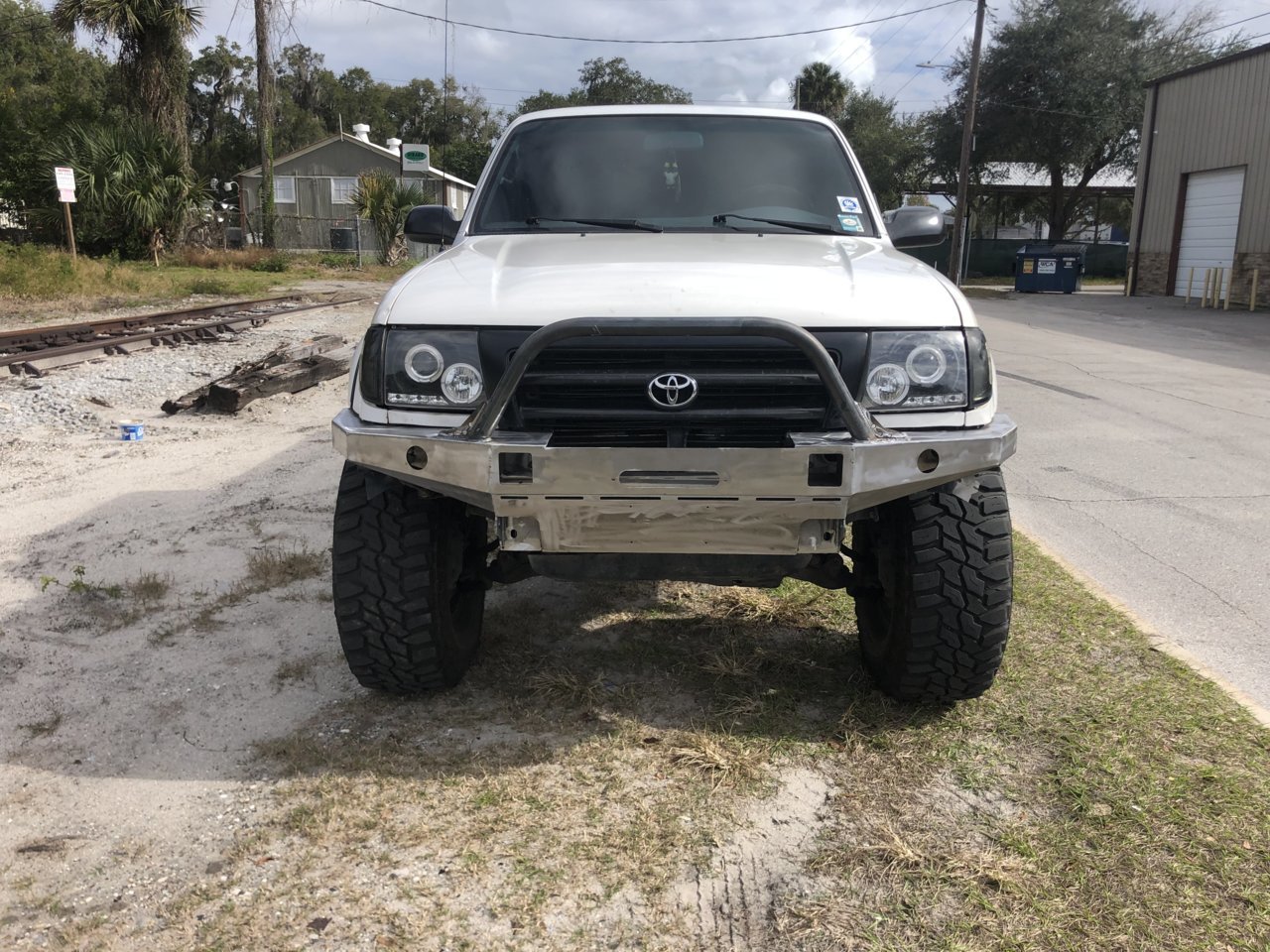

    Most aftermarket bumpers have 4 inch round cutouts for turn signals, so any 4 in round amber LED light will work. Just have to cut off the stock lights and wire in the LEDs. You'll need to add a relay too or else you'll get the LED hyper-flash
    Double check the diameter of the cutout though

    Well I wanted to mount lights in the holes it’s just I can’t fund any lenses. I thought all off-road bumpers used the same generic ones. Although I measured and it’s about 2 inches across and 2 inches vertical.
    Here’s a pic:

    I'd check out a local emergency lighting type of place. One of those up fitters that does fire trucks and ambulances. They'll probably have a cheap square light or just lens.

    Yeah I guess I was looking up the wrong thing. I kept searching for turn signal lenses and couldn’t find anything but motorcycle ones but when relentless fab sent the link I began looking for “side marker lights” as titled on Amazon because I didn’t like the amber and found several options.
