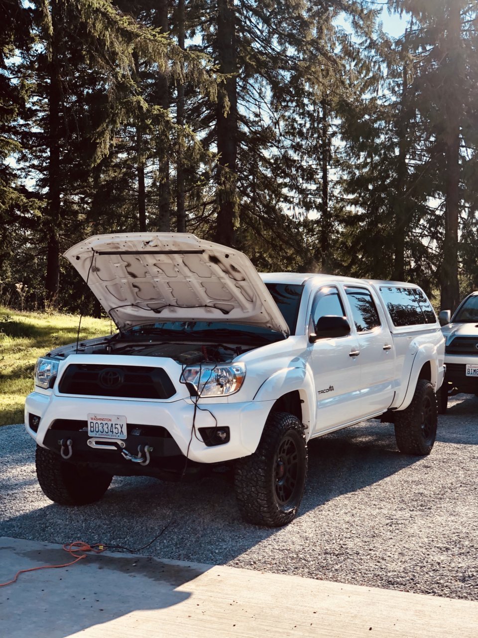

    Hidden winch bumper and arb air locker in the rear. Make sure to install a bigger compressor and tank so you have onboard air. That way you can pressurize your outdoor shower or whatever overlanderers are doing nowadays. I like the subtle look of the hidden bumpers but still get the safety factor of a winch when I’m up on the hill by myself.

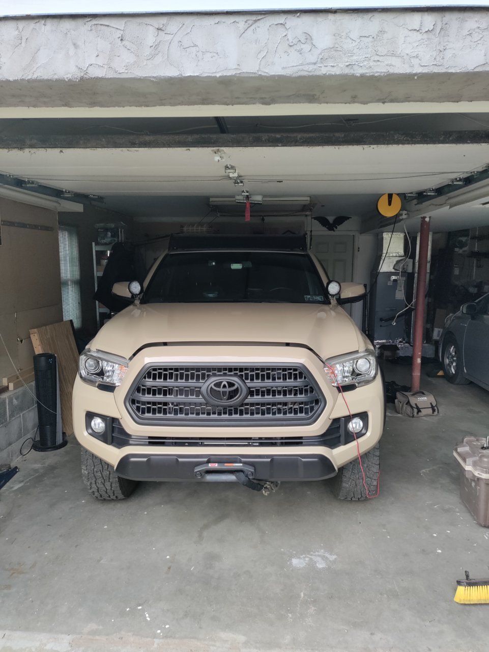

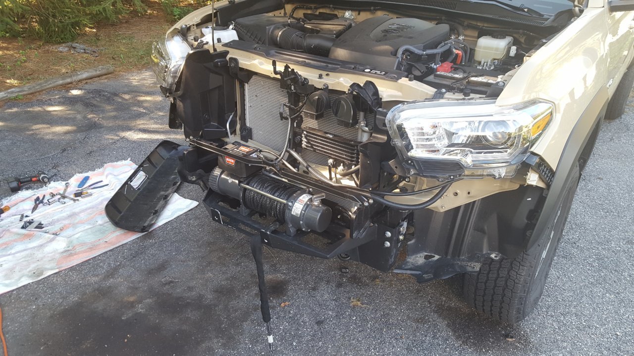

    CBI hidden mount
