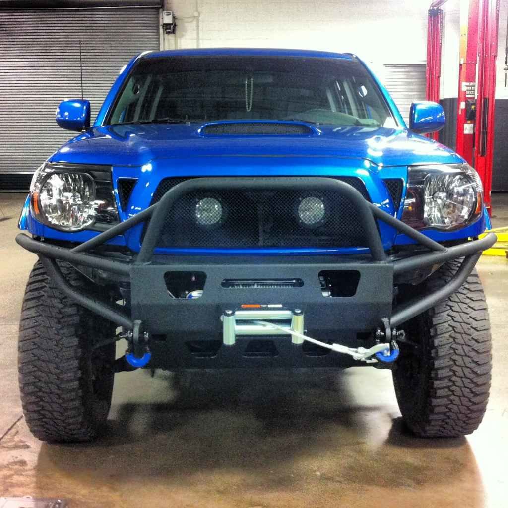

    *Luxury Extreme Motorsports "Grappler" Front Bumper*
    Call/Text Jason, 480.338.5696

    tacomarich luvsoffroading
    Apr 25, 2009
    #16433
    1,227
    rich
    arizona
    trd 4x4 offroad
    thats bad ass

    mh.meier
    mh.meier Not PB Mike
    Oct 23, 2011
    #65707
    6,726
    The Doctor
    Commiefornia
    Truck Norris Silver Unicornimus Prime
    2008 Tacoma DCLB 4X4 SR5 -Pelfreybilt Steel front single-hoop bumper (12+ conversion) -Baja Designs Squadrons -Baja Designs S8 20” -KM FABRICATION custom 1/4" steel bumper mounts -Warn ZEON Platinum 12,000lb Winch -Pelfreybilt Rear HI-Clearance bumper with swingout -NATO can carrier -Folding Aluminum table -RIGID SRQ reverse lights -Full Pelfreybilt skids -ARB air compressor under the hood -Custom CO2 Setup -KMFAB Custom ext brake line brackets -KMFAB Bedrack -Camping Lab MANSION RTT -ARB Touring 6' Awning -Litra Torch camping light -CTC Bed Cap, color matched -Toyota OEM bedmat -KMFAB bed reinforcement -Pelfreybilt Sliders -BAMF Bed corner tie down brackets -Custom chopped front fenders -OTTRAW switches -King Ext Travel front CO's -King 700# coils -Total Chaos Uni-ball UCA's -Sway-A-Way 2.0 rear ext travel shocks -OME Dakar HD pack with extra AAL -35" Falken MT01s -16" SCS SR8's in Black -Kustom 54 Retrofits -Smoked Tails -Airflow Snorkel -Cobra 29LX CB with PA and the fixins' -KMFAB CB antenna mounts -Pioneer in dash DVD with Nav -Weathertech mats
    Thats a nice looking tube bumper.

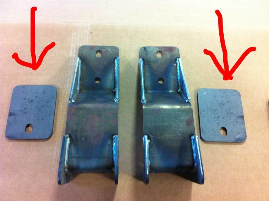

    Got a question about my bruteforce hybrid.
    I got my bumper yesterday and am dry excited to mount it. I also got my frame support brackets since I will be mounting a winch. For the most part this is all pretty straight forward.
    My question is, where do these plates go that came with the frame supports? I believe they go on the inside of the frame for added support. I think when I mount the supports the rearward bolt goes through the frame and through these plates then then nut goes on the bolt. Does this sound correct???

    That's exactly what they do. Inside of the frame rail, opposite of those big brackets. There's only 1 hole on the frame right there which is why tha plate only has 1 hole but I drilled a second hole through just because

    Correct. I just installed those last week. You will need a 1/2" drill bit. I had to cut a corner off the passenger side plate as there was a power steering bracket in the way.

    Ok, still slightly confused. I just took a bolt out to my truck and checked. I have 2 holes through the frame on both sides of the truck. Where do I need to drill the hole? In the plate?
    Sorry to be a pain, just want to make sure I get this right.

    You don't have to drill a hole. That one bolt holds fine. But yes, drill the hole in the plate. Just stick the plate up there and line up the one hole and mark it from the otherside. You are doin right. ;)

    I bolted it together woth the one that lined up, then drilled the frame and backing plate at the same time. I pilot holed the outside of the frame with a smaller bit, but it was way to short to reach the inside of the frame. The 1/2" bit reached all the way though. ;D I only had WD-40 (wish I had cutting oil), and that plate is thick and took some time to drill through. Second bolt dropped right in, no problem.
    I am getting a creak from my passenger side, however. I might pull the plates off and grease where they contact the frame. :notsure:

    I just got off the phone with billy. He told me what you guys are telling me about drilling the frame and plate. He was a little shocked to hear that on both sides of my truck I have 2 holes that the bolts go straight threw. So in talking to him we narrowed down that all I should only need to drill is the plates (hopefully). So I going to line up the plates with the supports today and start drilling.

    Ok, I am one to admit when I was wrong. This was one of those times. I installed the bumper and winch today and sure enough found that I do in fact need to drill a hole in the frame. Since I still have to wire up the winch I will be drilling those 2 holes next week. Otherwise I absolutely love this bruteforce hybrid.
