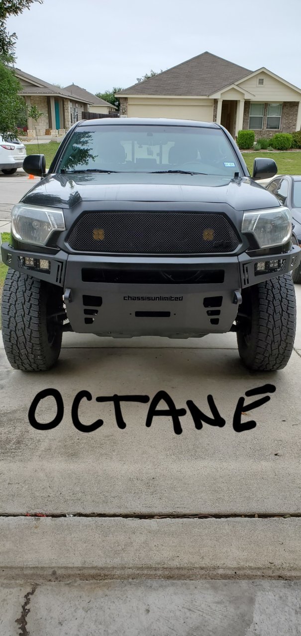

    so now I've a steel bumper, and I have yet to install the 700# springs onto my 6112 Billy's. I'm currently on the 4th ring with 600# springs. Should I place the 700# springs on the 3rd notch, or place it back in 4th notch also?? What are your setups with bumpers?? What are the pros and cons?? Thanks Bros of the !!!

    here is my bumper above....

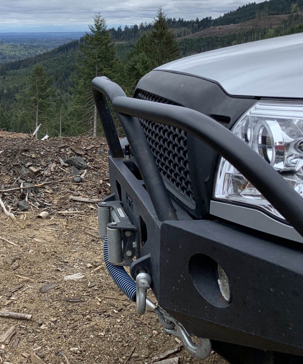

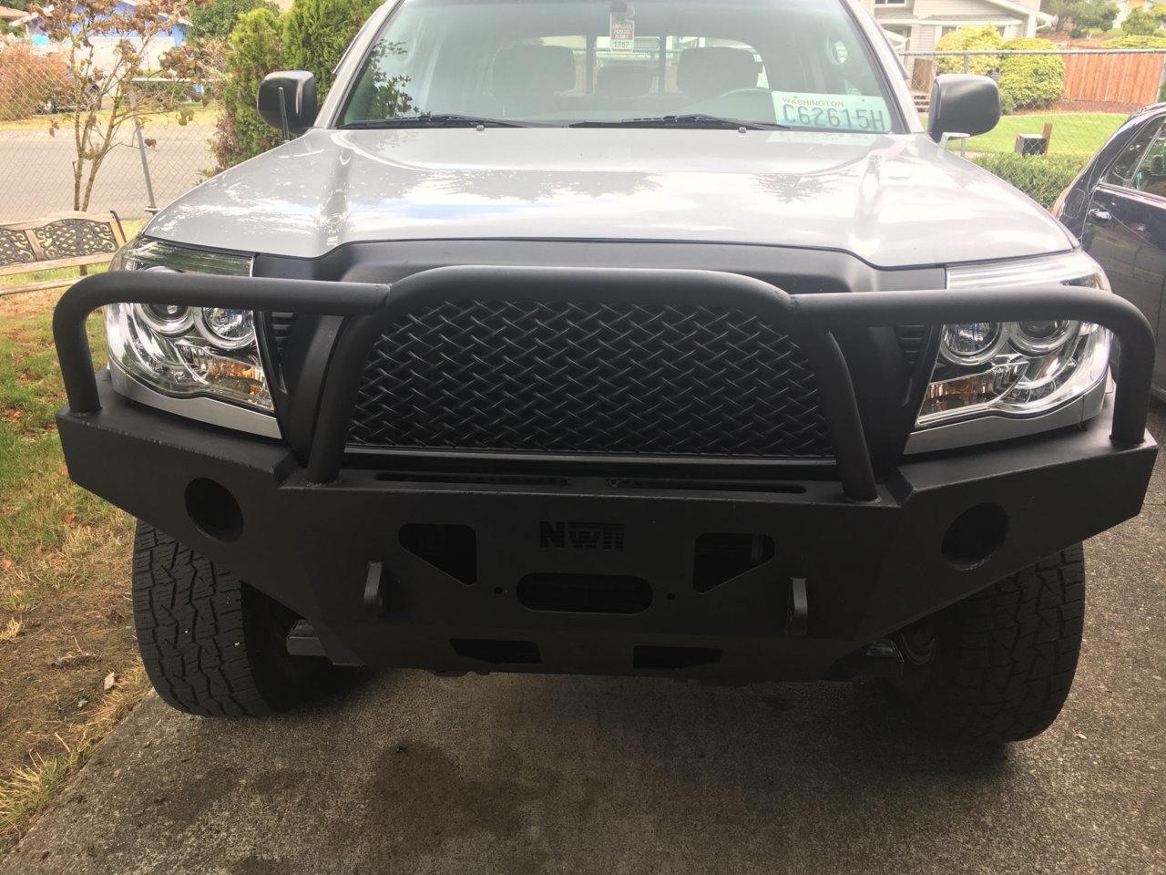

    Couple pics of my Steel Bumper. I really like how it doesn’t extend much past the grill. 266BCF76-1D69-44B4-8FBB-098802D2A089.jpg467E2B62-8164-46ED-BB9B-D7D53425BF71.jpg

    I have the 700# springs but the strut is on the bottom notch. I wanted to go higher but my spring compressor wouldn’t do it. The rear has 2” blocks and an add a leaf. I did all this before i did the bumper and winch. But I only lost 1/2” of lift after installing the bumper and winch.
