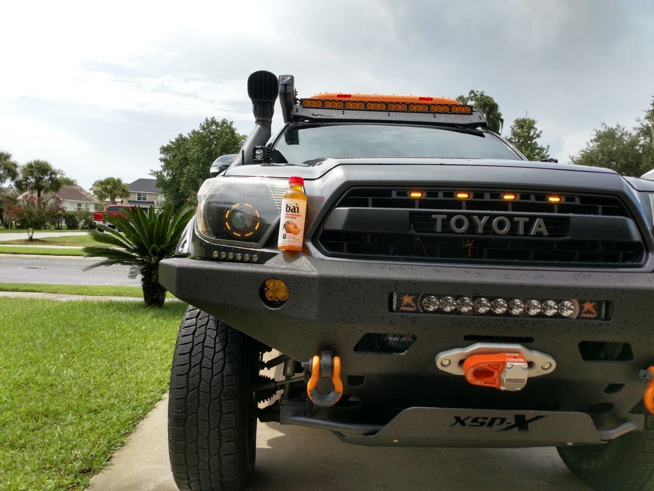

    My front and rear bumpers are Line-X'ed. I get almost all my parts from my truck used from here, craigslist and Facebook. The Line-X has been tough but I've never rubbed it on much.
