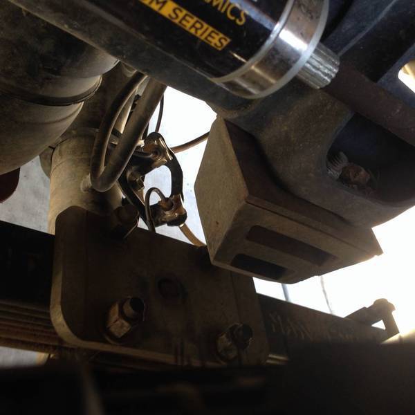

    well...you're in luck haha, that's just what I got done doing to mine lol
    heres what my rear bupstop setup is atm, im using my old Rough Country Ubolts since I wasnt able to put on the Ubolt flip yet
    heres my shock measurment, I have a 10" shock and 5" is showing, so I have 5" of uptravel
    excuse the slightly crooked tape measure lol, but from where the bumpstop is mounted at and to the strike plate up top, is about 7 1/2" - 7 5/8" by the looks of it
    and the factory bumpstop is about 3" tall
    so essentially, I have 5" of uptravel and base to strike plate is 7.5", so 7.5 - 5 = 2.5, so I would need at minimum a bumpstop that compresses to 2.5". I would still like to get the daystar 4.5" bumpstops to get a better ride quality when I do hit the bumpstops

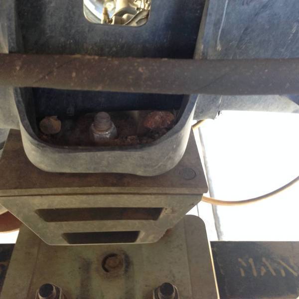

    enough to go over stuff

    nice, thats the 2.5" bumpstop? im thinking I should still go with the 4.5" one, doesnt look like you have as much space between the plate and the strike plate up top as I do or maybe its just how it looks lol

    I was thinking the same thing. It looks awfully tight in their. That's what he said

    Its enough room. I dont hit them unless im offroading.
