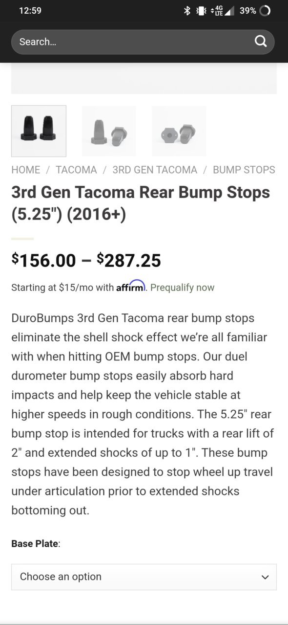

    This is the Info I found, same description as the 4.25

    Aftermarket bump stops make a world of difference over the awful stock ones. I don't even feel it when I hit mine (Superbumps)

    All of them.
    You want the smallest bump that your shock uptravel will allow. You don't want to limit that

    . Yeah, I'm def gonna get some just wanted to get the right size and since I'm doing the lift I wanted to have the brake lines and bump stops ready to go
    Yeah, makes sense. That's why I didn't want to get 5" if it didn't make sense. I may wait until after the lift goes in to see the space between.

    Per Wheelers page for the supers, mine are 2-5/8" tall and they work perfect with my 2.25" lift.
