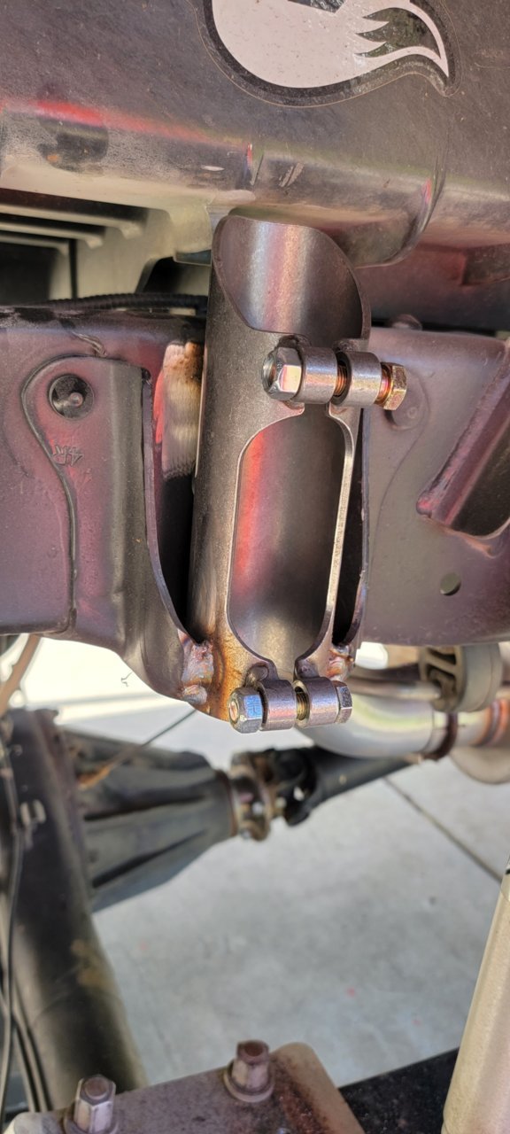

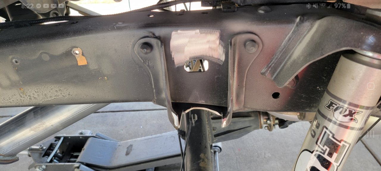

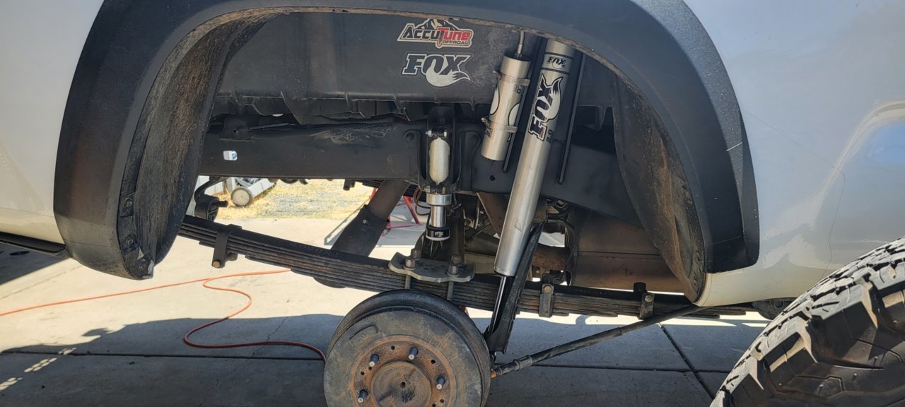

    If you have access to a welder then air bump will be a breeze to do and you'll be able to save some money. Here is how I did mine. Screenshot_20211221-082231_Photos.jpg Screenshot_20211221-082238_Photos.jpg Screenshot_20211223-204504_Gallery.jpg
