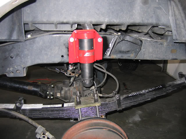

    right on... ay do u have a pic of the rear im kinda curious on were they mount at...??

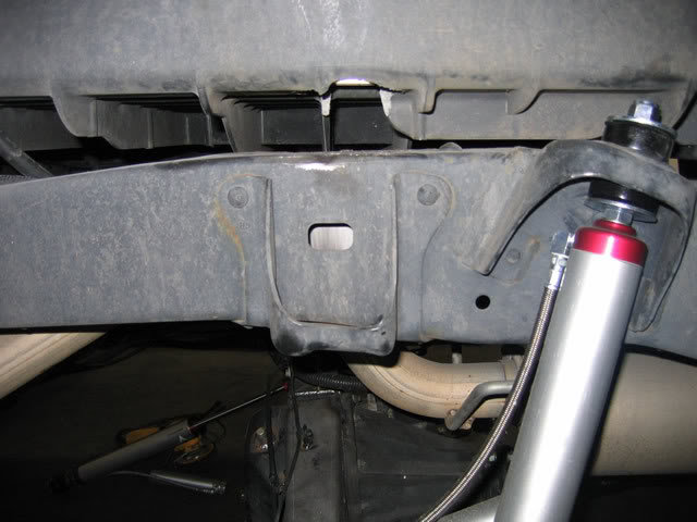

    This:
    Changes to this:
    Note that they DO NOT work with the u-bolt flip kit. Ignore that part of the picture.
