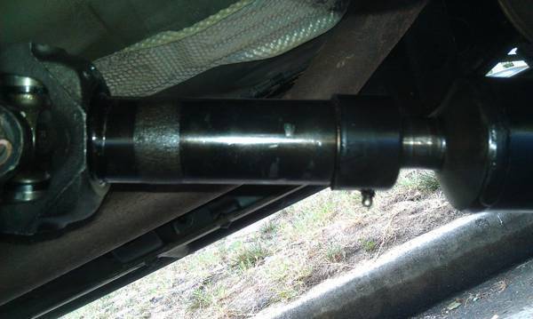

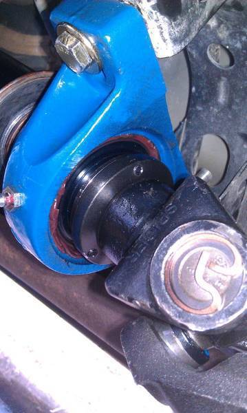

    Well the driveshaft has been sorted out, with the help of PSU TACO85 giving me this link and Standard Parts in Richmond Va, i came up with this,
    With the bearing being solid, no movement for axle travel, i had the ds shop add a slip yoke to the rear shaft giving me plenty of ds for added lift and axle droop on the trails.
    And a thanks to Mjp2, mike, for assisting also

    DS shop was worried about vibes with the solid bearing but so far no vibes to report, have another stolen idea of running some rubber mudflap in between the bearing and frame if vibes occur
