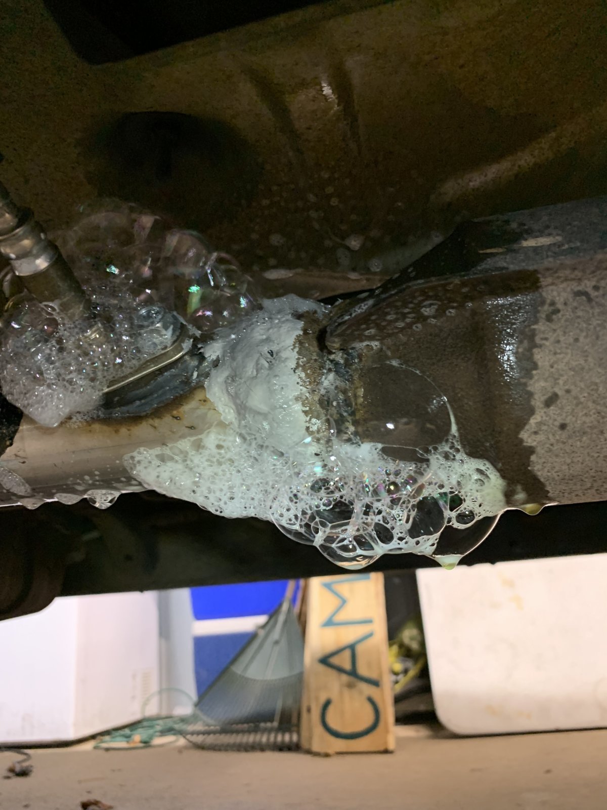

    i know I still have a small exhaust leak between the exhaust manifold and the first cat and behind the second cat from a bad weld. The exhaust mechanic said the pinhole type leaks are insignificant (shouldn’t cause a p0420 code) that he couldn’t identify any leak just listening or feeling for it. I showed him my pictures where I used a vacuum to push air from the exhaust towards the engine and soapy water to identify the leaks. He basically shrugged his shoulders. Should I demand my money back given they aren’t willing to get it perfectly sealed? I mean, I feel like I shouldn’t be having any leaks.

    Fix the leaks… the front 02 sensor IS that sensitive.

    Agreed. Any obvious air leaks cannot be ignored if you have a pesky p0420 that keeps returning

    Agreed as well. Those appear to be some significant leaks given the amount of bubbles, especially right around the 1 sensor. The P0420 code, from my understanding, pops due to the differentiation of Sensor 2 numbers compared to Sensor 1 numbers being too far out of whack, so if Sensor 1 numbers are skewed (reading leaner than actual) due to those air leaks it makes it seem like the cat isn't doing its job efficiently enough because Sensor 2 is showing much more rich in comparison.

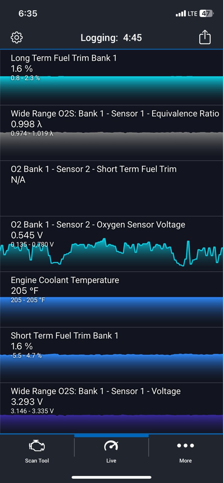

    Can anyone tell me anything based off of these numbers? Fuel trims look ok I think? Why N/A for the O2 bank 1 Sensor 2? I just replaced the rear O2 sensor.

    Bank 1 sensor 1 should be a quasi saw tooth pattern, bank 1 sensor 2, after the cat, should be a relatively smooth line with some smooth wave transistions.
