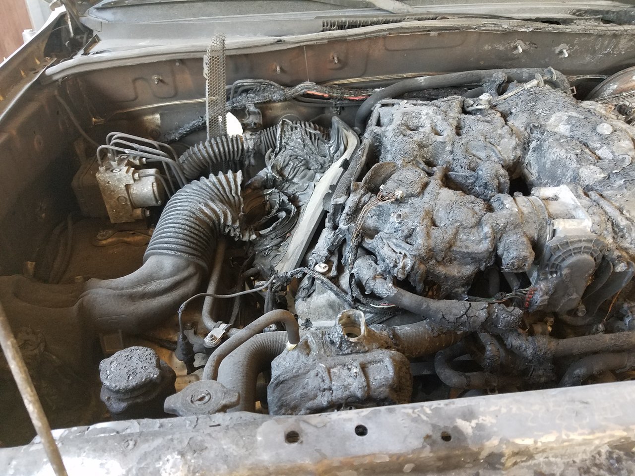

    Whats going on guys, kve been a member for quite some time no but not a lot of posts but a lot of learning and reading. So recently i lost my truck to a fire.and was wondering if anyone has heard if such a cause. My younger brother took my truck to get it alighned by pep boys while i was at work. 10 minutes aftet he got home , he came out tk the driveway and it was in flames. Has anyone heard of such a thing ? I will upload pictures later on tonighg whenni get the chance. Thanks in advance.

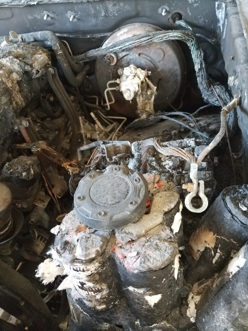

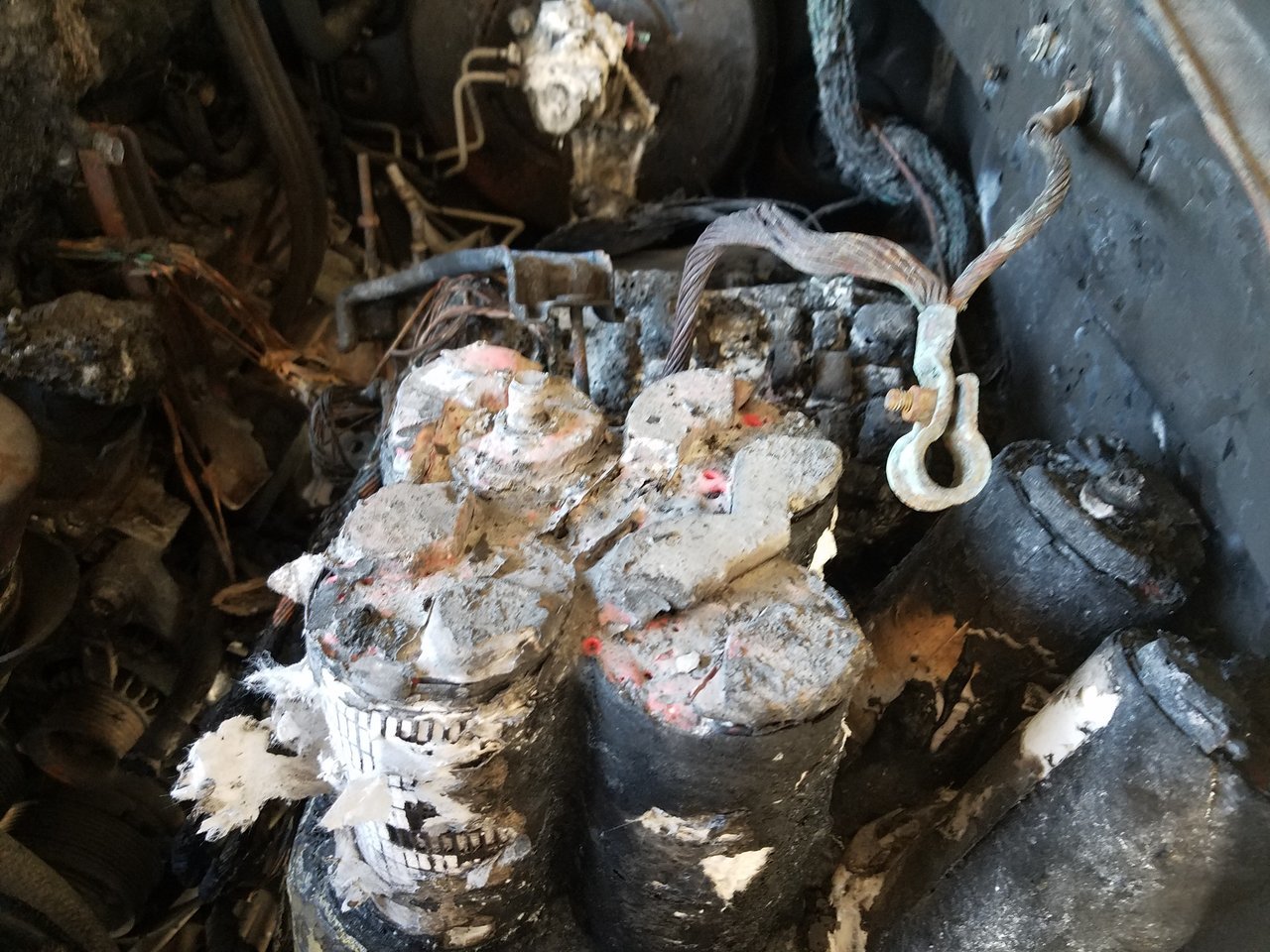

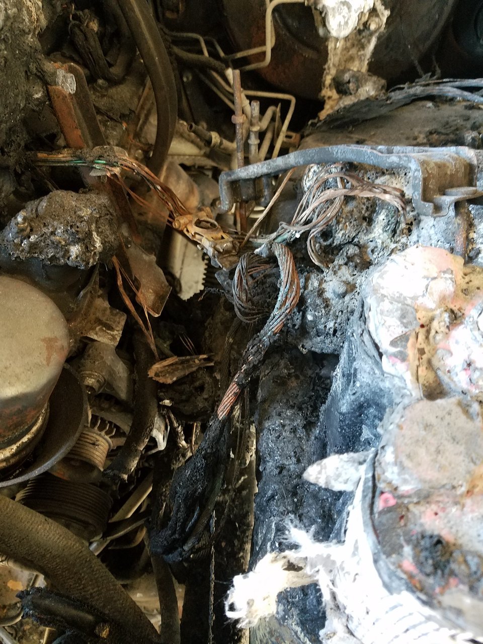

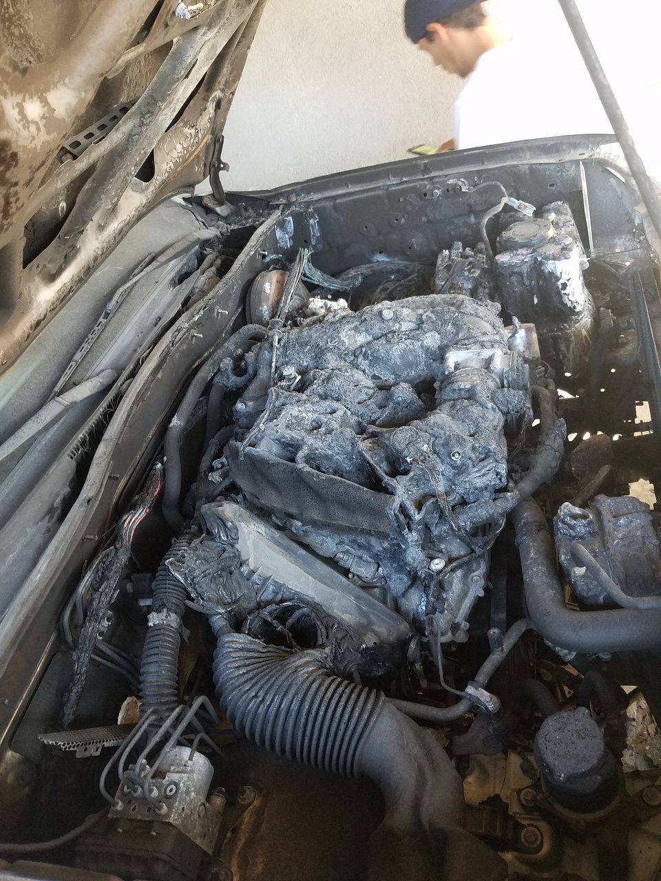

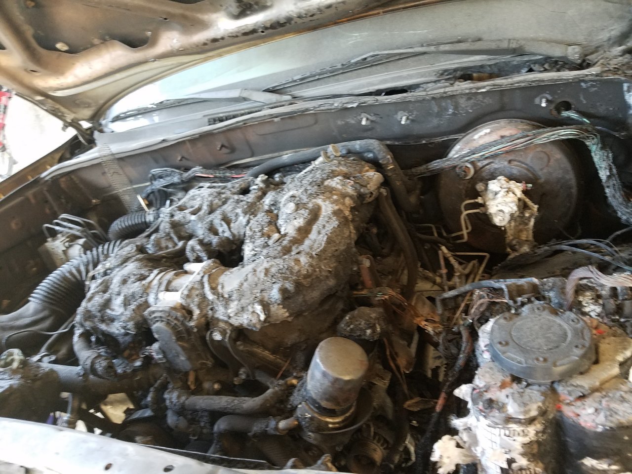

    and this is the bbq
    20170828_164415.jpg 20170828_164415.jpg 20170828_164417.jpg 20170828_164424.jpg 20170828_164815.jpg 20170828_164829.jpg 20170828_164835.jpg

    Ferraris burn up pretty regularly. Tacomas not so much. Sorry for you. What's the wheel center cap looking thing on top of what used to be the battery?

    Looks like it started at the battery
