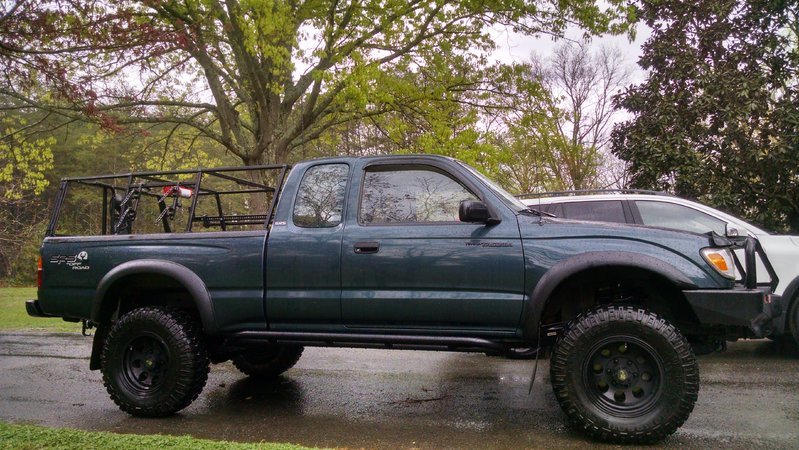

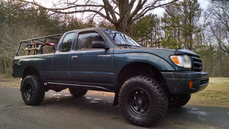

    As she sits today...(April 2016)

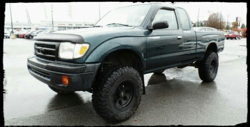

    Here's the pic from the online ad when I found her... (November 2015)

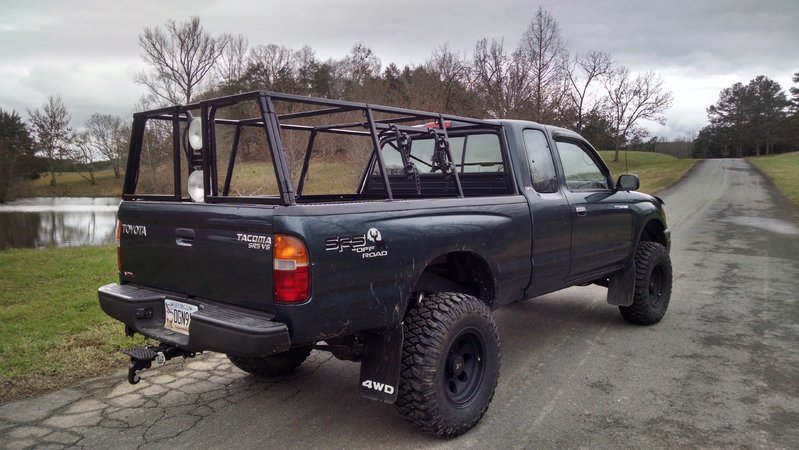

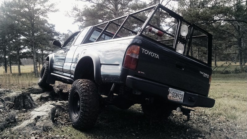

    Bedrack
    Homemade bedrack - built by me
    Here's a link to the build...
    https://www.tacomaworld.com/threads/burnetts-bed-rack-build.409845/#post-11603646

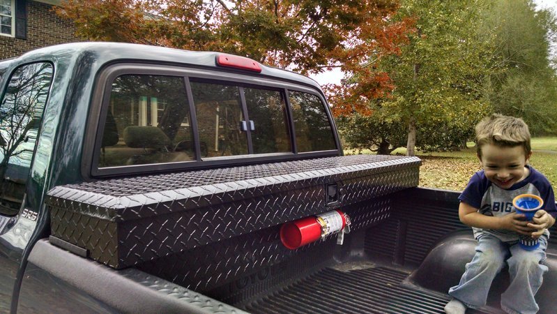

    Custom toolbox I cut down to fit the truck build link below:
    https://www.tacomaworld.com/threads/cheap-free-mods.4838/page-97

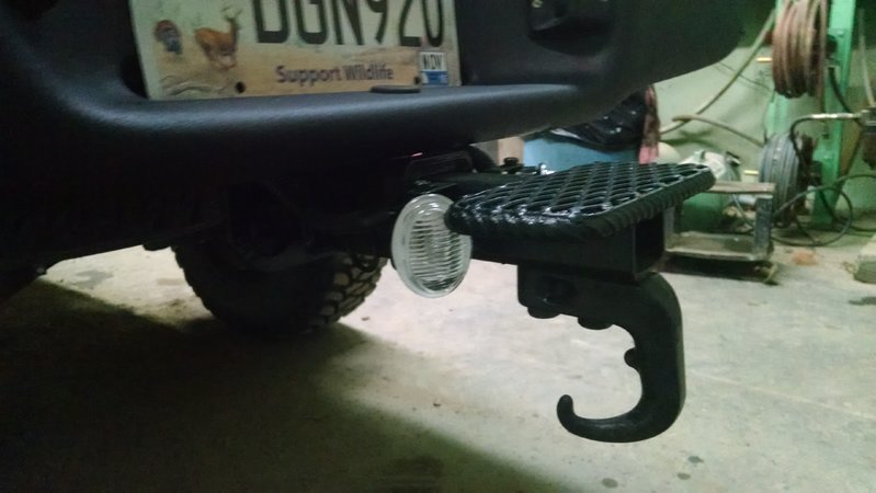

    The reverse lights suck on these trucks so I added these to my hitch step/tow hook
    Here they are in action...
    The reverse lights are wired in to come on when backing up, the bedrack lights are optional and wired to a switch in the cab.

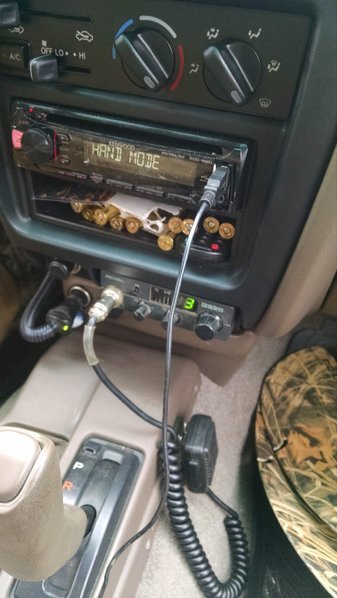

    My uniden CB install - fits perfect in the ashtray slot

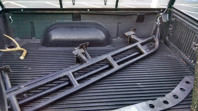

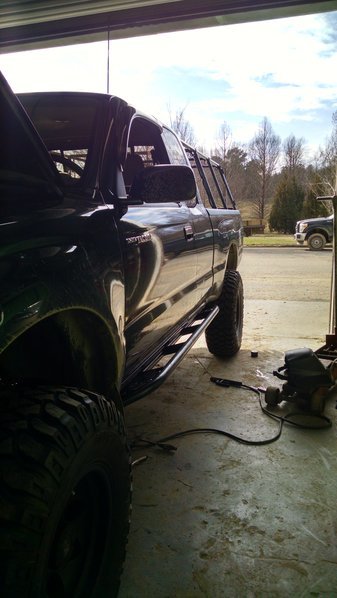

    Picked up my sliders and some rear frame reinforcement plates from a nearby TW member for $125!
    Mocking up the sliders...
    Had to add some plates to make the sliders fit the way I wanted.
    All welded up! It's nice living a few hundred yards from my work, free after hours shop access!:woot:

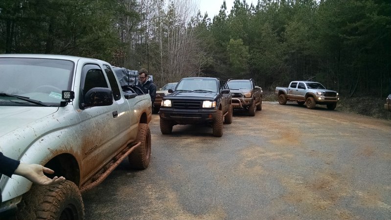

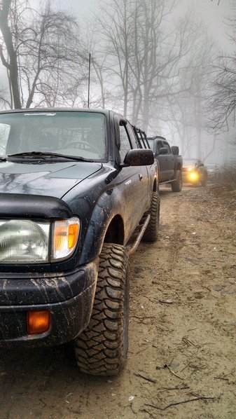

    North GA wheeling trip with @BYJOSHCOOK and some of the other local guys

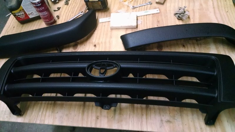

    Test fitting my new to me faded fender flares...
    Plastidipped the flares...
    And installed...

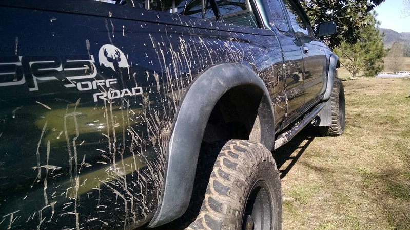

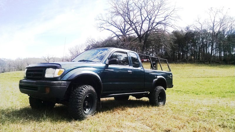

    Messed around on the farm today, flexed the truck a little bit..

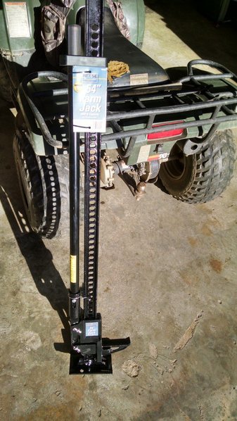

    Finally picked up a hi-lift today...

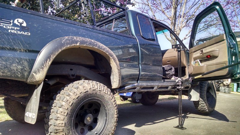

    Tested out the sliders and hi-lift today...
    Everything held up..:thumbsup:

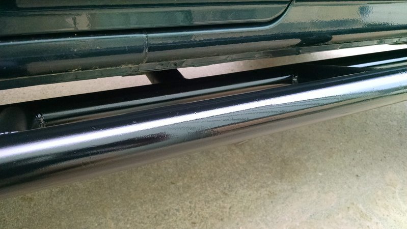

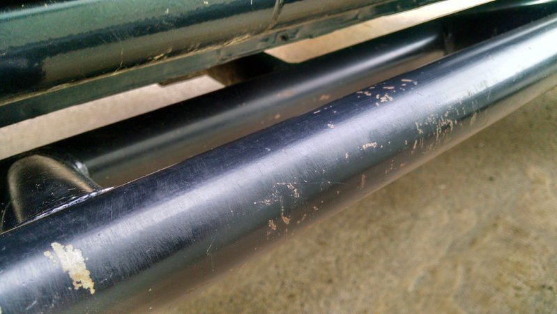

    Fresh coat of paint on the sliders, they needed it!
    Before...
    And after... Shizam brand new!
    Gotta love some rattle can black!

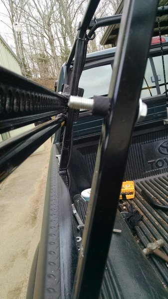

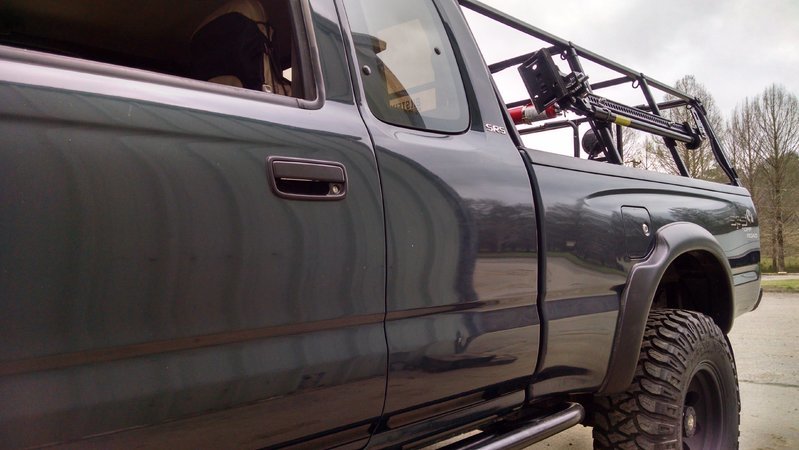

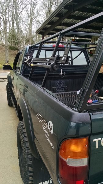

    Got the hi-lift mounted up to the bed rack...
    Easy install, drilled a couple holes, slid some pieces of fuel line over the bolt to cushion the hi-lift and give it a little room to flex.
    Then I used some foam grips off a pull up bar for a cushion between the hi-lift and bed rack. They'd both be down to bare metal in no time with nothing between. IH8RUST!

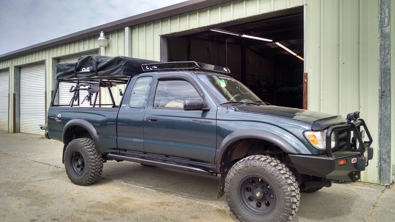

    With the new RTT, I decided to add a roof top basket over the cab for storage and to help get the wind drag off the tent.
    I'll be tying the platform for the basket into the bed rack so that I won't have to drill into the cab.
    This way I can easily remove the basket when I need to.
    Here's the truck with the basket set in place...
    Looks pretty sharp...

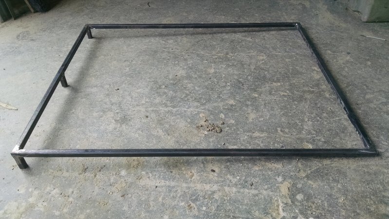

    Here's the mounting frame I fabbed up to hold the basket. I'll weld it to the bed rack and put some rubber bumpers on the front so it can rest on the cab.

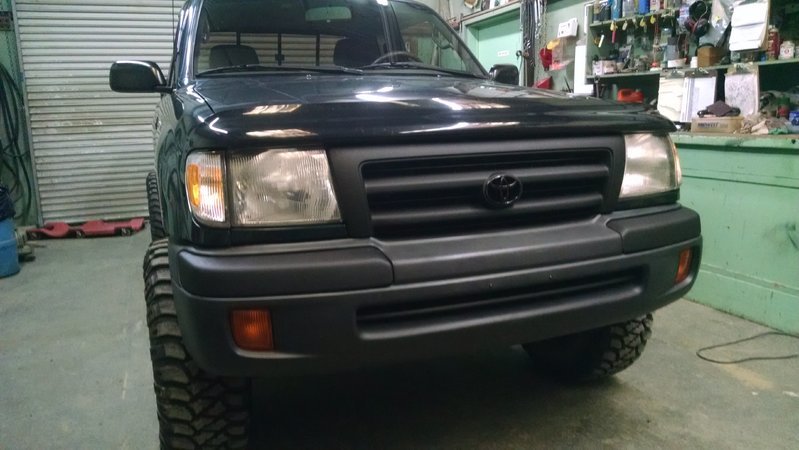

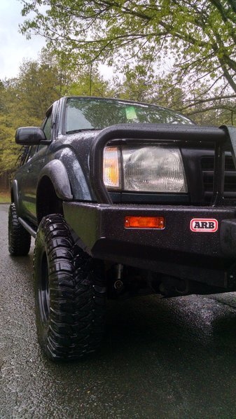

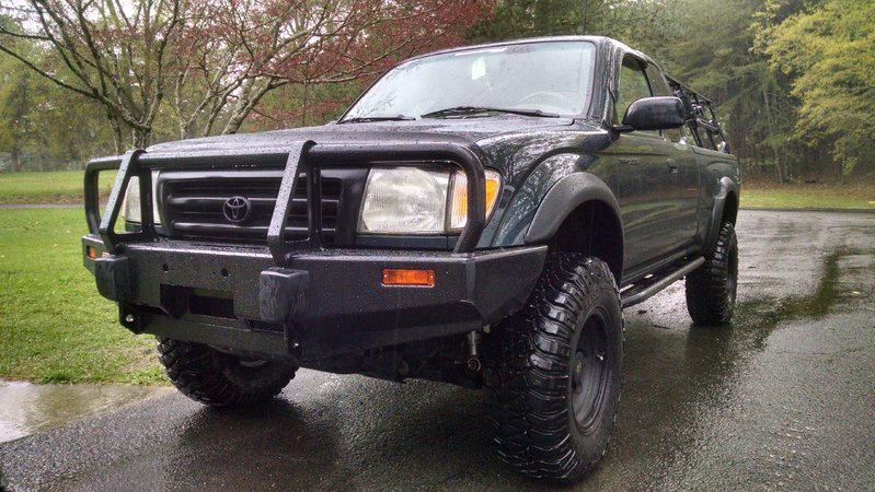

    ARB Bumper showed up today!
    :taco:
    Got the new ARB installed, this thing is a beast! Weighed in at 78 lbs. which is surprisingly light for how beefy it is...
    I took a few pics to show the install, but just said f*%k it after a minute.
    Stock bumper gone
    Crush cans unbolted, I sanded and painted the frame ends to take care of the surface rust...
    And bam! New bumper installed, yes it's that easy!
    Nah, it was overall pretty straight forward, no modification to the truck just a bolt on install. The worst part is aligning the bumper. If anyone does this, my suggestion is do not tighten any bolts until the bumper is in place, it makes it alot easier to install. It has very tight tolerances.
    A couple more pics of the bumper installed...
    Really happy with the bumper, I'll be installing some long range lights soon!

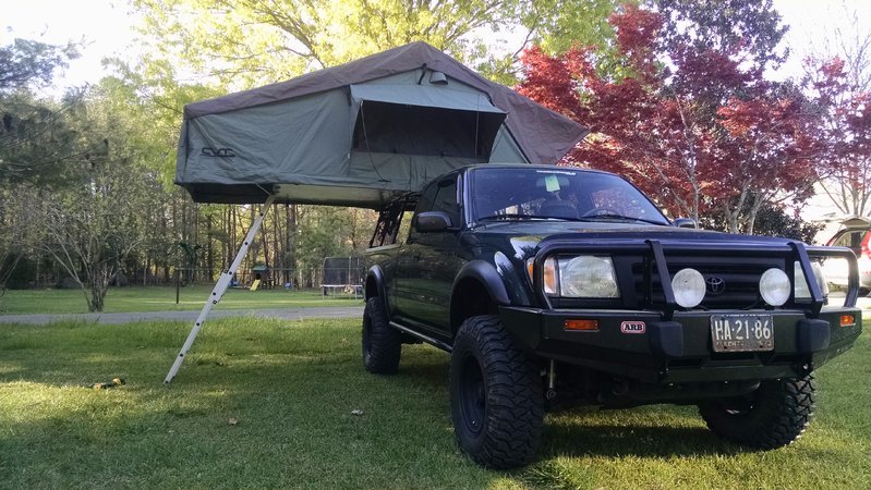

    CVT Mt Rainier w/ stargazer & LED lighting!:woot:
    Got the RTT on and tested it out, very well made tent!
    Me and the family are excited to head to the woods!
    Here it is set up in the yard without the annex...
    My little man checking out the new digs...
    LED lights all hooked up... High tech red neck lol
