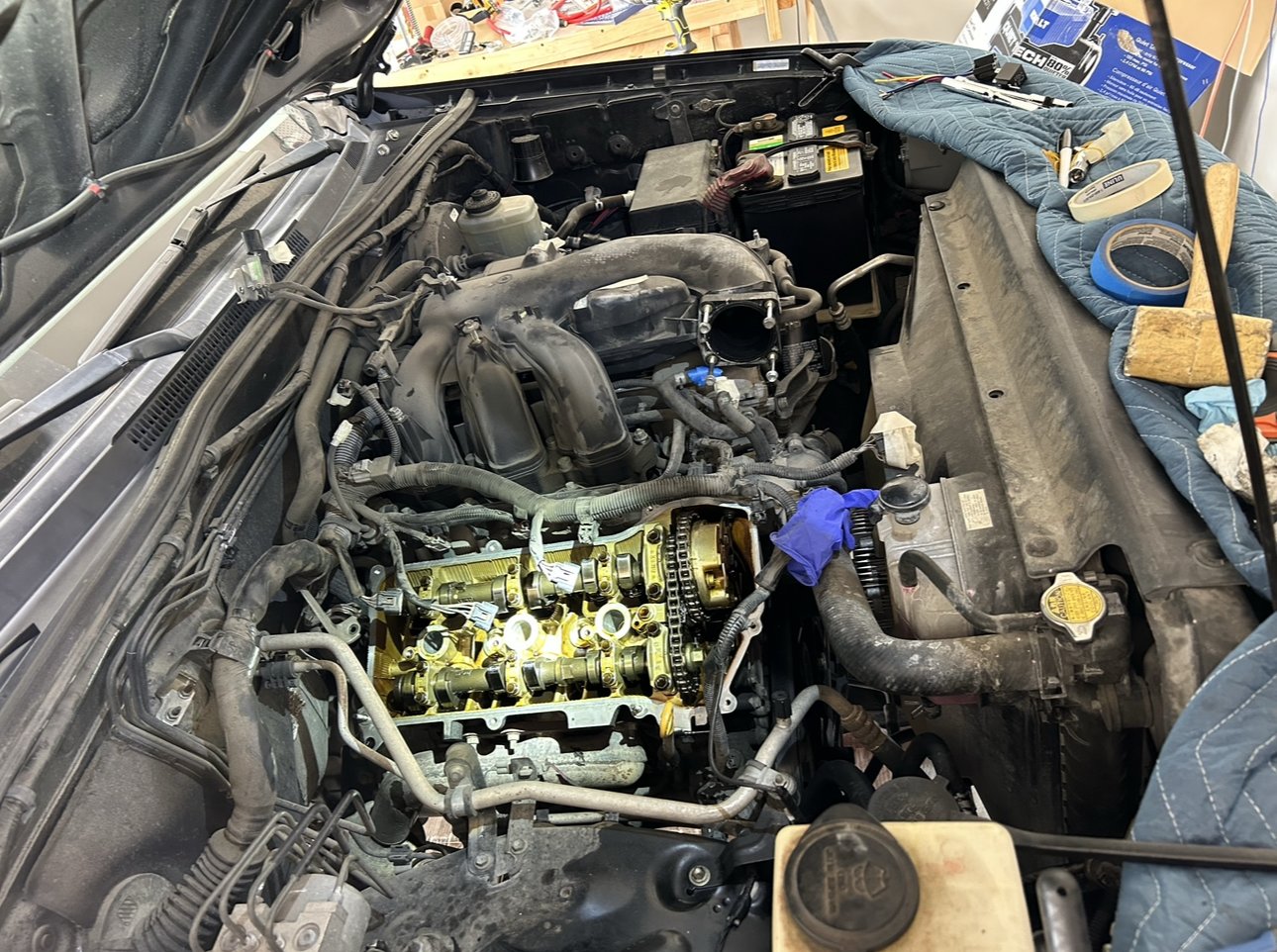

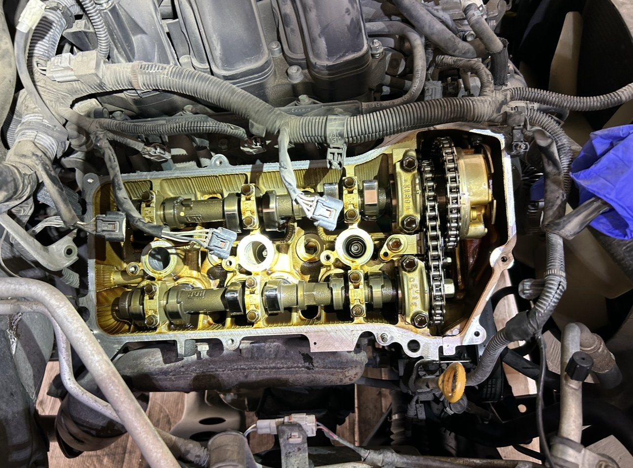

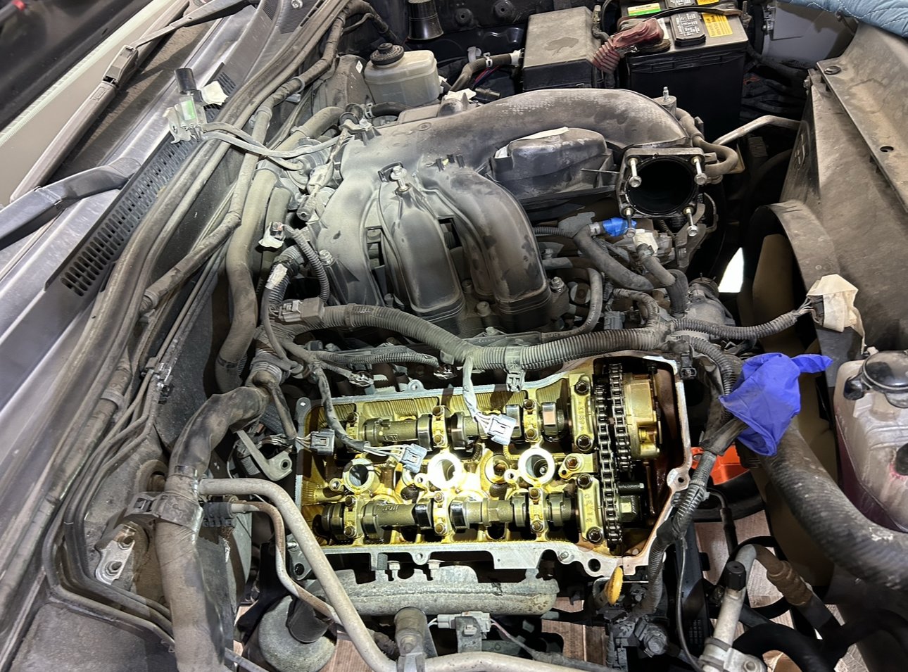

    160k miles on the engine. This is what my engine look like when I was replacing the valve cover gasket in 2023. I'm not saying my engine is perfect but comparing some people posting on YouTube when doing engine flush, I would say my engine is kinda clean when comparing to those in the video. If idling a lot, I'll change it at 3000 miles, if not, then I'll change it at 4000-5000 miles.

    Tarnishing doesn’t mean oil burning.
    this high mileage 1gr had no oil burning at all and looks much worse than yours.
    carbon on ring lands is not something you can see
