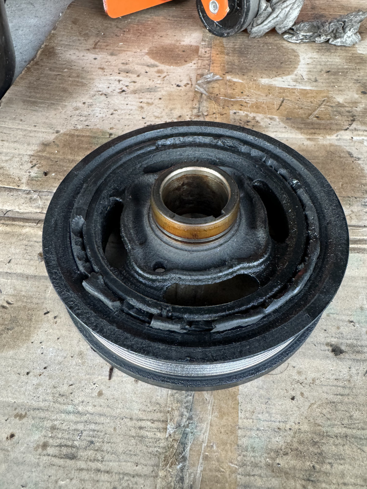

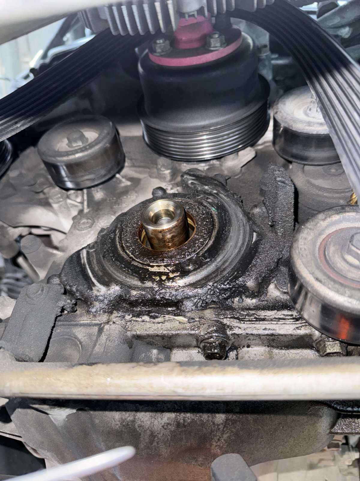

    Ok. I think I found the problem. Working to replace the front main seal now. Any recommendations on an aftermarket part for the crankshaft pulley, I think I need to replace it.

    From what I see, it appears you need a new seal and harmonic balancer/pully and I think I'd go OEM. You need to clean the timing case up to see if it has any damage and I would do that before ordering any parts. Plug the seal shaft area up with a rag or something to minimize anything getting in there. Use an engine degreaser. It appears the rubber damper from the harmonic balance has been rubbing on the case as it was deteriorating. If it's just rub marks I'd let it go, but if it has worn away metal I'd be suspicious of its integrity.
    I hope this helps.

    Update: I replaced the harmonic balancer with Dayco along with the front main seal. Will see how long Dayco's harmonic balance lasts. As of right now, it's 5000 miles and 200 hours of idling.
