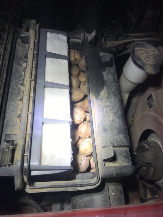

    Have you checked the cabin and intake930508EB-CBF1-45C9-B67D-8F66B120B449.jpg air filter?

    First thing I did, it's completely clear except the filter.
