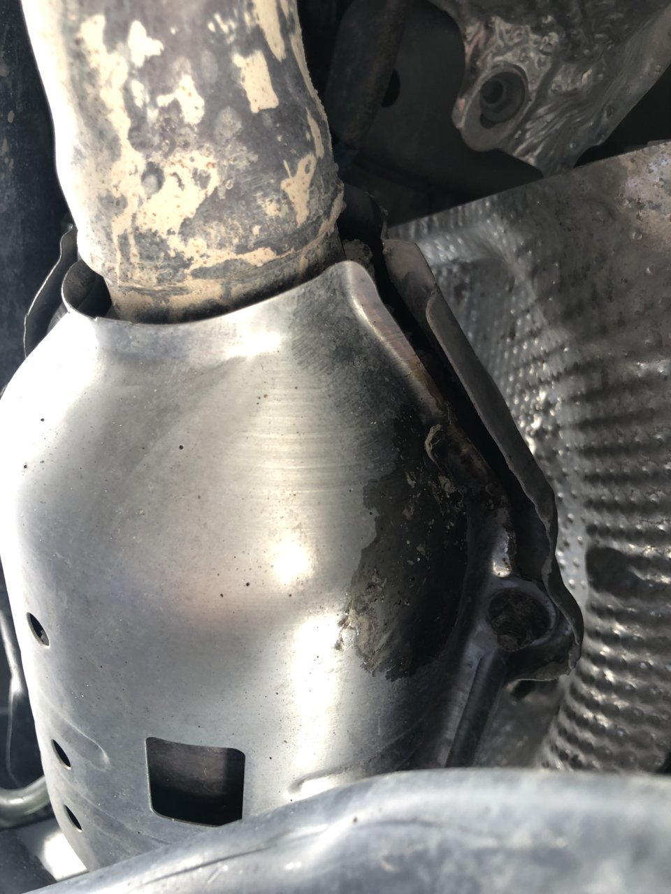

    May have found the culprit?

    Probably picked a bag or something on the road. Sticks instantly to a hot cat. Done the same thing. Wanna bet hot cat phrase gets a whole lot of comments unrelated to plastic bags

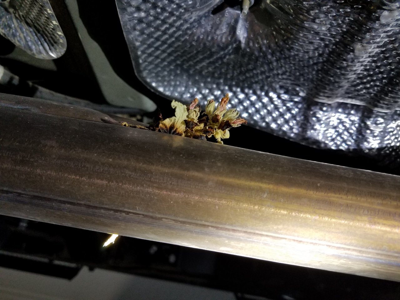

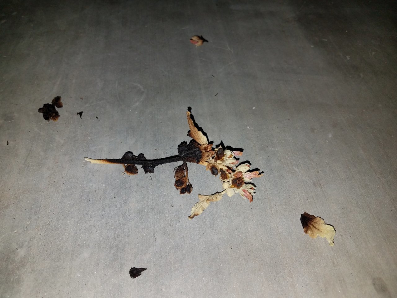

    This thread is awesome! Here's what I found under my truck that was causing a real nasty burning-garbage/brush-fire smell in my garage immediately after parking it. I initially thought it was a dragging brake, so I checked all the rotors and drums with a temp gun. All were the same'ish, so I found this thread, got the tip about something stuck on the exhaust, and viola!
    Roasted and toasted! This weed was wedged in near the Y-pipe area! With reduced mileage due to COVID, it never fully burned in the clear!
