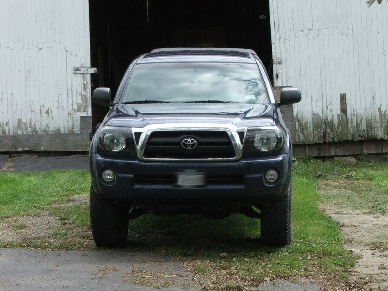

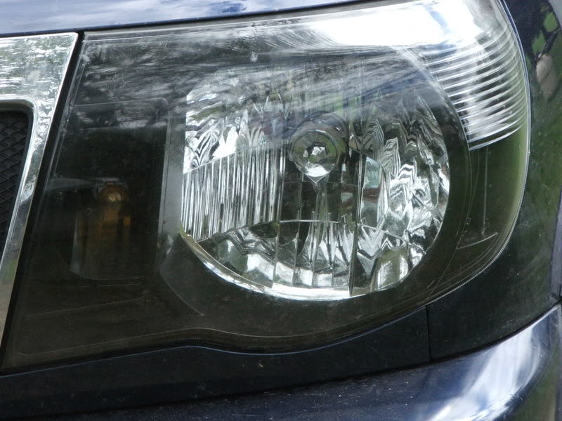

    I preheated my oven to 300, turned it off, set the lights in for 10 minutes each time on a piece of cardboard.
    Pulled the cardboard out with the light on, and was able to pull it apart without gloves. Kept moving my fingers, but it wasn't that hot! The cardboard helps the hot air heat the light rather than the hot rack potentially melt the light.
    result:
