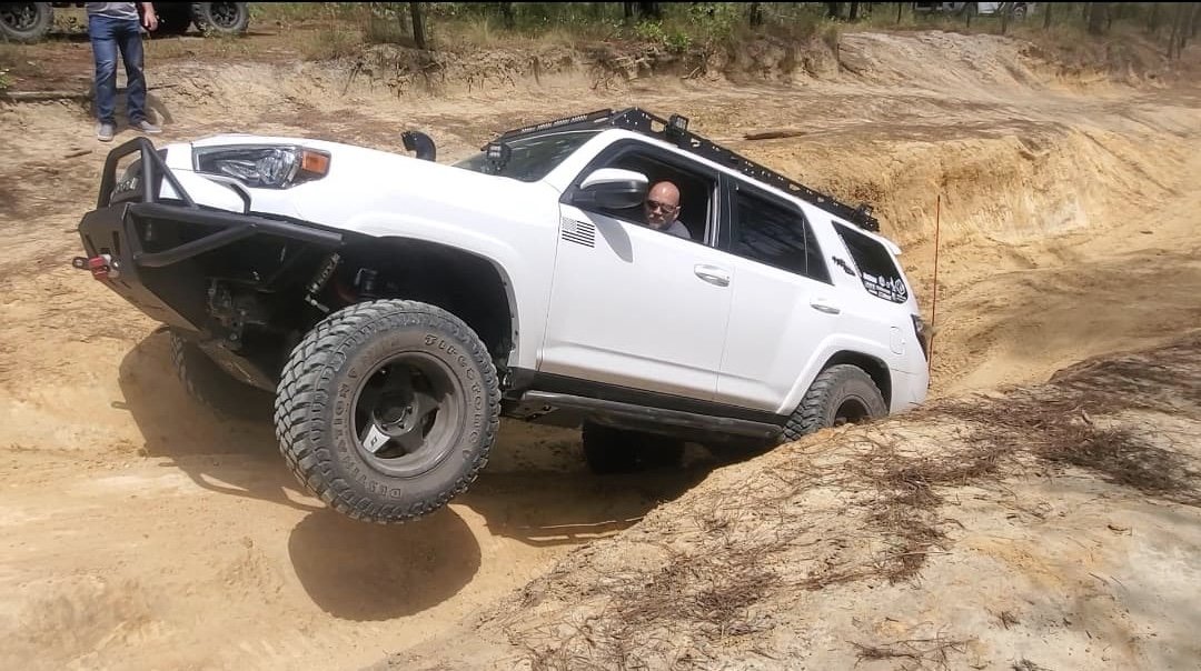

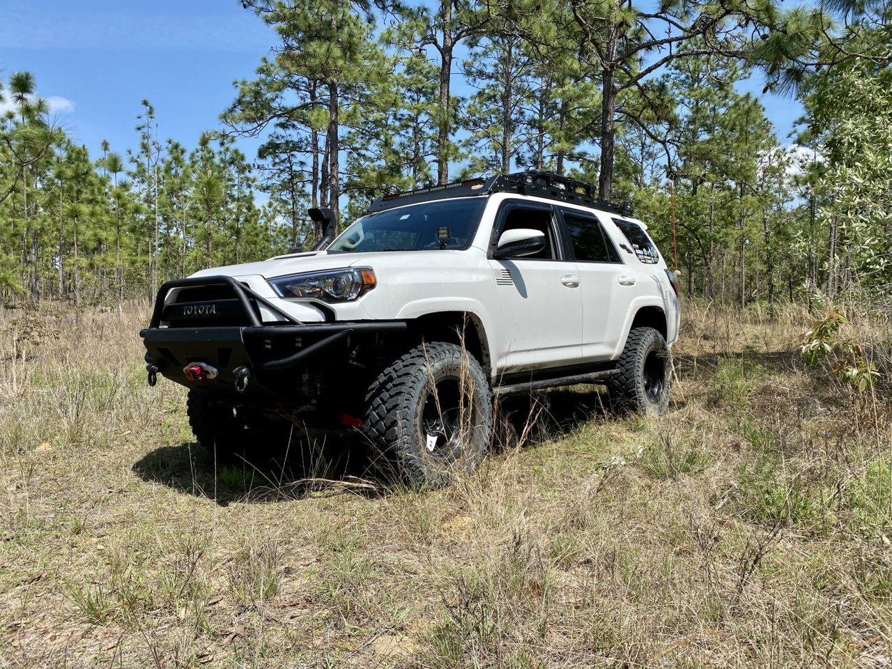

    The 4Runner is getting there...
    CB67C2D4-5D40-461A-8C1D-F59664EDF7A8.jpg CBDFA6C7-0571-42CB-AB51-4023589F5F6E.jpg

    Definitely. You're doing it right.

    Like a Boss!!! Very Nice.
