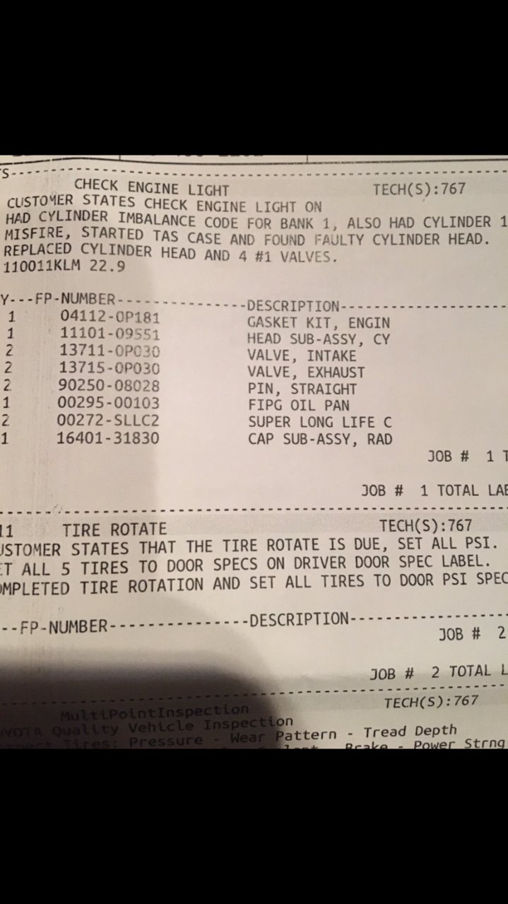

    Thats a pretty dramatic take on a mechanic/service writer relationship.
    I think its just the mechanic covering his ass.. he's been there a while and seen how these situations go down.
    Its true those trouble trees are long and boring, but following them to the letter is how the mechanic and the service writer stay out of trouble.
    And up in the front office.. Dealership managers/owners dont like getting sued. A high dollar failure has to be documented perfectly.. as in, written up exactly how the bean counters (lawyers) want it written. That means no skipping steps. Service writer "initials" where he is instructed to, same for the tech.
    An "official" diagnosis like the one OP posted reads like lawyer-speak for a reason..

    2020 Taco TRD PRO
    What pisses me off that IF I had to to that on my own I would replace ALL of the valves and service the head.....
  14. Oct 29, 2020 at 9:08 AM
    #114
    b_r_o
    b_r_o Gnar doggy
    Nov 17, 2016
    #202672
    14,538
    Alex
    WA
    2015 DCLB
    Pretty sure that 11101-09551 is a new cyl head sub-assembly. Looks like they swapped the good valves over to the new head and replaced the damaged valves

    Trd pro grill
    On mine they swapped the good valves over to the new head. The mechanic took me in and showed me the bad valves and exactly what he did to fix it. He also said he has done five trucks with same problem. Said he wished toyota would allow him to replace the other side so he does not have to tear my truck apart a second time when the other side has the issue.
    CrufflerJJ and Superdave1.0 like this.
  16. Oct 29, 2020 at 2:54 PM
    #116
    Pg350
    Pg350 Well-Known Member
    Dec 14, 2018
    #275840
    127
    2018 4x4 SR5 Tacoma auto
    Trd pro grill
    He was told by toyota that faulty valve guides are possibly to blame. He said they send the faulty heads back to toyota for examination.

    2016 Quicksand DCSB OR MT
    Reviving an old thread. I have this issue on Cylinder #2 after 143,000 miles on a '16. Compression test showed almost 100psi low in cylinder 2.
    Upon disassembly it was determined that the cylinder head (and 4 valves) would need to be replaced, totaling ~$6K as mentioned before in this thread from others.
    The concern here is that the other bank could end up with the same issue. Unfortunately this is well out of warranty so I'm on the hook for the full bill.
    Dealership was able to locate a used engine with 33K on it from a '17 for $9K installed. Given that I plan to keep the truck that seems like the best option.
