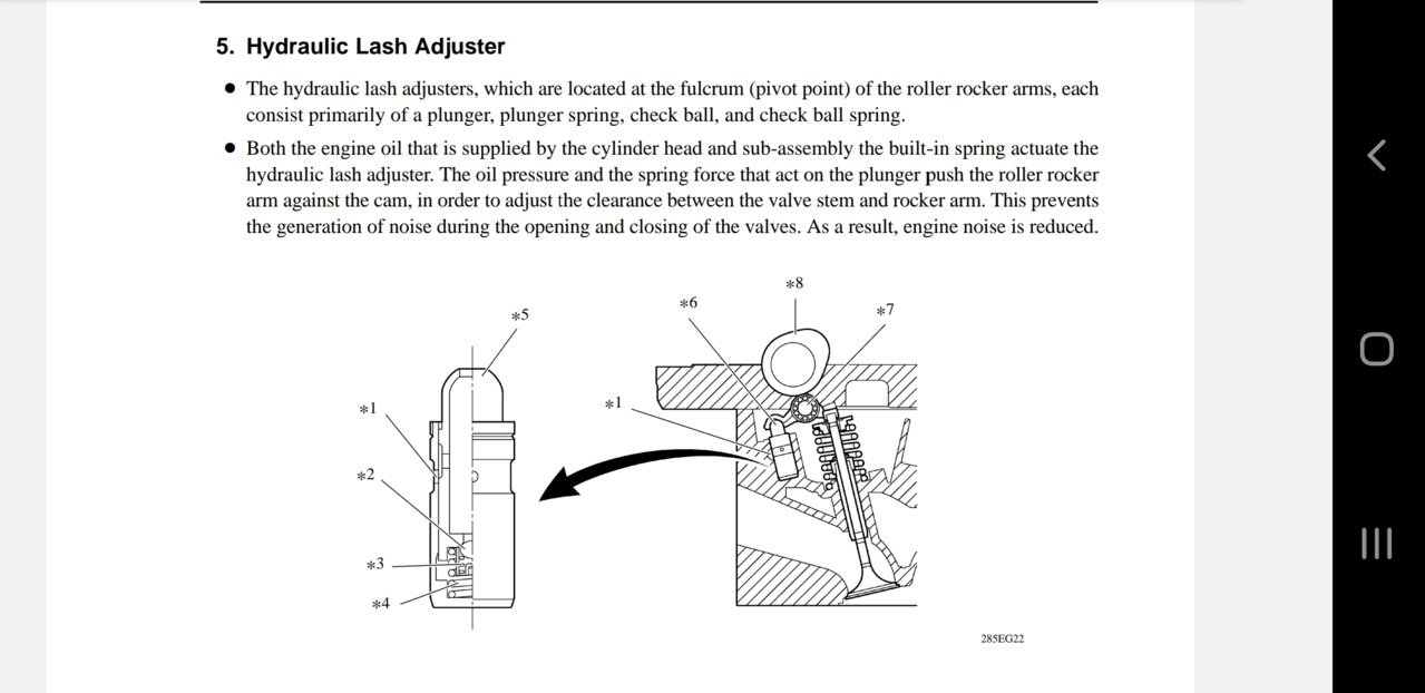

    Don't these motors have hydraulic lifters?

    4X4 SR5 V6 6spd
    Well I believe 4L in essence it is a shim valve engine. The actual bucket is the shim they are different sizes. The point still stands has any one checked the clearance? No matter how it's made a tight clearance will cause issues.

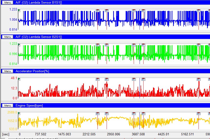

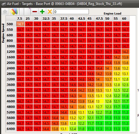

    our tacomas don't run lean.
    Here is ECU target AFR table for Port (same for Direct). There are no entries above stoich AFR.
    Here is the real time AFR. Spikes to 1.233 (18) when you off of the accelerator (fuel cutoff). Fuel trims constantly being adjusted to maintain AFR. As you can see, there are no constant lean conditions. You will find running below 1.000 80% of the time if not more.
