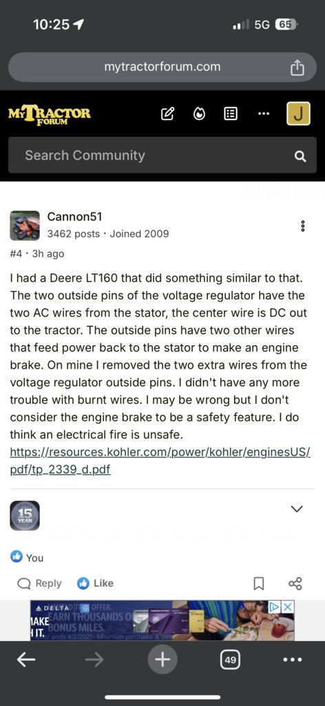

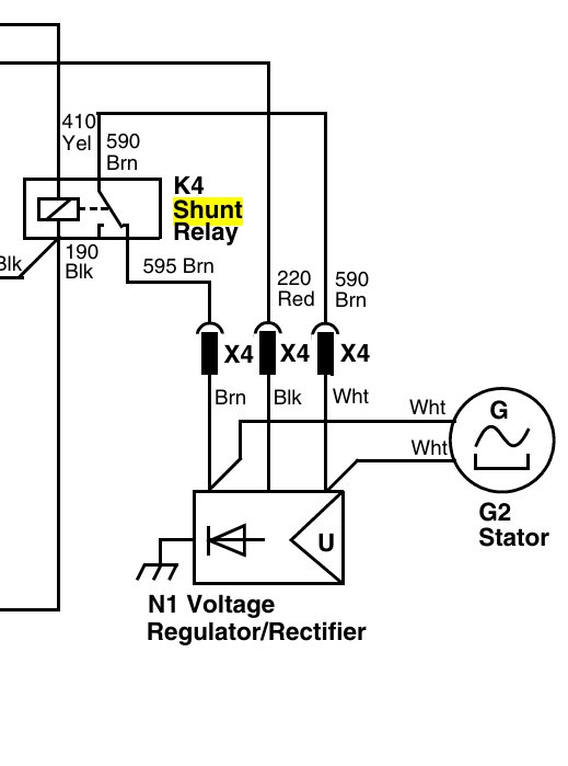

    So I am being told to disconnect the two outer wires on the voltage regulator because these just have to do with a safety engine shut off. Here is the post. Is this correct? IMG_2257.png
  8. Mar 12, 2025 at 8:12 AM
    #28
    TnShooter
    TnShooter The TacomaWorld Stray
    Sep 2, 2010
    #42625
    21,136
    Deogee
    07' TRD Off-Road, Auto
    STOCK
    If the shunt relay is working properly, the wires should not get hot.
    When you turn the key off. The shunt relay places a load on the stator, with in turn places a load on the engine.
    If the shunt relay is bad, wired incorrectly, or the wrong relay is used, then there is a continues load on the stator and wires.
    This can cause the issue you are having.
    I'd just cut shunt relay wires and call it done.
    All that will happen is that the engine doesn't stop as fast when you turn the key off.
    It will be the Brown wires you need to cut.
    NOT THE WHITE WIRES. The white wires are what charge the battery.
    In your case, you may need to trace the wires to the shunt relay, since someone has fooled with the wiring.

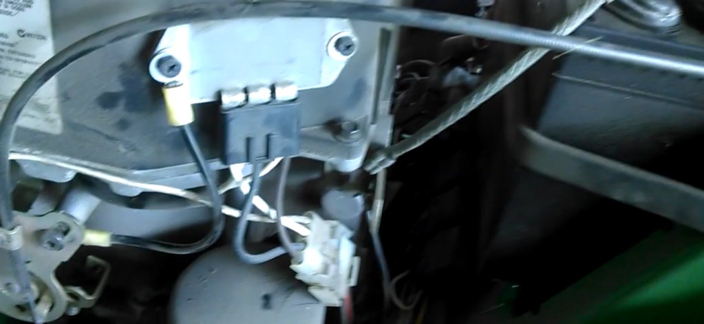

    so I found this on YouTube. It gives me an idea of what things are supposed to look like this is a LT 150.IMG_2254.png
    TnShooter[QUOTED] likes this.

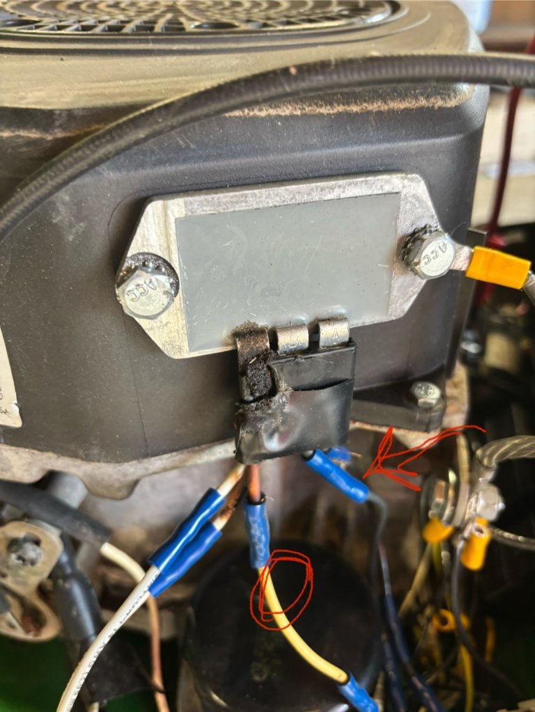

    On the 2 outside pins of the regulator, there will be 2 wires on each pin.
    One wire on each of the outside pins of the regulator will go to the 4 pin connector.
    Those should be the ones to the Shunt Relay. Cut those.
    The other 2 wires should be going to the engine.
    As long as you don't cut the wires that are going to the engine, you should be fine.
    (if you did, the battery won't charge)
    The center pin on the regular sends power to the battery. (Charge wire).
    Don't touch it......

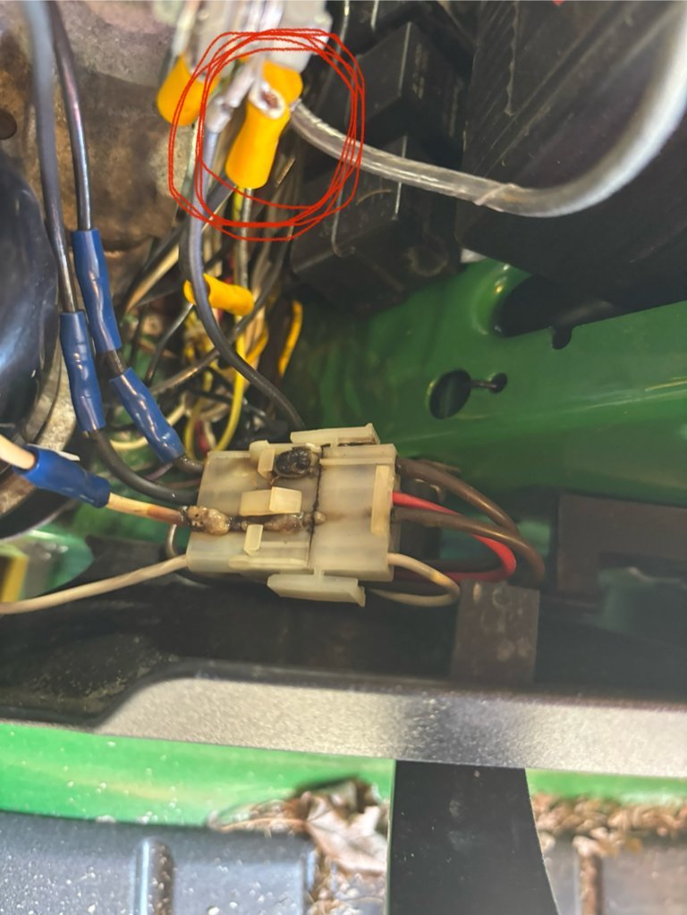

    So the wire I circled and the wire behind the one I have an arrow on (can’t see on the pick) there are 5 wires in total.IMG_2243.jpg
    This is the wire that is frying the white plug. Never mind the red circle here was for a different question

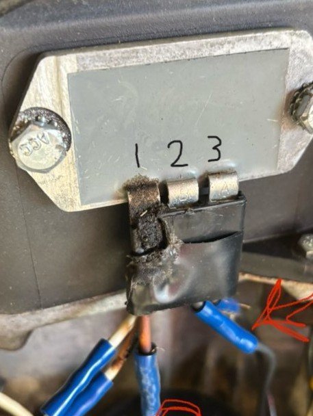

    So I see two brown wires on the opposite side of the plug….maybe cut these?IMG_2258.png
  13. Mar 12, 2025 at 8:57 AM
    #33
    TnShooter
    Sep 2, 2010
    #42625
    21,136
    Deogee
    STOCK
    In this picture, It look like you have 3 wires coming out of the LEFT pin. Pin #1
    If so, that is wrong.
    It should be,
    Pin 1 has 2 wires. (- One going to the engine. The other to the white connector-
    Pin 2 has one wire - Charge wire
    Pin 3 has 2 wires. -One going to the engine. The other to the white connector-
    We need to start there.
    Because if it isn't wired correctly, cutting the wire won't help.
    (well, it will if we cut the right ones) But we need to know what ones are the right ones.)
    For now, lets see what we are working with.
  14. Mar 12, 2025 at 8:58 AM

    Cutting the correct ones should be fine.
    I mean, the burnt connectors are no ideal.
    But as long as they make contact, they should be fine.

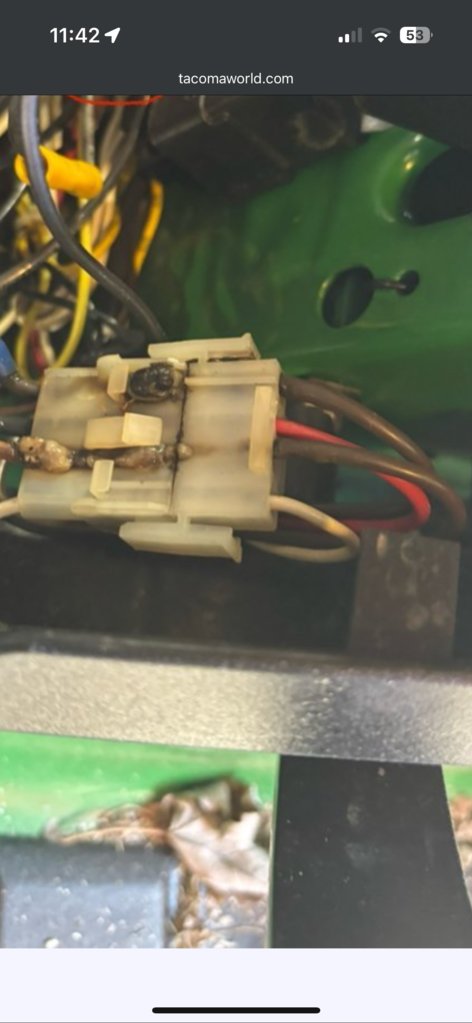

    OK so I removed the duct tape. connector is definitely toast. I also found more wires that have butt connectors on the other side of the lawnmower and they have them nut screwed toogether for some reason. I do have a small engine shop that has a used wiring harness. I talked to John Deere. They have them new for about 400 bucks. They said it’s plug-in play. the used ones about 55. so I don’t know whether to go that route or just cut the wires that you are referring to. I personally would probably like to replace the whole thing. That would make sense.IMG_2262.jpg IMG_2263.jpg IMG_2264.jpg
  20. Mar 12, 2025 at 3:27 PM
    #40
    TnShooter
    Sep 2, 2010
    #42625
    21,136
    Deogee
    STOCK
    Wow.....That's the typical backyard hack stuff that I hate seeing.
    You got a lot rewiring to do.
    If you can get a used harness for $50. That may be the easiest route.
