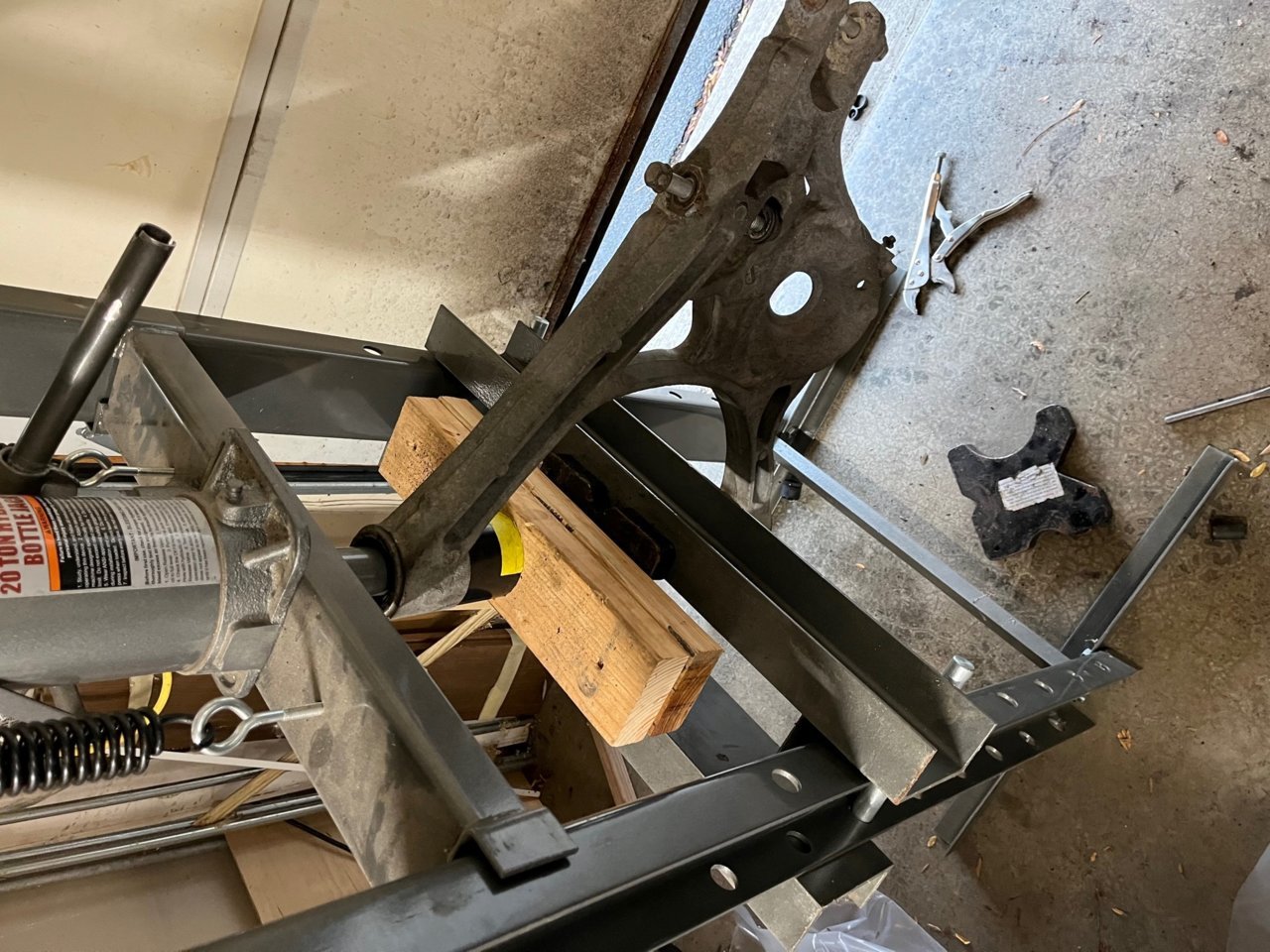

    No experience with doing them on my Tacoma, but I helped with a friends Chevy 2500 and the only thing that works was to pull the control arm off the truck and use a hydraulic press from HF (so basically your bottle jack method).

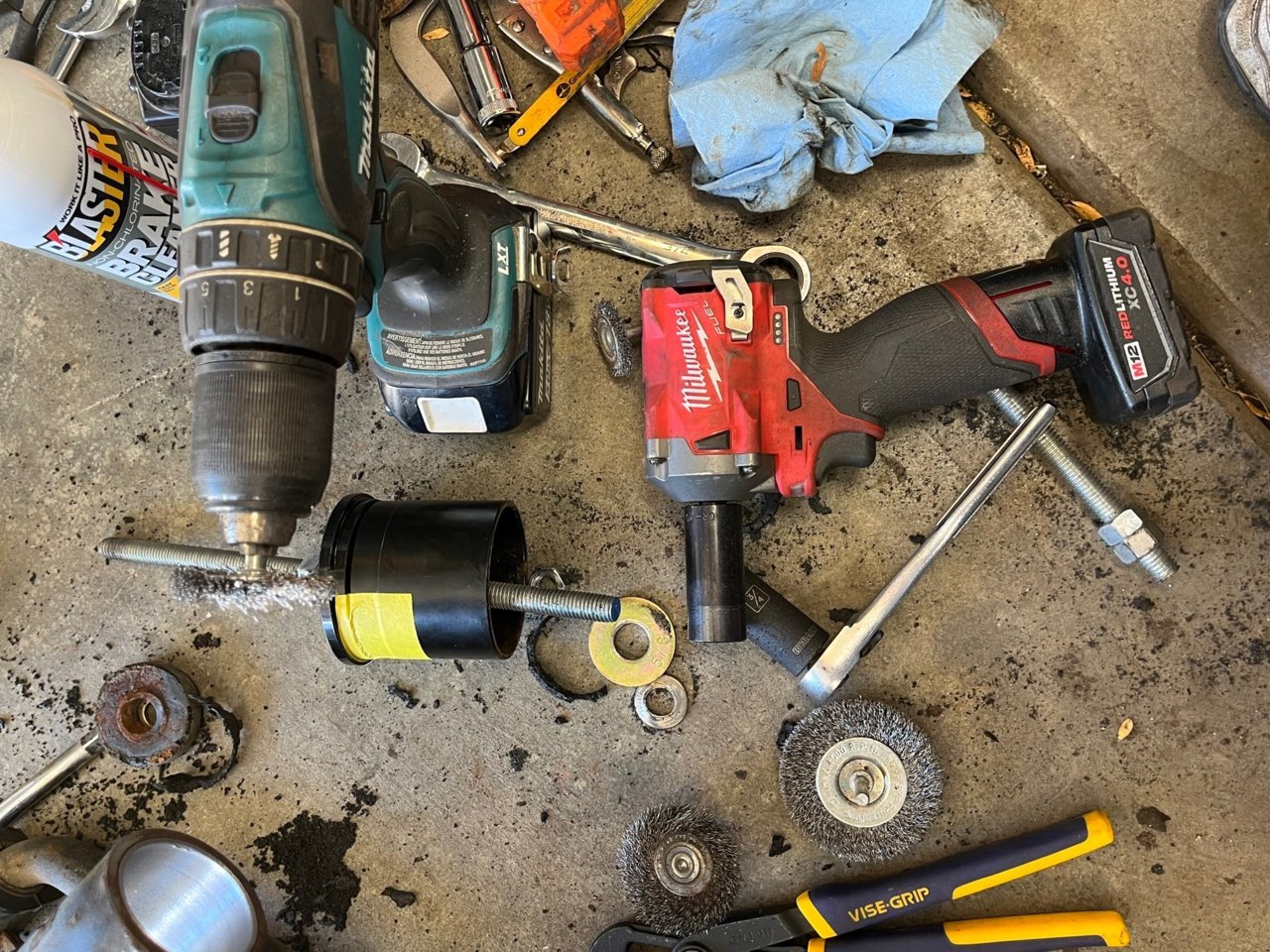

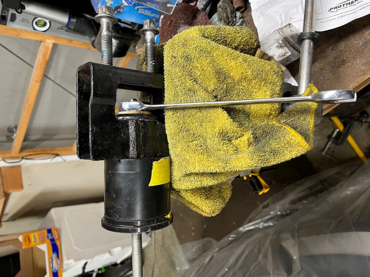

    get some 1/2" threaded rod, 2 oversize washers and 2 nuts. You have yourself a cheap bushing press. Make sure you lube the bushings good.

    I recently rebuilt the rear suspension in my Mustang and had to replace almost 20 bushings. The HF press was a huge help and made things so much easier. For larger parts (IRS subframe) and smaller ones I couldn't use the press for I made a tool like above mentions. Worked well too but not as easy as the press.
    Double check the size but they make premade tools that will probably work for you. https://www.maximummotorsports.com/IRS-Subframe-Bushing-Removal-Tool-1999-04-Cobra-P496.aspx
