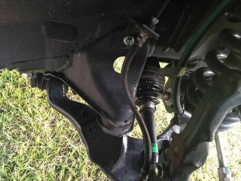

    My CV boot looks like it was rubbing together and finally got a tear in it and now is shooting grease everywhere. Will this harm anything leaving it like this other than having to replace the axle eventually?
    Also, whats a good option on replacing it with maybe a boot that won't touch the grooves and wear down and bust again? Is there one thats a cylinder/circle shape? Any info and links etc on a better axle with a better boot would be greatly appreciated. Anyway to just replace the boot easily?

    Lifted? That is a common issue with lifted trucks. If left you will need to replace the axle as the longer it goes the more debris gets in and wears the CV bearings. I'm pretty sure they do make heavier boots.

    Not a hard job to accomplish at all, just messy. I wouldn't even bother opening up the outer boot to swap unless its showing wear as well. Toyota also makes a kit that includes the grease etc and you can slide the boot out so the fins don't rub before you re-clamp.

    They say that adding a diff drop on the second gens barely makes a difference in the CV angles, it rotates the differential instead of actually dropping it down like it should. From what I have read, you can slide the boot further out on the axle to pull the fins further apart and prevent them from rubbing. I would go this route if you are just doing it to prevent future issues.
