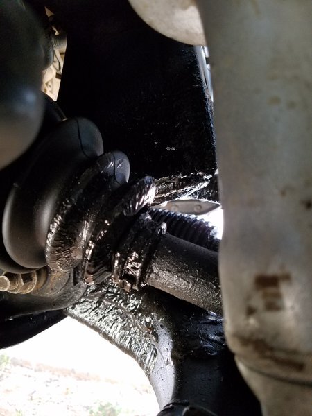

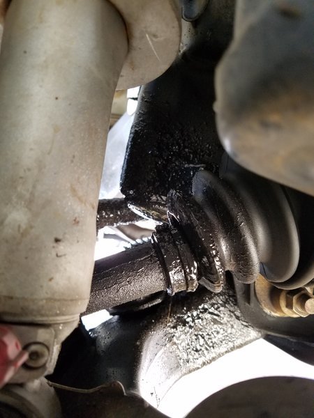

    I have my second busted boot on a front factory CV joint since I have had my truck "15 years" and my question is: should I put a new boot on the shaft or replace it with a whole shaft from autozone or oriley?

    The boot to gave out yesterday. It's 90% still intact. It's just got grease slung around my frame from the inner boot. I couldn't locate the actual hole on hand inspection so I am thinking it's still very small.
