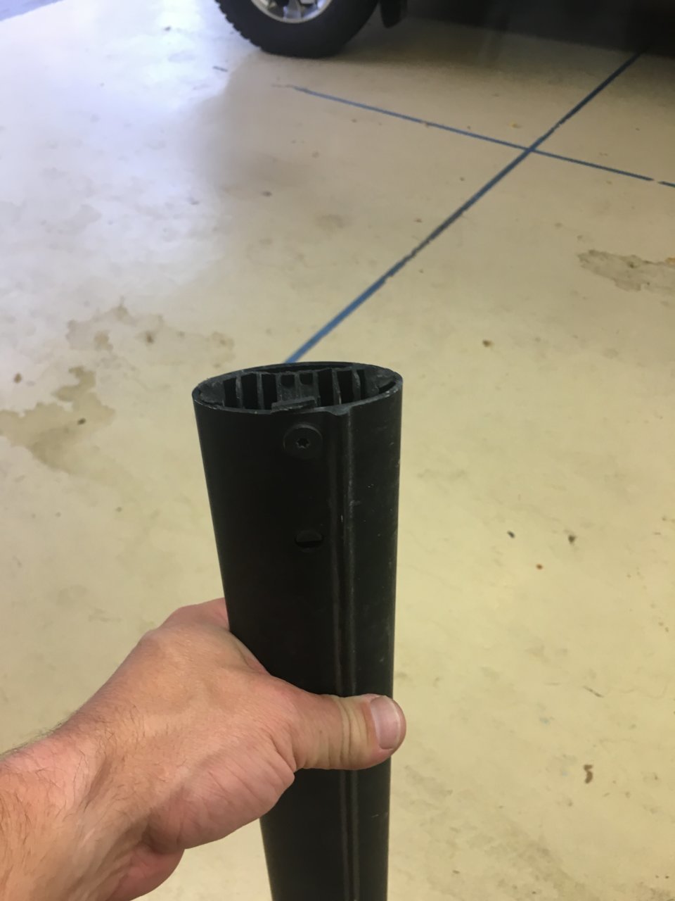

    So I was one of the guys with an awning mounted to my OEM roof rack, utilizing Yakima 39h bar mounts and ARB awning brackets. First was the 55” CVT with no issues, and now, for a longer trip, I moved the 2500x2500 ARB with awning room to the DCSB only to find an odd failure. I assumed if I hit something with the awning the Yakima 39h plastic bar mounts would be the failure point. I was wrong. After catching a tree branch under the awning, and the resulting upward pull, the end of the load bar itself failed, separating the bolted (torx) end from the bar in a snap. Yakima 1, Toyota 0.
    So, looking for some assistance from anyone out there that might have a parts guy that won’t insist that there is no ability to only order the complete rack. The ends are replaceable. There is a screw and a tab. Part numbers are in the schematic but I can’t get a quote out of my dealer.

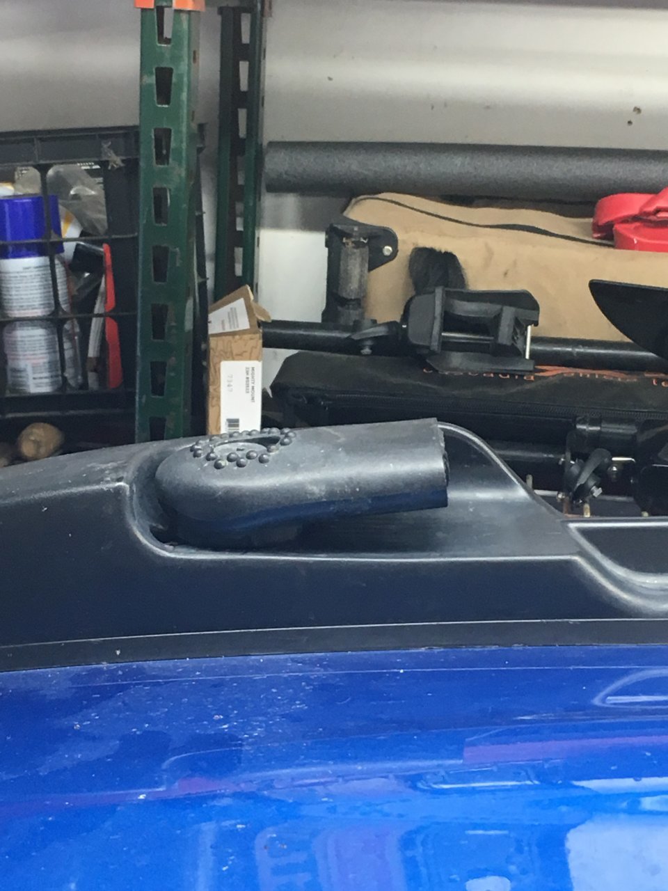

    Access Bed cover, Access tailgate gasket, OEM Roof Rack, Garmin 780 12V bed outlet mod 120V in the console mod "Don't steal my tailgate" mod Yakima Lowrider rack mounted to OEM rack with Thule Cascade XT carrier Avid Arctic bar SOON TO COME - OME 885 lift kit
    One more of the end still bolted to the truck.

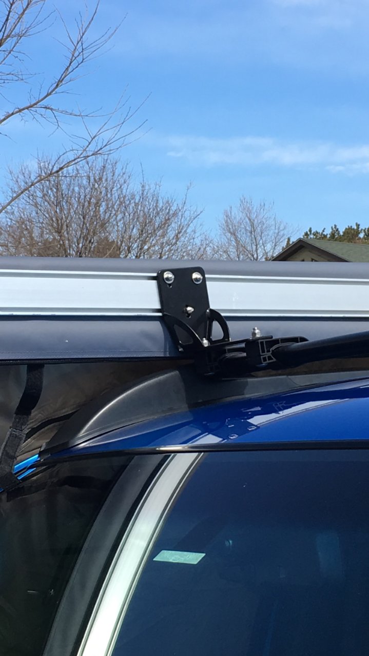

    huh... thought there would at least be some good-natured ribbing as to the use of an 8' awning on an OEM rack.
    Here is another closer photo of the Yakima 39h Mighty Mounts on OEM bars.

    @gunny1005 , Thanks for the fast response. If the end of the crossbar broke off, wouln't I want to order
    PT278-34050-CB Each $180.98 $180.98
    $132.75
    Roof Racks, Cross Bar Set w/Hardware
    I appreciate you providing your contact info. I will reach out today and discuss! Thanks!
