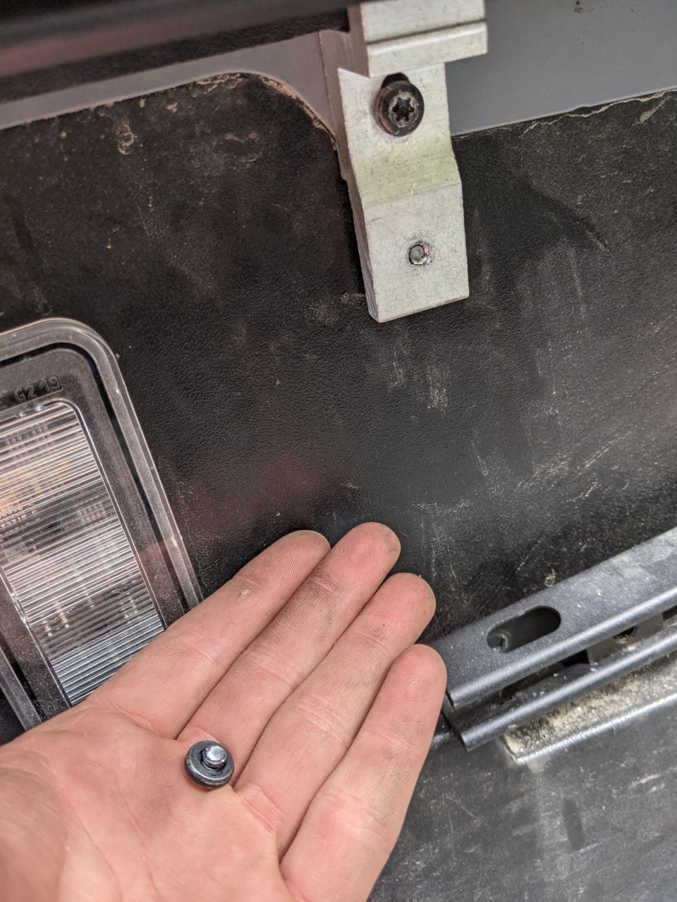

    Anyone ever have to replace a clamp from an MX4? Was taking off my cover to install some bar bars and when reinstalling the rail, a screw broke off in one of the clamps. Super annoying. I'll call em on Monday for replacement parts but figured I'd try yawl first. Fortunately it didn't break off in the screw hole, just the clamp.

    Multiple ways to deal with it. For example, you can remove the clamp from the truck, then spin out the screw stub with a drill bit. You can also heat the bracket in an oven (aluminum expands more than steel) or dissolve the screw with alum, but it isn't worth the effort to do anything more, as the clamps are pretty cheap and common across multiple tonneau/topper brands (all of which are owned by one company...)
    Spray some Fluid Film on the screw threads when you install the new clamp.

    Fluid film looks great, just ordered a six pack.
    Gonna try and drill out the stub ... its really small, shouldn't be a problem. Tomorrow, not today, hah. Seems to be plenty of solid after market clamps out there too, but this MX4 one looks proprietary, can't find any that resemble it on Amazon (with the accessory rail attached).

    Is there any of the bolt showing through from the backside of that bracket?

    If so you could just grab it with a pair of vise grips and spin it out.

    Nope, none at all - it snapped cleanly within the clamp!

    Oh ok gotcha well then you are stuck with extracting it...if you are lucky you might be able to spin it out with a center-punch. Good luck

    If you aren't going to simply replace the bracket I would drill the broken bolt and use an easy-out----with a little heat. Even a handle held propane torch.
