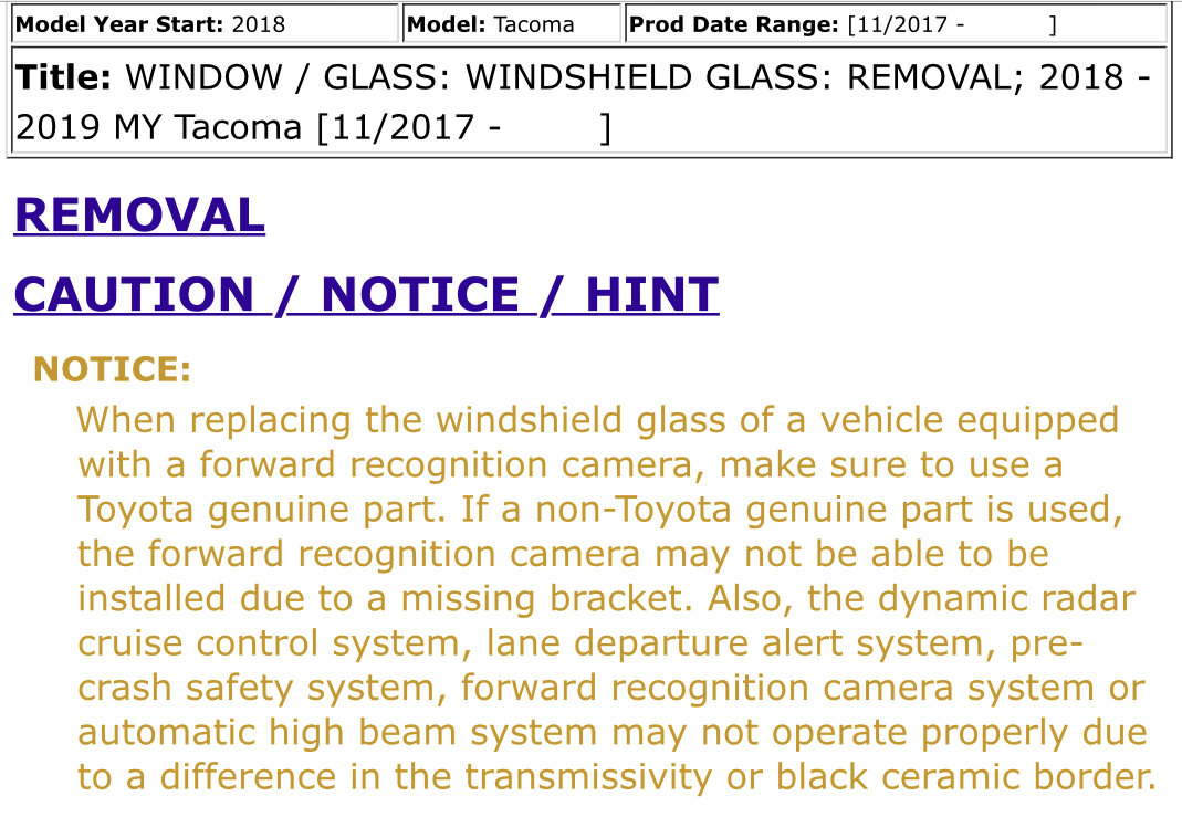

    Thank you all for input. After the advise on here, glass company, insurance company and the dealership, I’ve decided to go with Toyota glass. With the new sensors in the windshield and calibration factors, it’s not worth the risk for me to take the chance of having problems with aftermarket.

    17-up you need to go OEM.
    Even tho companies like pilkington make the OE glass, there is a recognizable difference between the glass they make for the OE and as a non-OE replacement option
