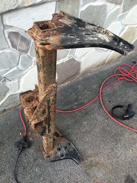

    Get photos of the frame and hitch before you go. It will be clearly evident if it has a rust problem. Here's a photo of my frame-recall truck. They leave the hitch alone so it's a good indicator of what the frame used to look like. Also make sure it has the tow-package from the factory. You'll get the upgraded battery, alternator, oil cooler, trans cooler(auto only), and class IV hitch rear bumper setup. Important when you'll be constantly hauling 1000lbs in the bed.
    You also need to ensure the thing is wondering/pulling going down the highway. My frame-recall truck has issues with being aligned. I have a permanent pull to the right that no one can figure out. They thing it has something to do with all the components that were swapped during the frame service. I've had everyone from Toyota to the best commercial alignment garage in town look at it and they are all stumped.

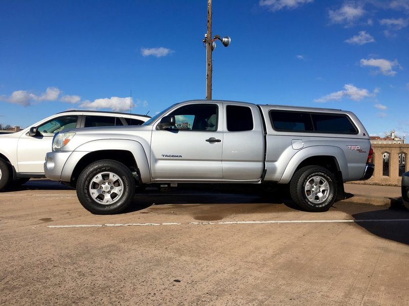

    I'll also include a photo of my truck with a Leer 100R camper shell with brand spanking new leaf springs. It's almost sitting level. now imagine 900 more pounds back there.
