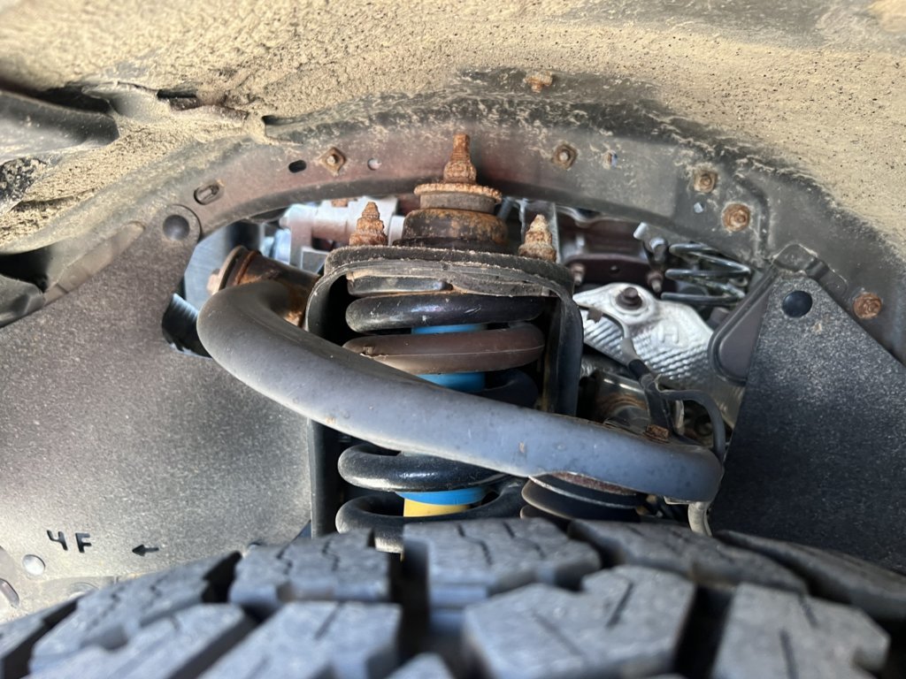

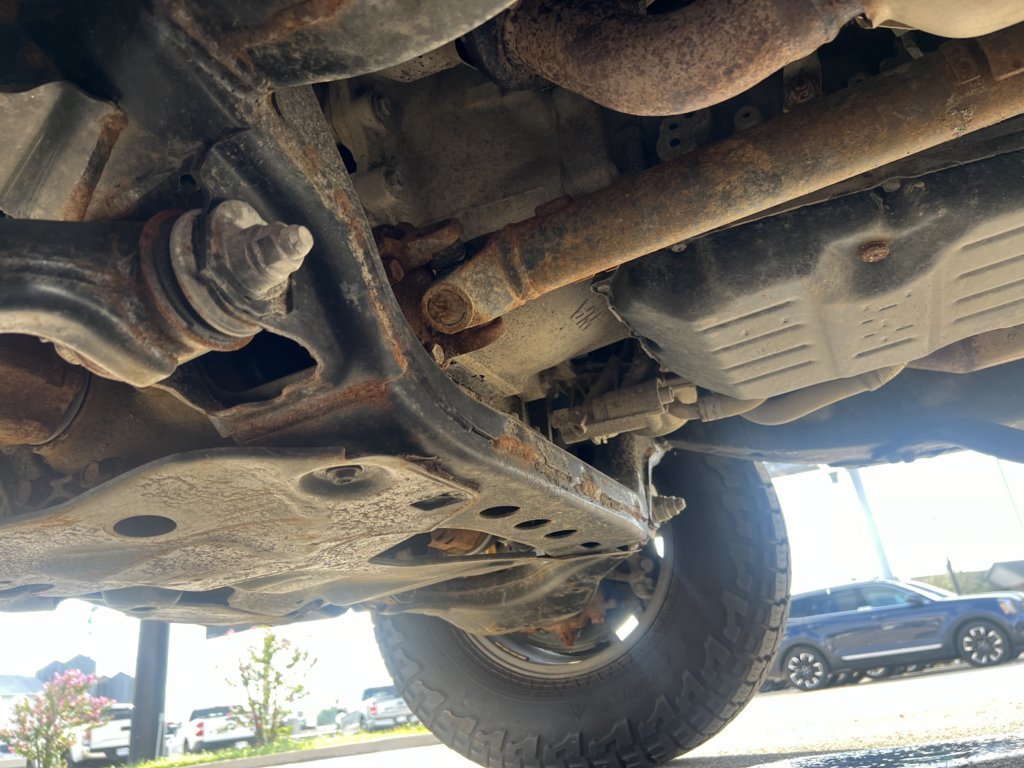

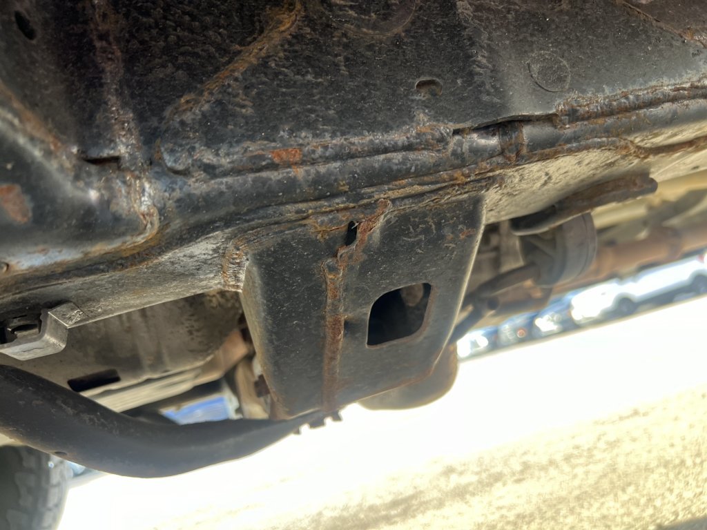

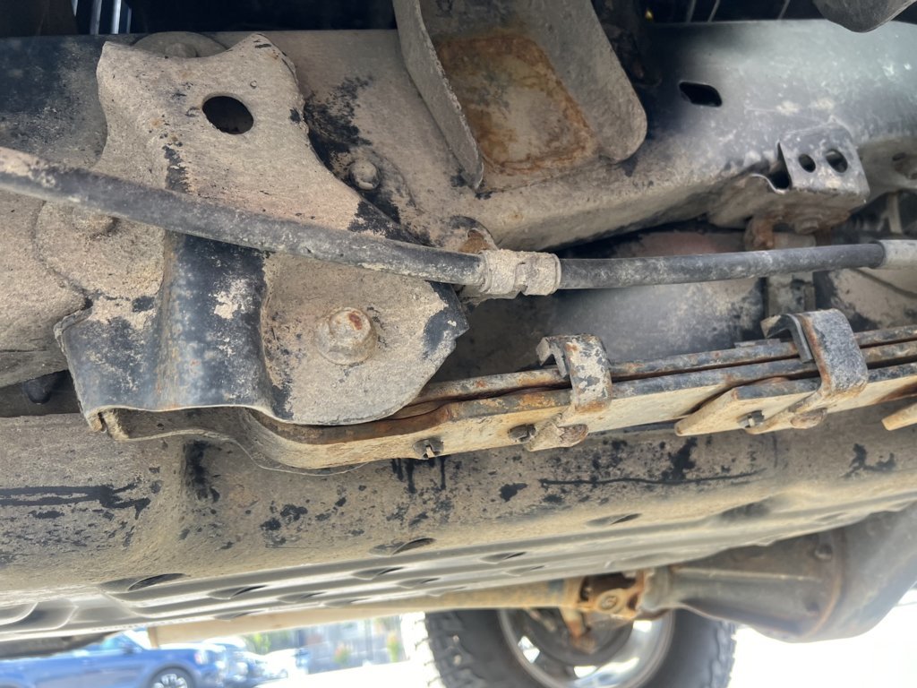

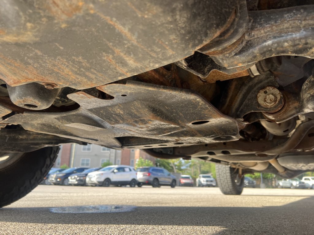

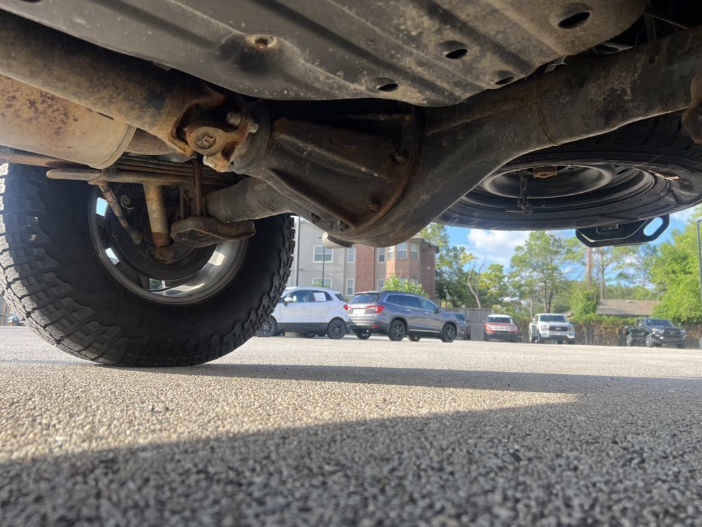

    Looking to join the ranks for the first time. Evaluating an otherwise nice, low mileage TRD OffRoad that started life in Maine but has rust issues. My intended use is a Texas hunting rig, solid on the interstate, capable & dependable on rough trails from Mexico to Kansas.
    Love to benefit for your experience - Should I consider this a solid enough truck, or keep looking? Thank you in advance!

    You'll get different opinions. That's a lot of rust for a 2 year truck imo. I'd keep looking.

    Fluid Film or other undercoatings really help to prevent and minimize the rust.

    I’d wash the underside more, hard to tell if some of that is dirt or rust in some areas. I’m leaning towards pass currently and keep looking.

    While that rust is mostly surface rust (or so it seems) and probably not structural, it is just a matter of time before it gets there. Rust is like cancer. And that does seem like a lot for a 22.

    Yeah, that looks significantly worse than my 2018 (that has been washed occasionally but never been treated), and it appears there's a lot more bubbling up from underneath the paint.
    IF it's a GREAT price for the mileage and you will be keeping it in southern areas like you say, it might be worth it, but I personally would keep looking.

    Nothing I see is concerning. Id say thats about normal for a "new" and untreated vehicle here. As unfortunate as that is..
    If you get a good deal on it and are willing to put a day or two of work into it cleaning, rinsing, and Fluid Filming the entire underside (including inside boxed sections of frame etc) Id say go for it. If you'd rather not put any work into it, as others said above Im sure you can find a similar truck from a different part of the country
