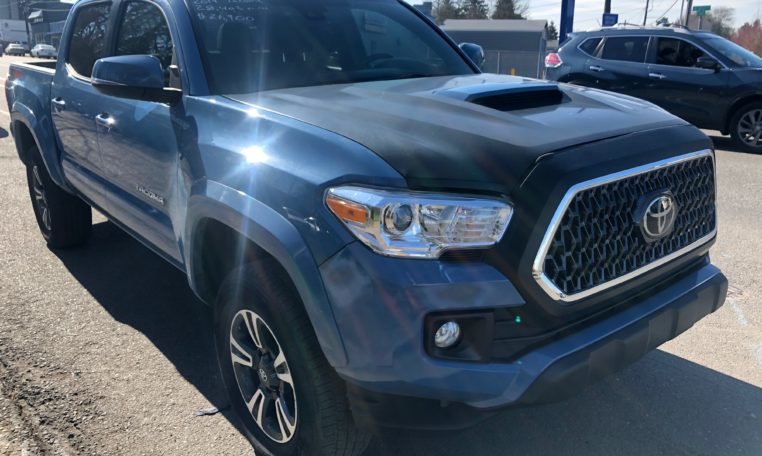

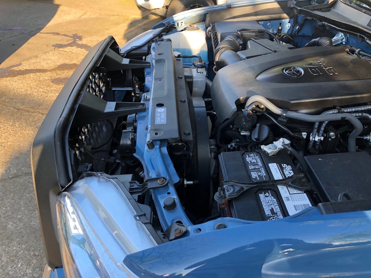

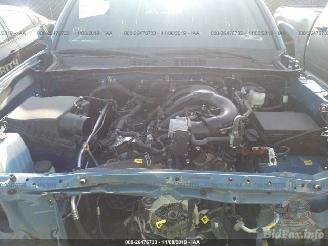

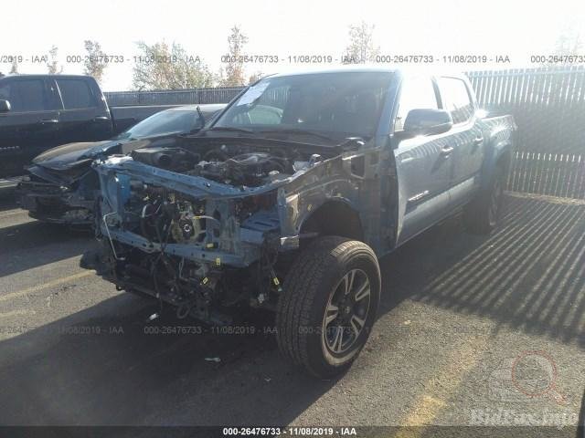

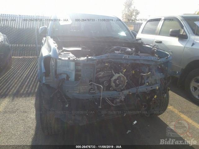

    Give me the vin and I'll give more info on it. Somethings not right. Look like the "before" photos is not the actual damage. I don't mind salvage but this particular one doesn't looks good.

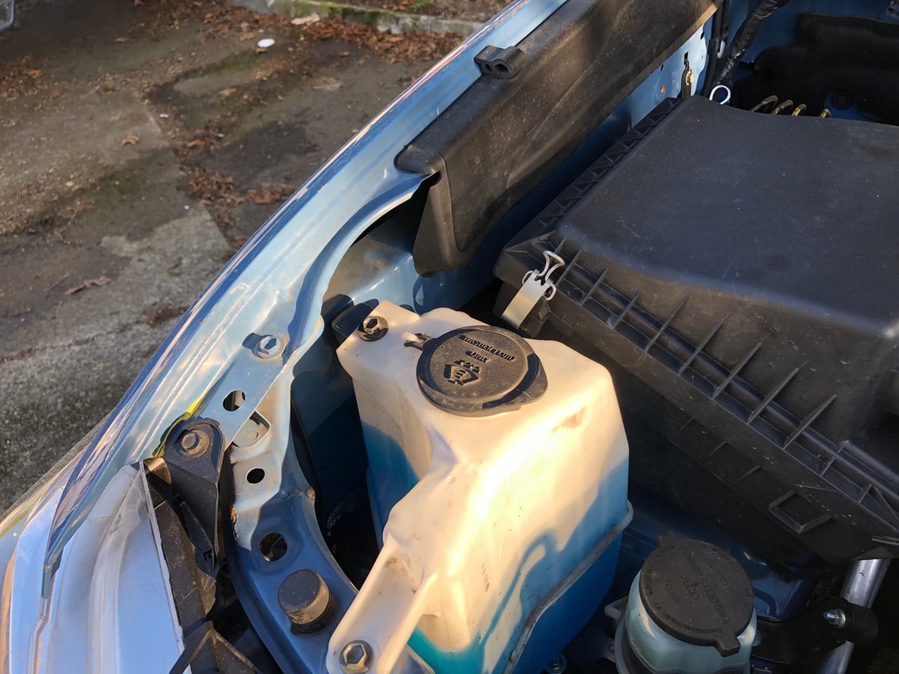

    Hellllll no. Looks like some shoddy workmanship to me. The front grill surround is misaligned with the hood, panels are left unpainted, the radiator support crossmember is all dinged up meaning it was never replaced, fasteners are missing in the engine bay, I could go on... It's one thing to buy a salvage vehicle from a reputable shop that fixes it up right but that thing has nope written all over it. Heck, even in a vehicle repaired by a good shop there could still be some underlying damage that went undetected not to mention you're gonna have a hard time if you ever want to sell it since most people steer clear of salvage title vehicles.
