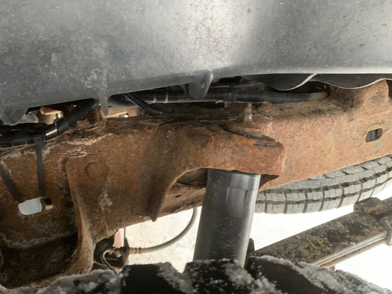

    Is this rust concerning? Looking to purchase for a good deal

    That's a hard pass in my book

    Frames rust from the inside out, as bad as that looks on the outside the inside is even worse. You could probably find holes in that frame just by tapping it with a ball peen hammer

    That thing has nature's loctite all over it
