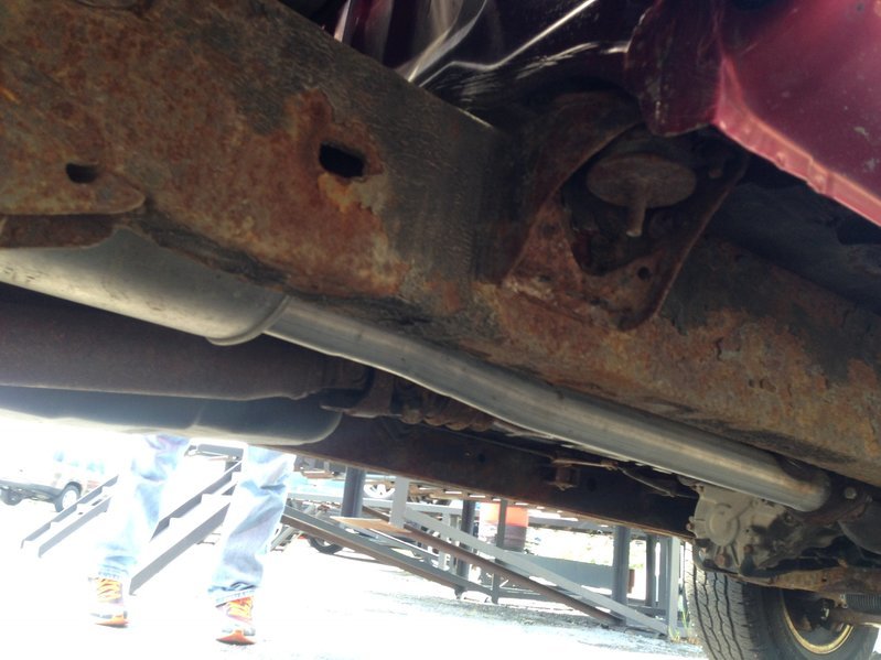

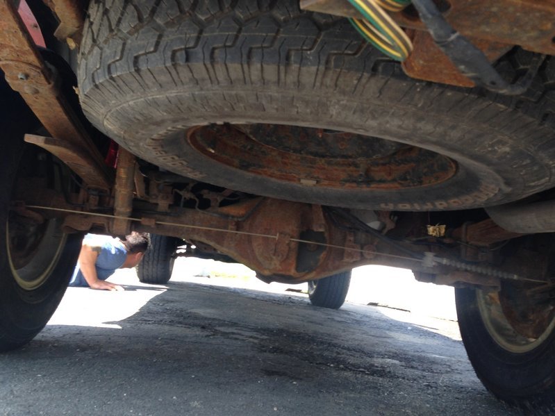

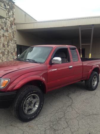

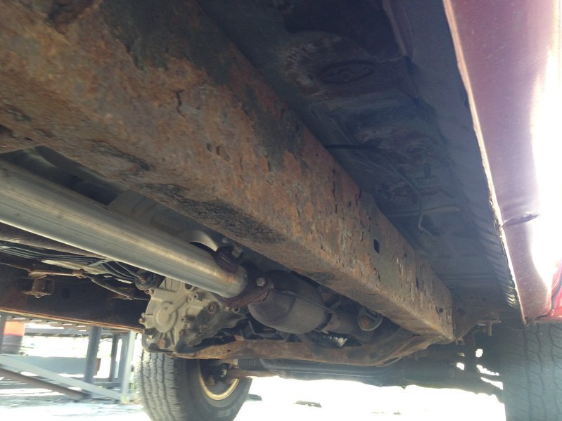

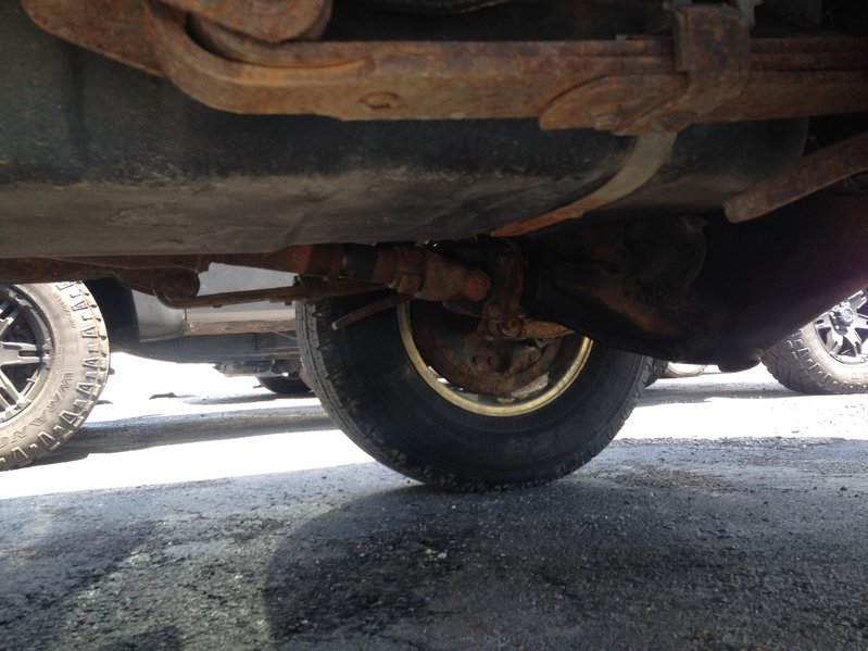

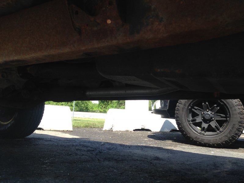

    I found another one, what do y'all think?
    https://detroit.craigslist.org/wyn/cto/6137195770.html
    Toyota owners site has very good history, including a couple frame inspections and undercoating around 2010. I also have a clean carfax. I will do the hammer test if I look at it. There is enough rust to be concerned, based on the attached pics.
    Also, this is being sold by a used car dealer, who is listing it on inventory site for $5900, but on CL for $4900. Go figure.... They were nice enough to send pictures of its frame (attached).

    Personally I would pass. The frames rust from the inside out so chances are it looks worse inside the frame. Granted most of that is advanced surface rust but it's on its way to be an issue in the future. It also appears that the floor boards are getting some rust spots. Car fax may be clean but it looks like it got a repaint on the front fenders and hood. Appears a darker maroon color on the front fenders and hood from the following pictures on the ad. Description says it comes with spare front end parts as well. They may have never reported an accident and did repairs and paint themselves or by a family friend. I had a previous Tacoma with a clean car fax but was hit in the rear and resprayed on the truck bed. Just noticed the super low price. Maybe something else is wrong with it or maybe a good deal for someone. :notsure: Those Limited bucket seats though :drool:

    The first thing I noticed too was that the red color seems a little mismatched. Rust galore under the other one everywhere as well. I'd pass on the used car dealer one.
    The Craigslist one might be worth checking out in person but check underneath. If it looks better than the red one and the other one in the previous thread, then you might see if they'll take $2,500-$3000. Where I live, beater cars that have crappy exterior paint go for $3,000. Use this as a reference. The under $5,000 used car market can be interesting.

    As an '03 with undercoating the frame is still under warranty (depending on the in service date-maybe not for much longer though). It should be inspected and assessed by Toyota before anyone buys it. Actually, my frame is in about the same condition and has checked out OK the last three years.
    However, the front end question needs answering. This one needs more investigation.
    Edit: either the hood is popped in those pictures or there is something amiss with the alignment.

    Wow, I'd buy that for $1,000 for that much rust. Otherwise I'd pass.
    The fact that even the spare tire has rust tells me it's no bueno!!!

    The first place to check is where the leaf springs attach to the frame, right behind the cab, as it is usually the first place where these frames start to rot.
    Also, by the gas tank and the catalytic converter, as they are a commonly rotten spot on good looking but rotten frames
    As said before, these frames rot from the inside out, so try to poke a finger or something into the square holes on the frame rails to see how much rust chunks and flakes there is in there. If it's full, probably not a good sign, but it's the hammer test that is really going to tell you if the frame is good or not
    Also, the front end, take a good look at it, pop the hood and look for anything indicating a possible repair due to a crash. Anything that is misaligned should be a red flag for you.
    if it ends up it is all good and you buy it, remove as much loose rust as possible on the frame and have it greased, as it will stop the rust from progressing and worsening

    No way, especially for that price. That frame is scaling away.
