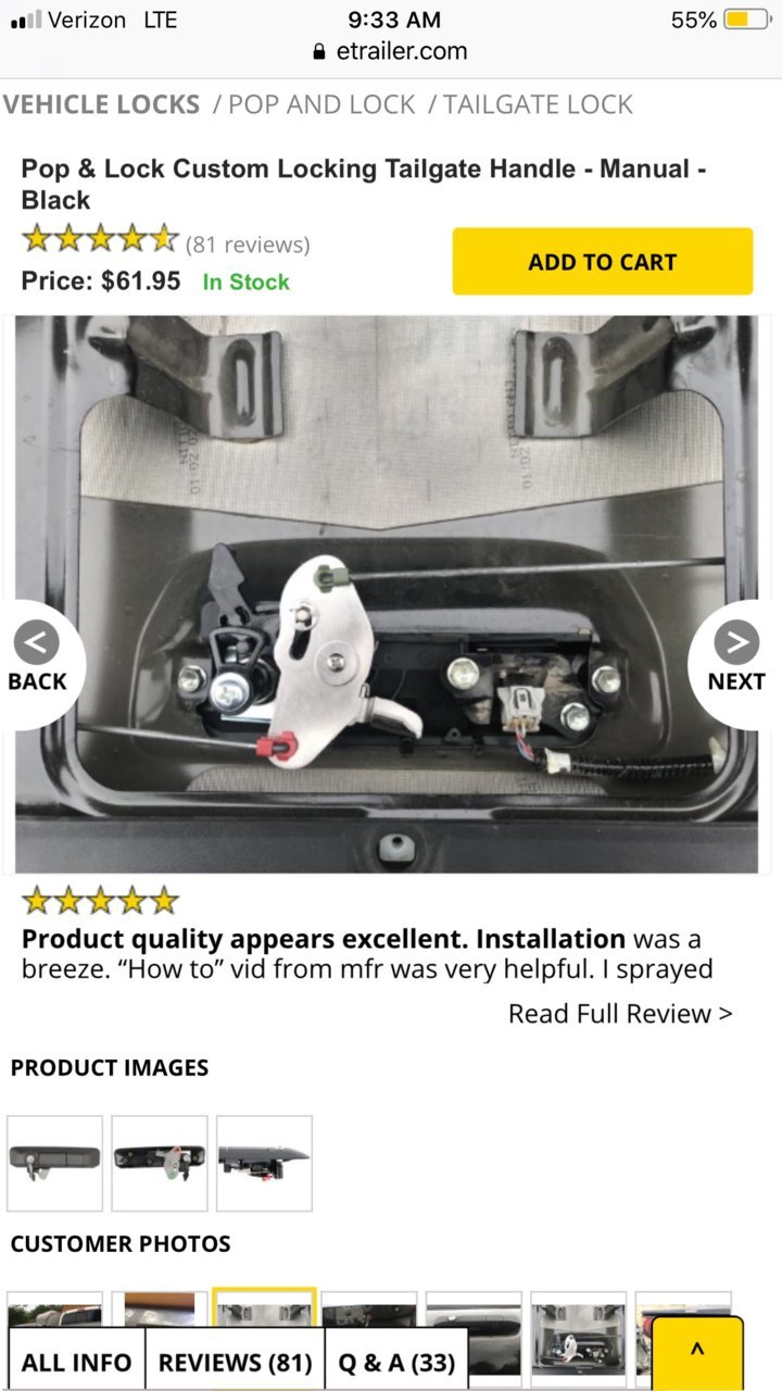

    You do not need to have a Pop-N-Lock Handle already. It depends on how you plan for your install. If you would like this Kit to be 100% Plug-N-Play like the 3rd Gen Kit, then you will need to convert to a Kit similar to the one below:
    https://www.etrailer.com/Vehicle-Lo...MIpKy-6vr_4wIViAOGCh1KbAIMEAQYASABEgImEfD_BwE

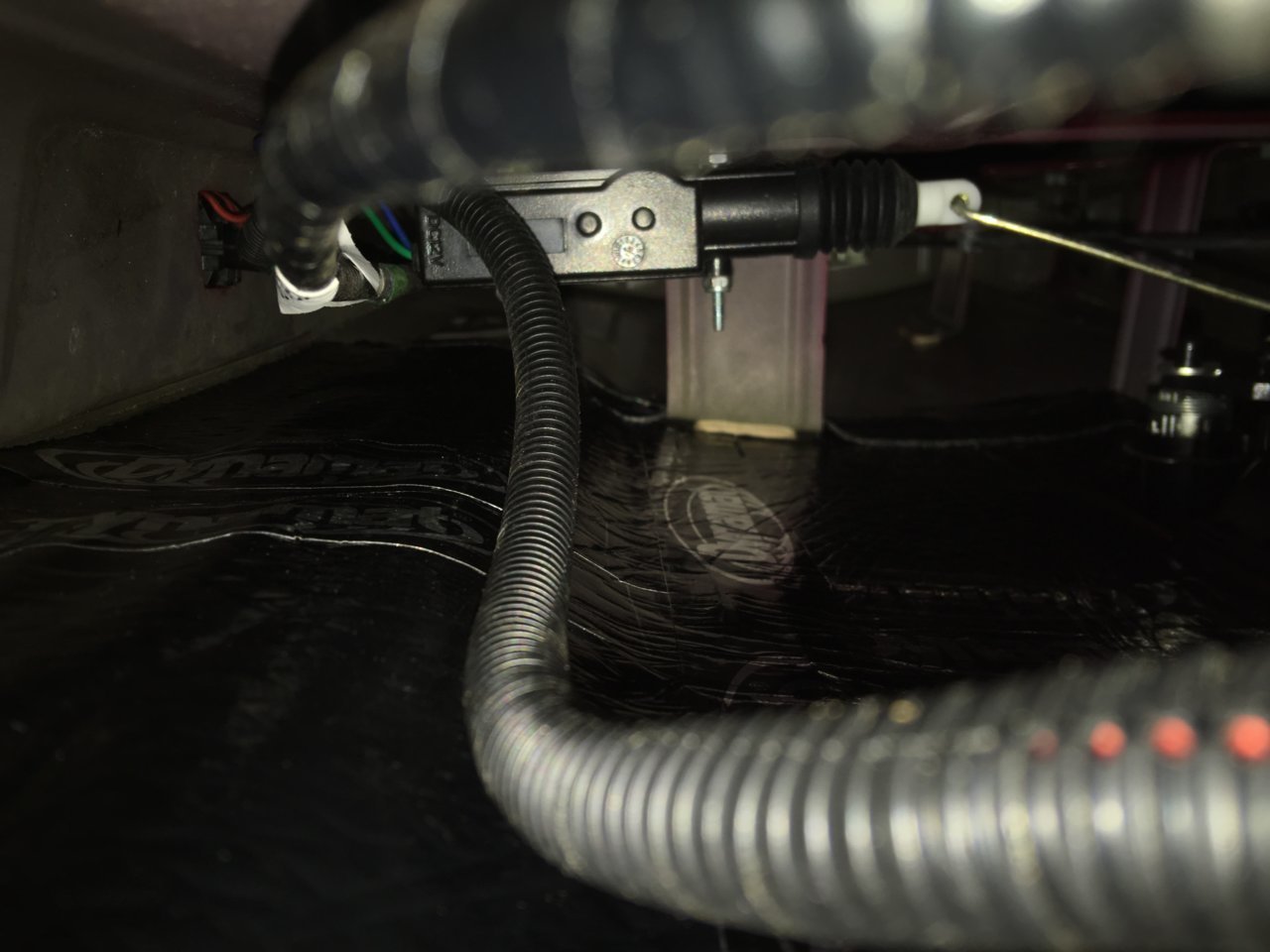

    If it is not that important to you for it to be 100% PNP, then you can do it how I originally installed mine on my truck by drilling two holes in your tailgate for mounting the actuator directly to your tailgate instead.
    This is a look from underneath at my actuator and how I mounted with screws, washers and locknuts. However, on the 3rd Gen thread, we started out like this and there were some very good install tips and some links with some washers that some members used that if I did it this way again I would use to level out the actuator rod. If you are interested in this install, I would also suggest you purchase my TAILGATE ROD for the Actuator as you will love it and it will be so much easier to install instead of this Rod in this picture.

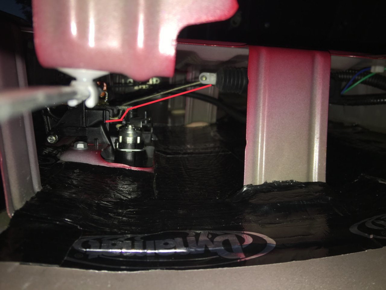

    Here is a look at the angle of the Rod.
    Lastly, if you purchase the TAILGATE ROD it would prevent you from having to drill a hole in order to install the Rod in the picture.
