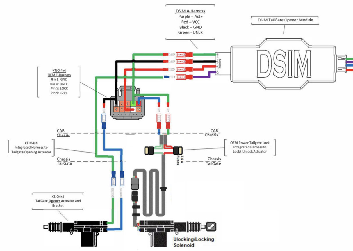

    Definitely can make this happen if this is what it looks like. Although it would be slightly different than this...
    You would substitute the KTJO Lock-Unlock for the OEM. Therefore, it would be like I mentioned on my thread:
    1) First, you would purchase the Add-On Kit off my website www.ktjo4x4.com mentioning in the comment section that you have the OEM Tailgate Lock Kit. Therefore, you would get my KTJO OEM PNP Harness that would give you the needed connections in order to hookup the KTJO/DSIM Opener Mod.
    2) You would plug that into your Passenger Side Kick Panel Area. Then you would plug your OEM Kit PNP Harness into mine or vice versa. As long as the OEM Kit PNP Harness is just straight wires and nothing is crazy with their harness like wires switching And crossing paths, you could plug mine into theirs and it wouldn’t matter.
    3) You wouldn’t mess with your Tailgate Lock-Unlock Connections at all. You’d leave them connected to your OEM PNP Harness howeverToyota has them connected. What would be different with your Kit is that I would send you my Tailgate Lock Integrated Harness which is only Two Wires instead of sending you the Tailgate Opener Integrated Harness which is Four Wires. With you already having the Lock-Unlock hooked up to the other PNP Harness, we are only needing to connect the Opener side Actuator with the Blue and Green Wire that you see in this diagram here.

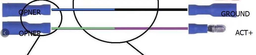

    4) This step would be to connect the wires. So you would take your Opener Actuator from the Add-On Kit you purchased from me, and connect the Green Wire to the Purple Wire on the Tailgate Opener Module V2 and the Blue Wire to the Black Wire on the KTJO OEM PNP Harness. Now if I get enough of you interested in the Tailgate Opener, I’d rather just make a Custom PNP Wire Harness like I have for the Opener Integrated Harness and change out the Wire Color half way to help you guys out which I might do anyways tbh so there’s no confusion. It would be kind of like this to give you an idea from the Opener Harness
    5) The final step would be for you to connect the last three wires from the KTJO PNP Harness directly time the Tailgate Opener Module V2. So you have Red goes to Red, Black goes to Black, and Green goes to Green. You would technically have two wires remaining on my PNP Harness due to the fact that you wouldn’t be using the Green and Blue wire for the Tailgate Lock. (Don’t worry, you could always use those for another mod that will be released ;))
    THE END
    So that’s how you would convert it to make the Opener work with the OEM Tailgate Lock Kit. :thumbsup:

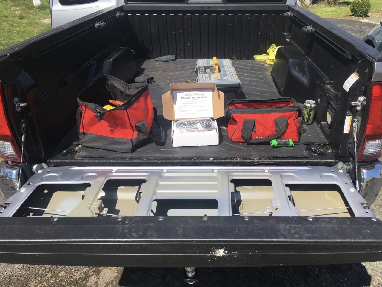

    7C6D6CF6-9B5B-4B4F-92E0-7D4105D52A0F.jpg Installed mine today! Remote Lock only.
    Thanks @KTJO 4x4 Works great. Now I just need the cap.
