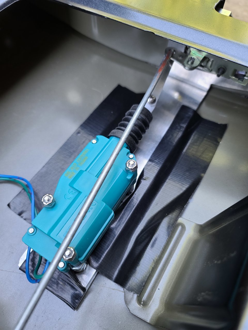

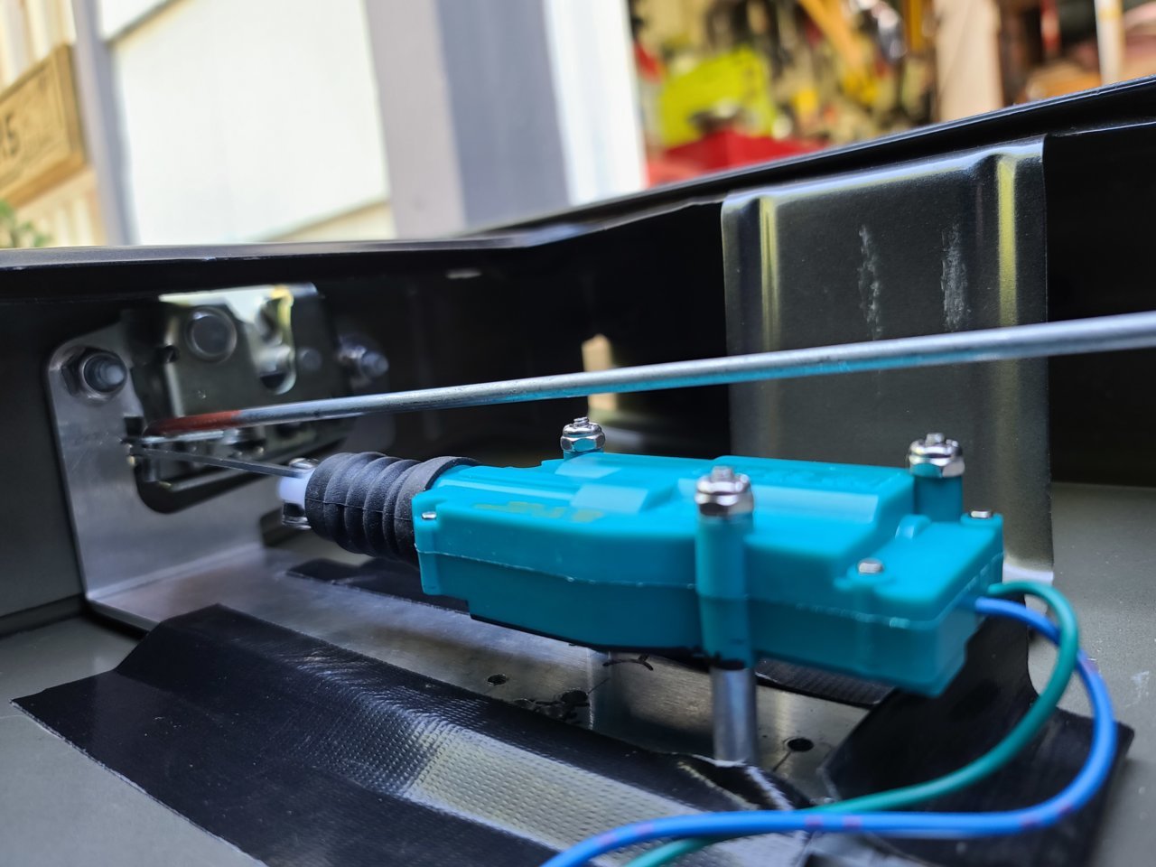

    I was able to tinker some more tonight, tried repositioning the actuator on the bracket by drilling holes for a couple of different positions, and that was a fail. Put a multimeter on the DCIM module red wire and it was getting the full 12v, but at the gate consistently only around 7, so looks like a low voltage issue. Next thing I'm going to try is running a jumper with my own wire from module to gate outside the vehicle, bypassing the loom altogether. If that works, then my guess would be the culprit is possibly a bad wire in the loom.

    Well I'm striking out. After disconnecting wires, cutting off the original bullet connectors and crimping new ones, I am at least getting 12v now thru the whole wire to the actuator. It STILL refuses to drop the gate. I've removed rubber bumpers, repositioned the bedside catches, etc. I did run my bypass wire just to satisfy my curiosity, but with the same result. Proper voltage, noise in the gate, no action. The gentlest of lifts on the tailgate handle disengages and drops the gate, but I have no idea what else to adjust. Somebody smarter than me will have to advise now.

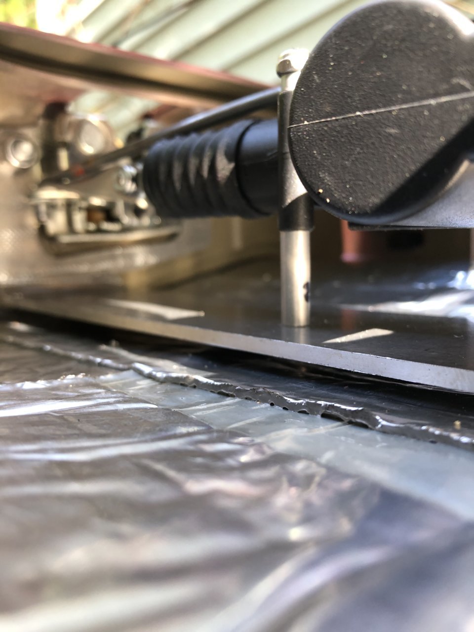

    FINALLY success! The new actuator proved to be the solution, altho first test failed because I had the bedside catches adjusted all the way to the back and the latch wouldn't release. Loosened them and slid slightly forward (toward the gate) and retested and it worked. Works with the fob and works with the button on the dash. See below for the link from Amazon if it'll carry over. If the link doesn't work, just search actuators and look for the blue one like in these attached photos. You'll notice my momentary switch is different, as my factory configuration on this 2020 Limited did not have an available blank for the small switch KTJO supplied, tho there IS a large one which I will likely use for a bar light in the lower grill at some point. I would have had to buy one of Meso's templates to get the arrangement I need, so this factory one may get tossed at some point anyway. For now I'm digging the low profile button, I bought another one that is black with a lighted blue ring that I may try next if this one wears out.
